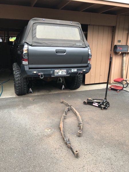

    I had a little time, so i threw the All Pro standard leaf pack on the truck. Sits a little higher, but I didn't take measurements. Just wanted to put them on the truck so I can set the front ride height, and to get them out of the damn way...
    Stock 2 leaf pack with ICON 3 leaf mini AAL pack came out.

    Did you reuse your overload spring?

    No, i threw those away long ago.

    Ok. I need to ask some stupid questions? Will the overload keep the springs from fully extending?

    No, just keep them from negative arching, but the AP pack has so many small leafs at the bottom, the overload would only act as a spacer. Your bump stops should be set up properly to prevent too much negative arch anyway.

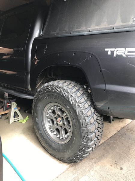

    Thinking about pushing it to the nearest mall with a Starbucks :rofl:
    After I put the AP standard leaf pack in, I put on the 37s and adjusted the front ride height so she sits pretty level. Belly height is 20" and will probably settle a little.

    She's so beautiful :thumbsup:

    does turning tires to black wall out count? How bout added snug top rebel.
    Looks incredible!!
