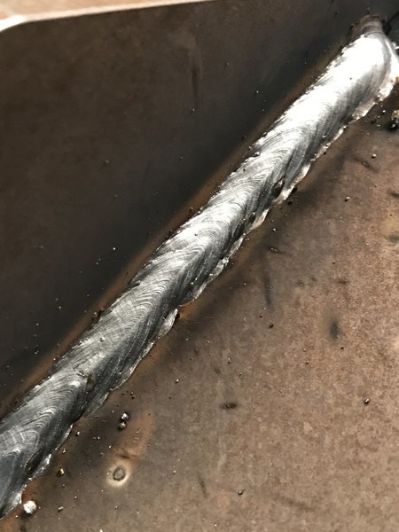

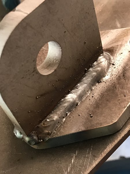

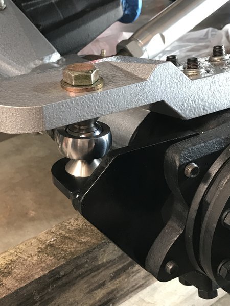

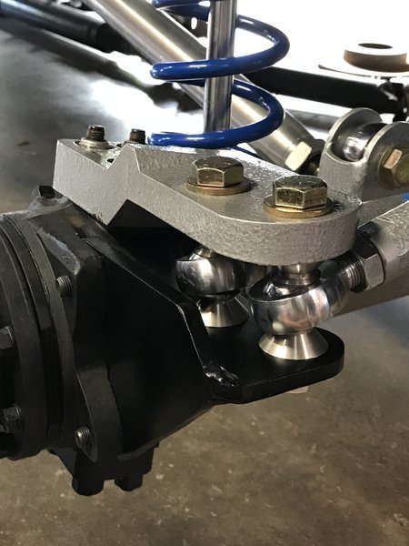

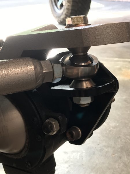

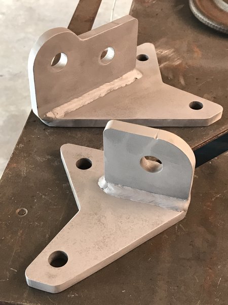

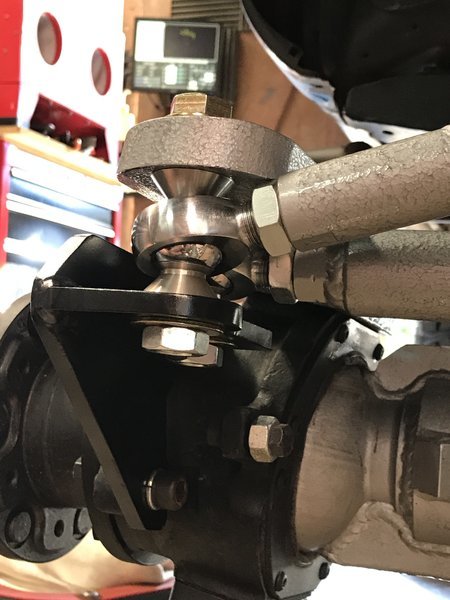

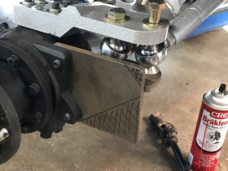

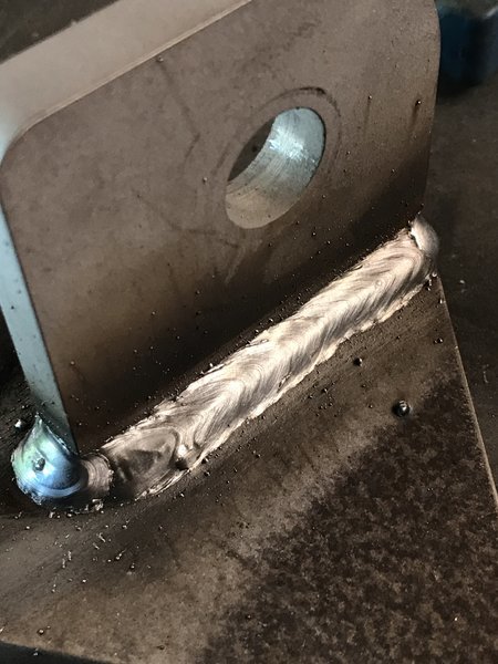

    So the plates are done, and again, these are more for peace of mind. The Front Range off road keyed steering arms are super beefy and I'm not worried about them. This was more just to look safer for recon inspection and brace the end of the heim bolt a little. But it's done and I'm happy with it.
    Steering arm is keyed onto the knuckle.
    I can put down a decent bead on the fab table. Under the truck is a different story :laughing:
    Sandblasted
    And what it looked like before:
    I'd say it's an improvement ;)
