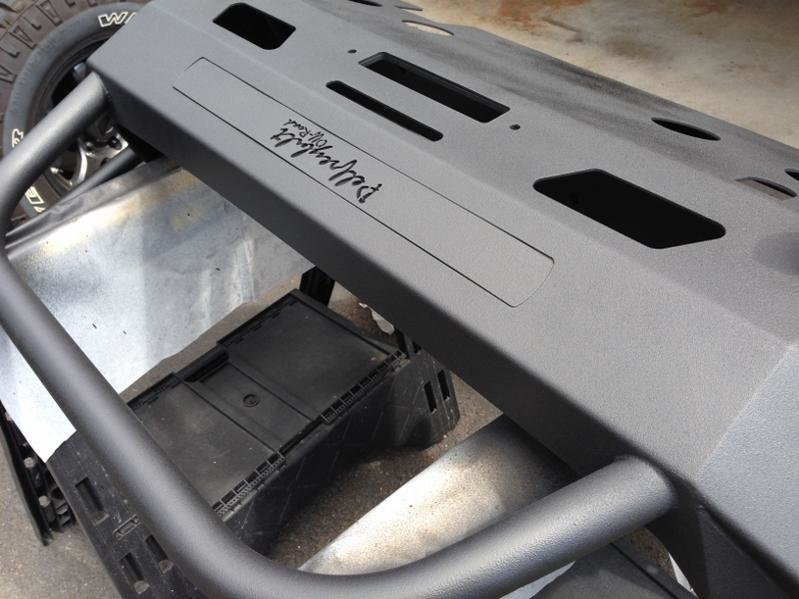

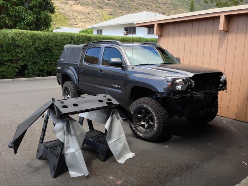

    Front bumper is off again so I could spray my bumper with duplicolor bedliner. The price quote for s/b powder coat was too high. Looks pretty good! I've used this stuff on my Monster Mule project on the floor of the cab and really liked it. Takes forever to dry tho. I gotta touch up some spots that was still a little soft and got marred by my straps when putting it back on.

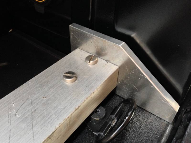

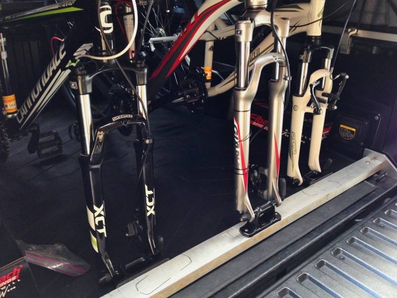

    Since my bicycle fork mounts will not work with the softopper, I made this...
    The mounts are staggered so the handle bars don't hit each other. 29er in the center.
    Everything squared off and spaced on a milling machine for squareness
    The slotted screws are just temporary. I'll have some nice socket cap screws soon.
    Gonna wrap the sides and bottom of the feet with rubber.
    Much easier this way since the fork clamps are right at the tailgate instead of behind the cab. The center was a little hard to reach before. I can completely close the softopper, and the handle bars of the 29er just barely rubs the window. I might take the window off or wrap a towel around the bars when I need to close it up. Now I just gotta paint it up! :D

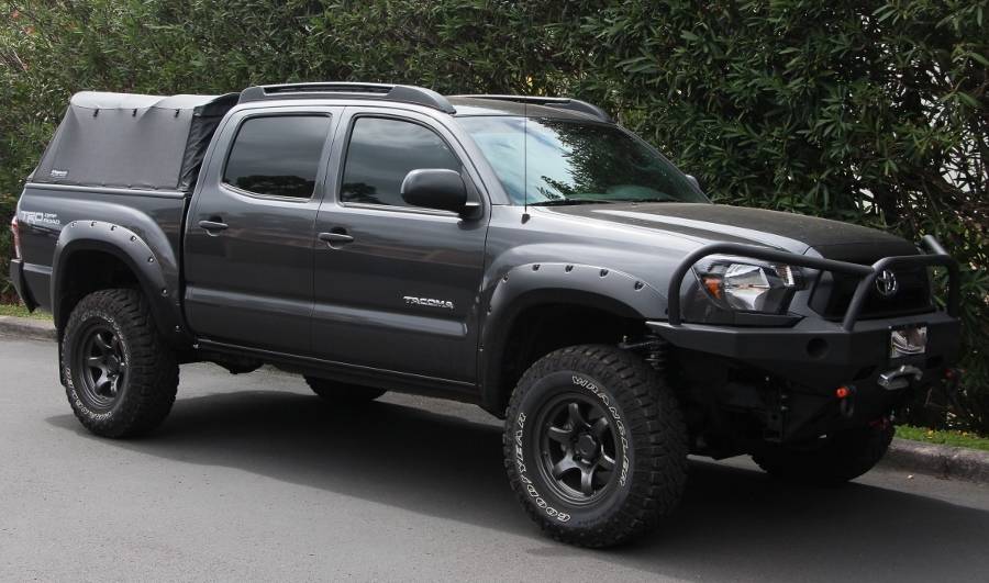

    Just snapped a bunch of current pics in my driveway, and realized I still haven't painted the bolt heads on the rear bushwackers...
    so now I'm waiting on paint to dry...
