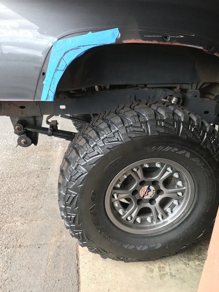

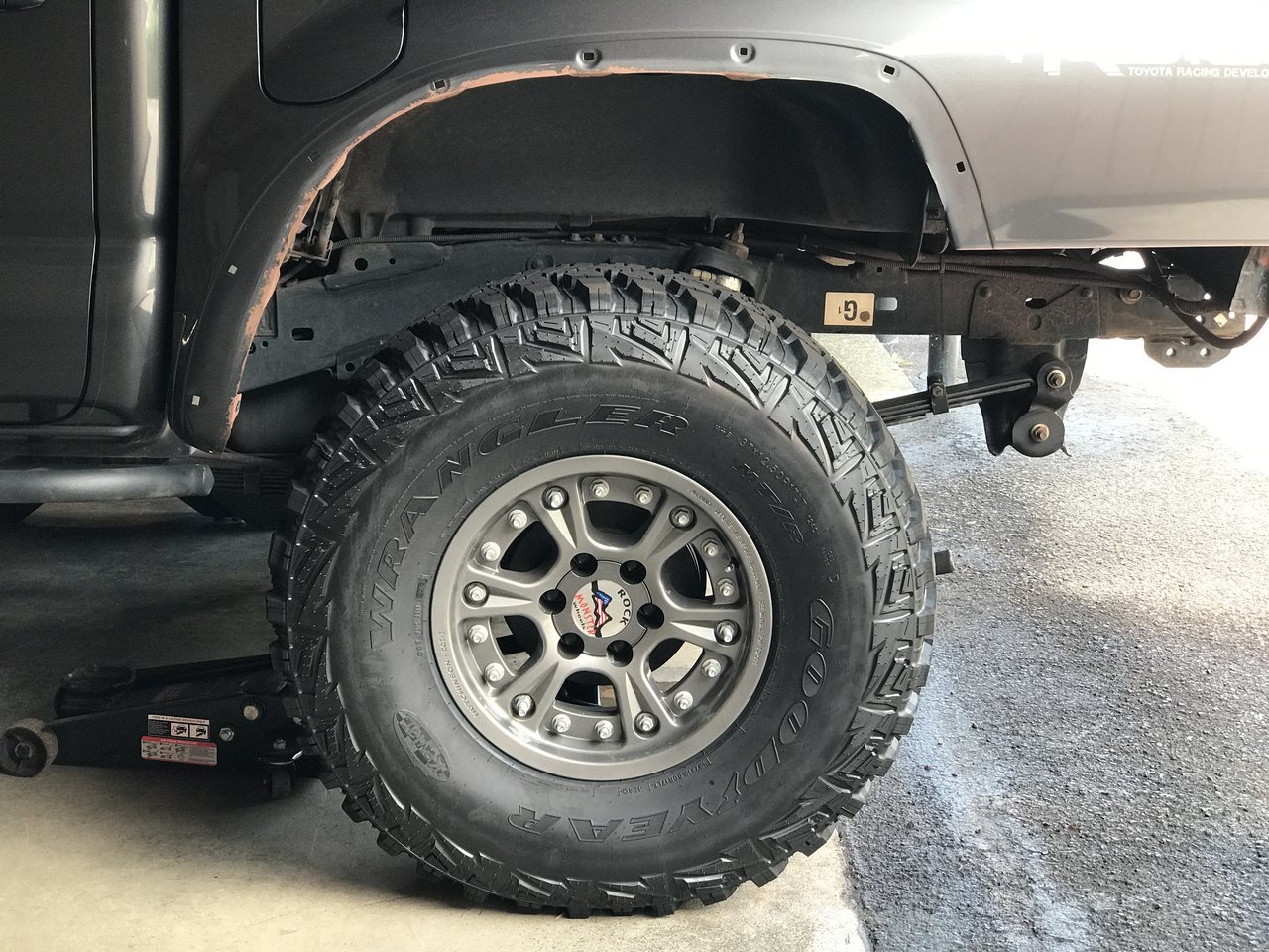

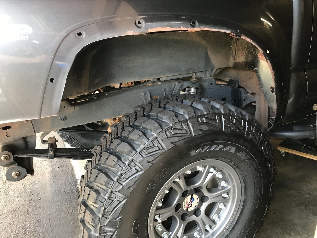

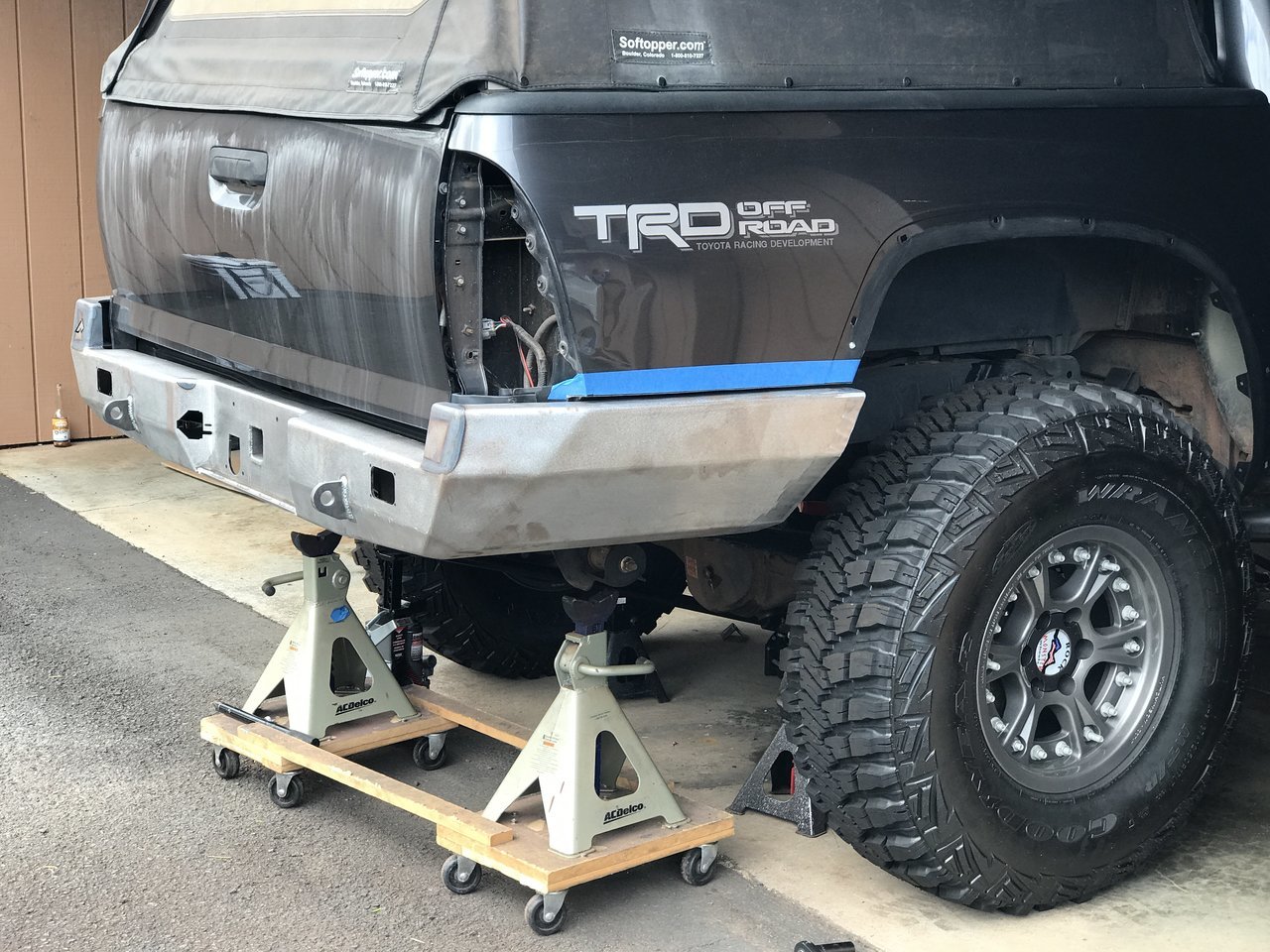

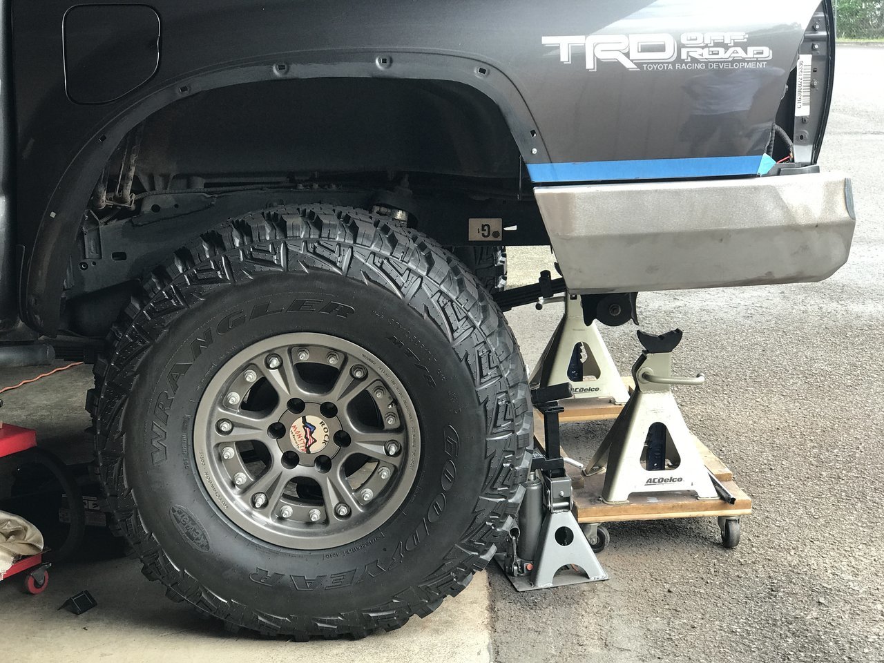

    Cut a little bit more off the rear of the fender...
    I doubt my tire will get that far in the fender, but really, is too much clearance a thing? :notsure:

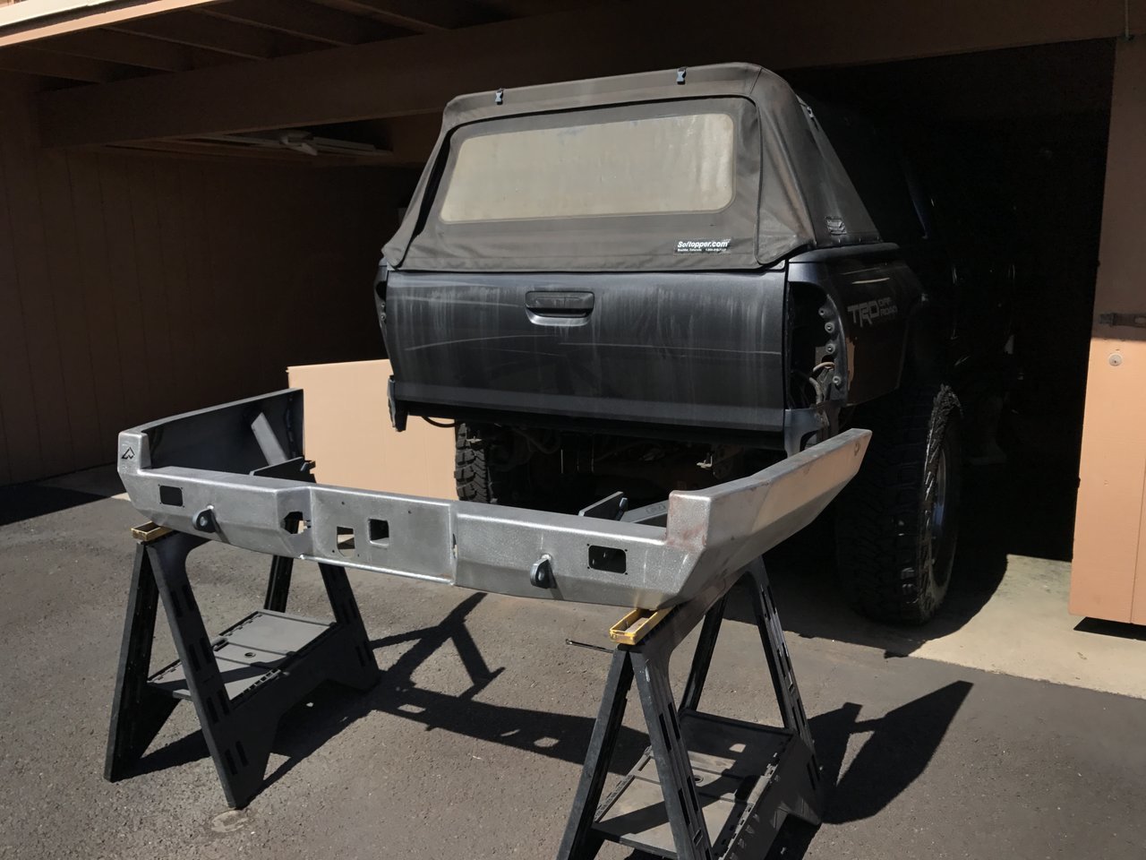

    Jesus! How many bumpers did they send me? :rofl:

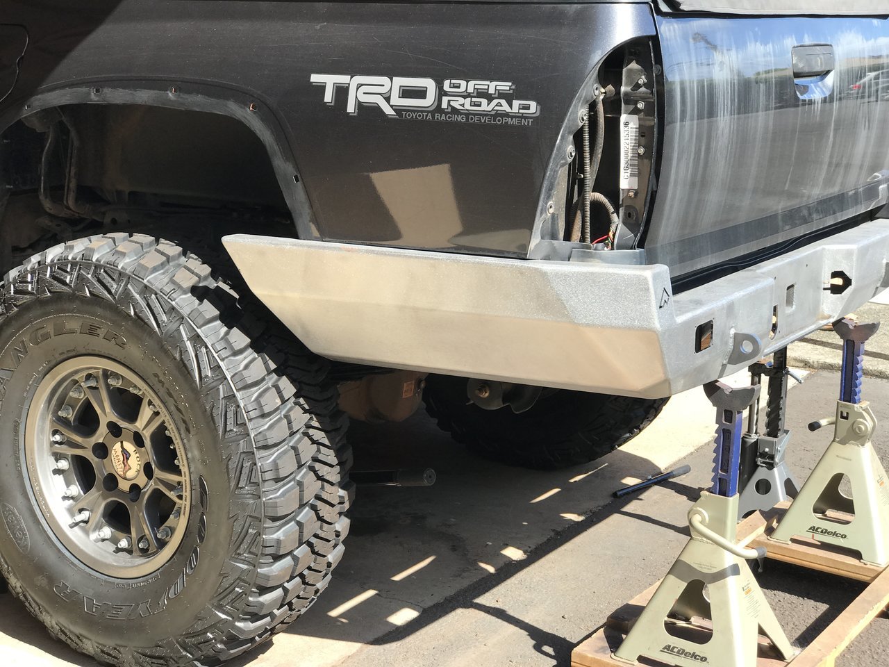

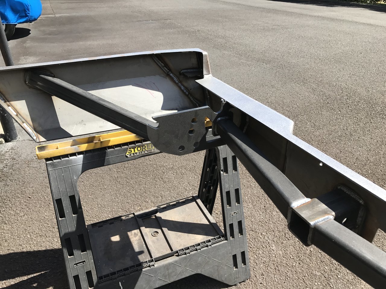

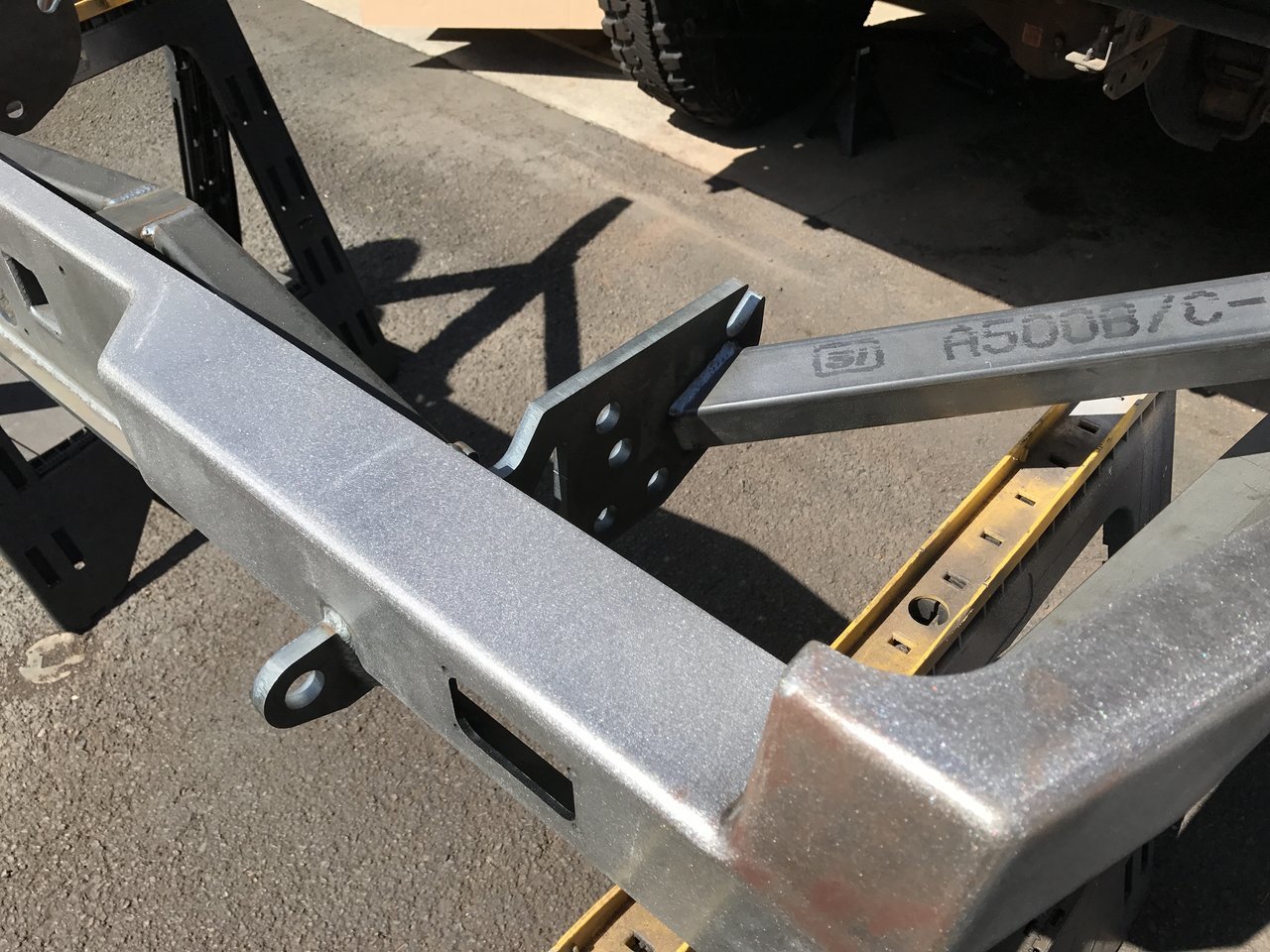

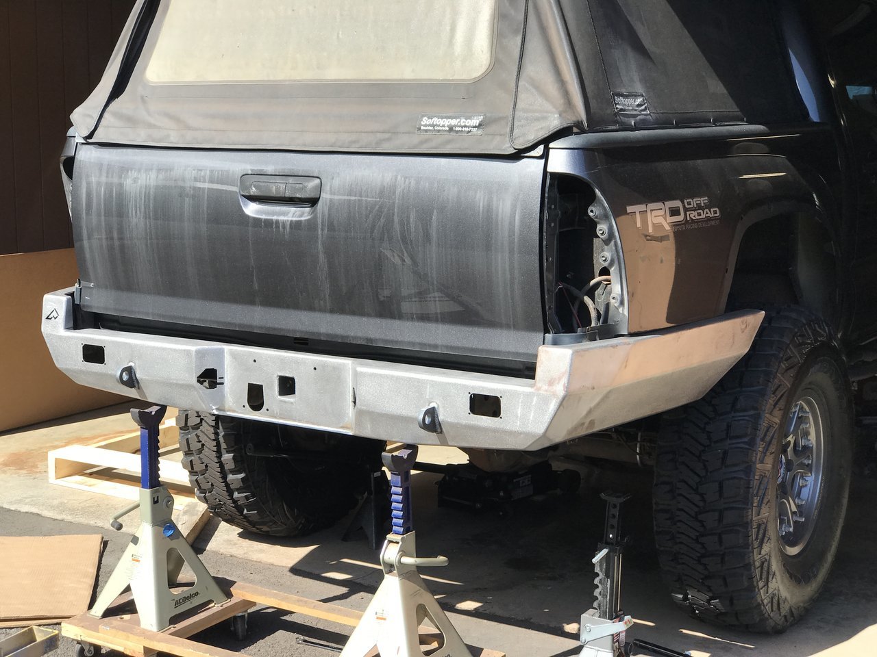

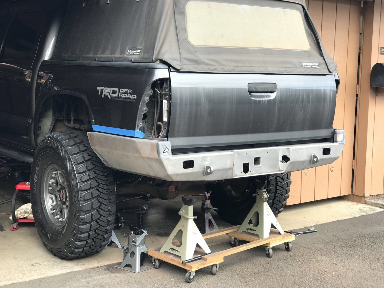

    Big thanks to @Pelfreybilt and @Socalduckslayer for getting this thing out to me so quick! It's beef as fuck! And great looking welds as always. I'm gonna feel bad cutting it up a little :D

    And yeah, I'm gonna have to trim a little off the front ;)
    It's not all the way in either. Gotta trim the bottom of the fenders a bit more. 1/2" should be enough.

    I'm digging the @Pelfreybilt High Clearance rear bumper! :oldglory:

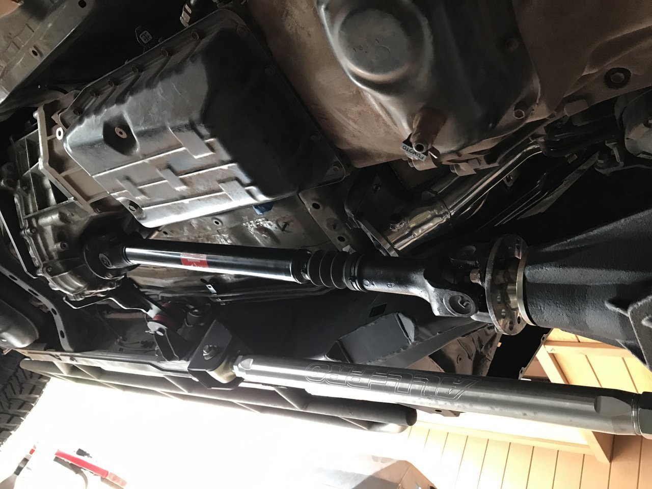

    :yay:I'm not a SASed prerunner any more!
    Big thanks to Power Train Industries Hawaii for re-tubing my front driveshaft to the proper length! Surprisingly cheap too.

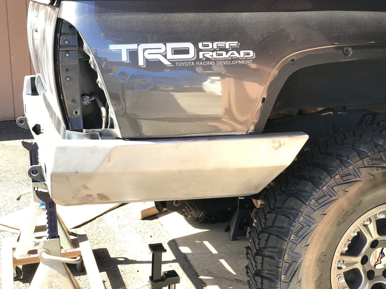

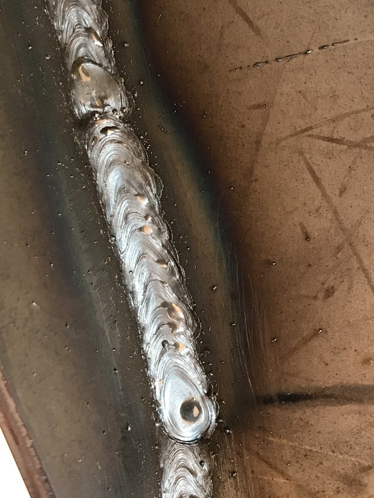

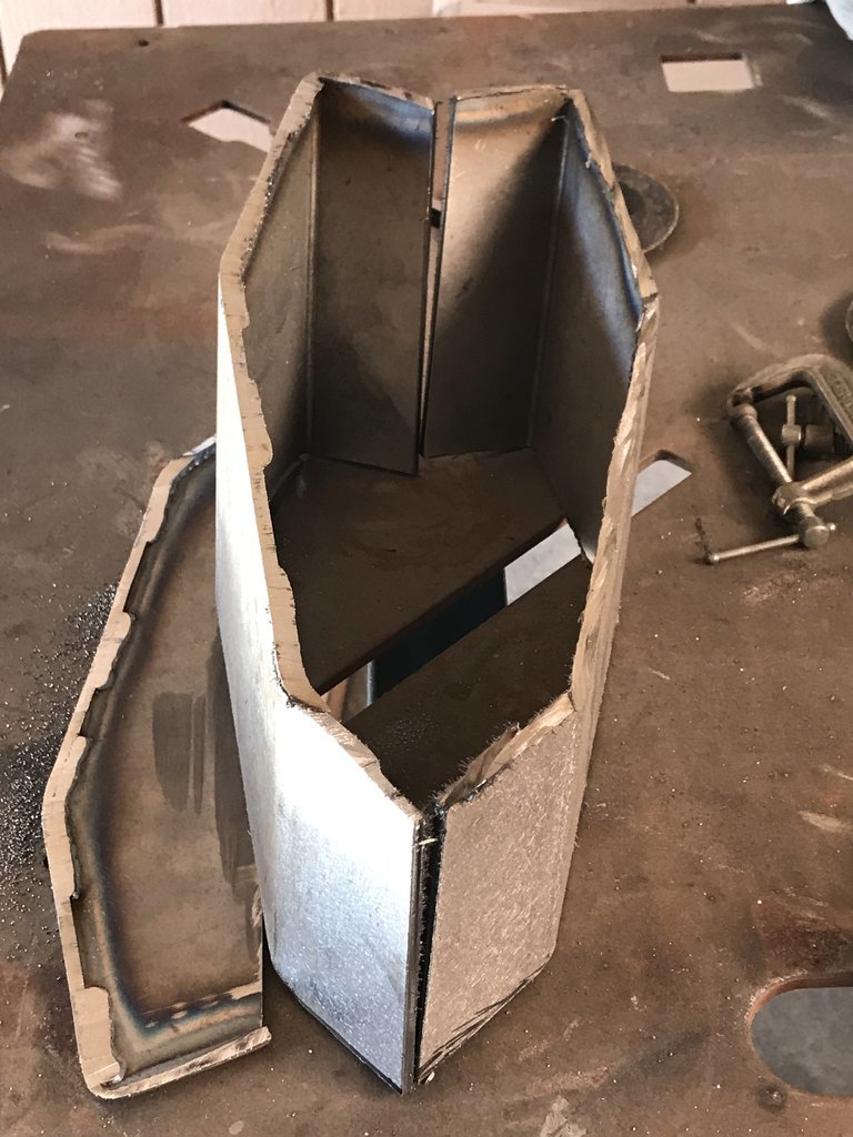

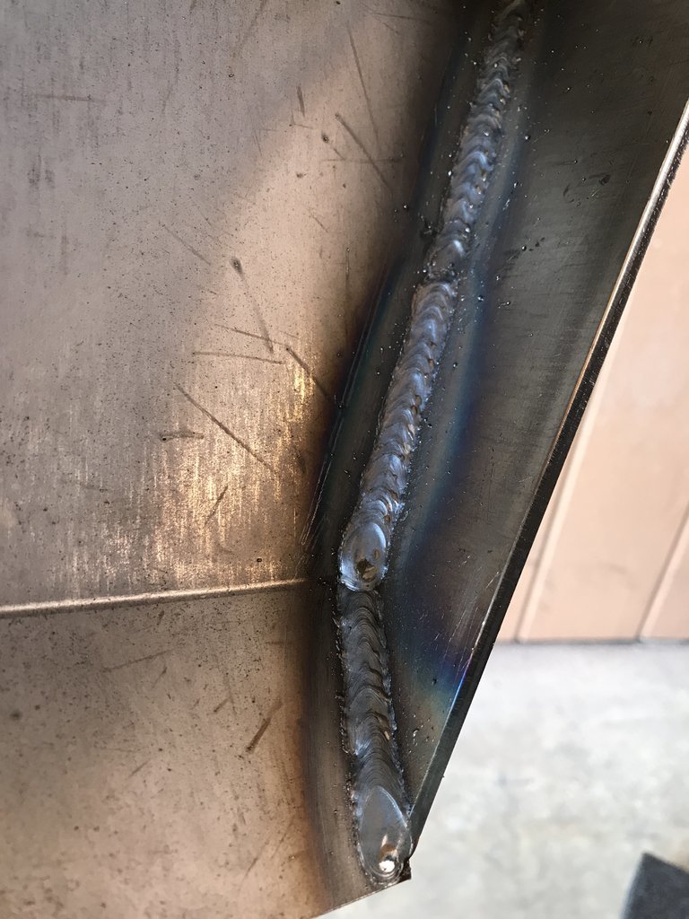

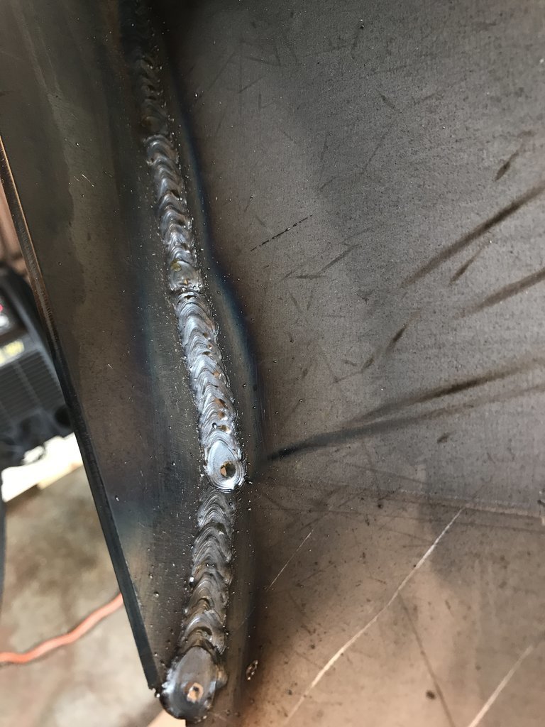

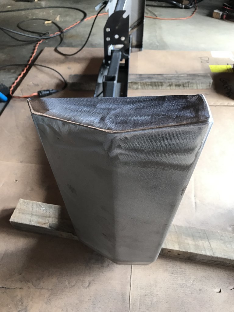

    Hopefully @Socalduckslayer approves of my chop job and welding :D
    I followed the fender line down to the bumper. It should have enough clearance.
    Chopped off! Had to reuse the plates.
    I think my welding is decent :oops:
    All smoothed out on the outer corners.
    I like the fit :)
