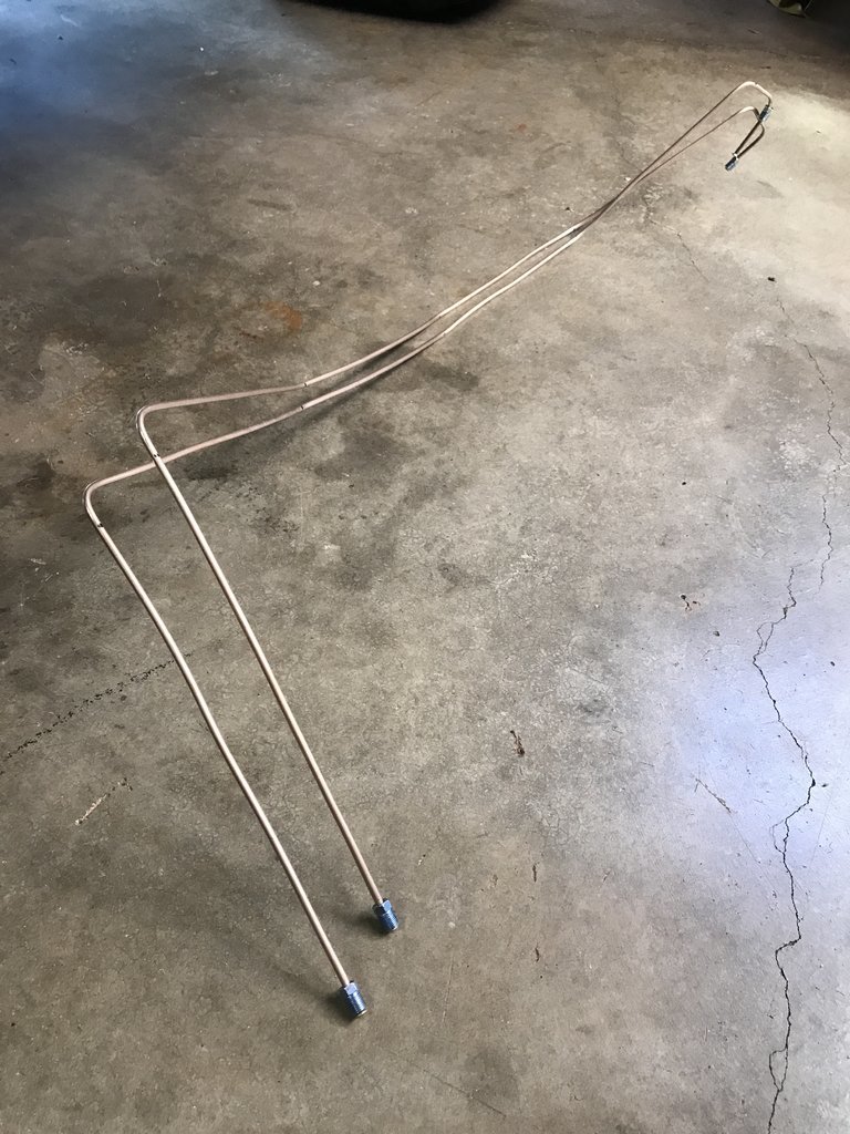

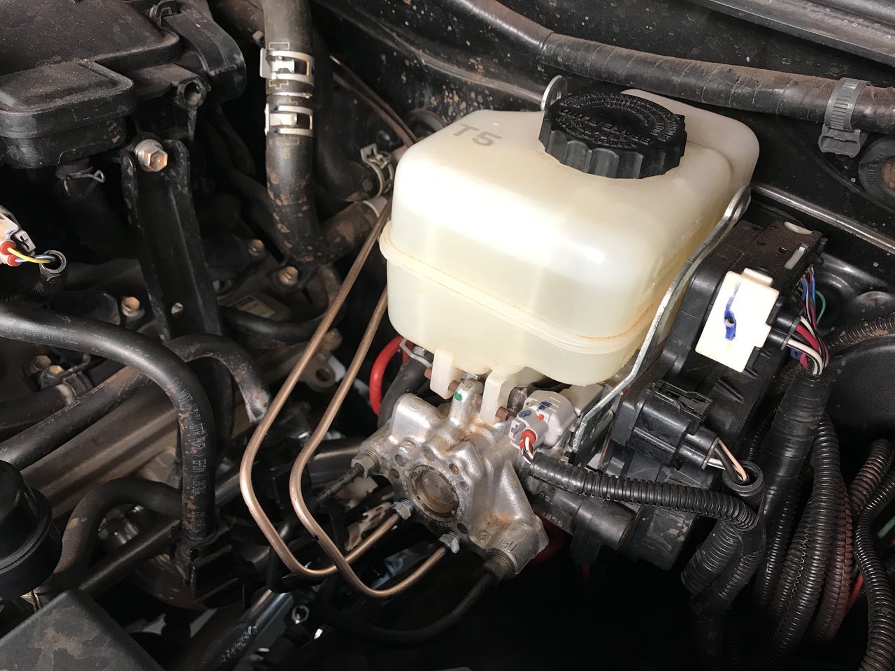

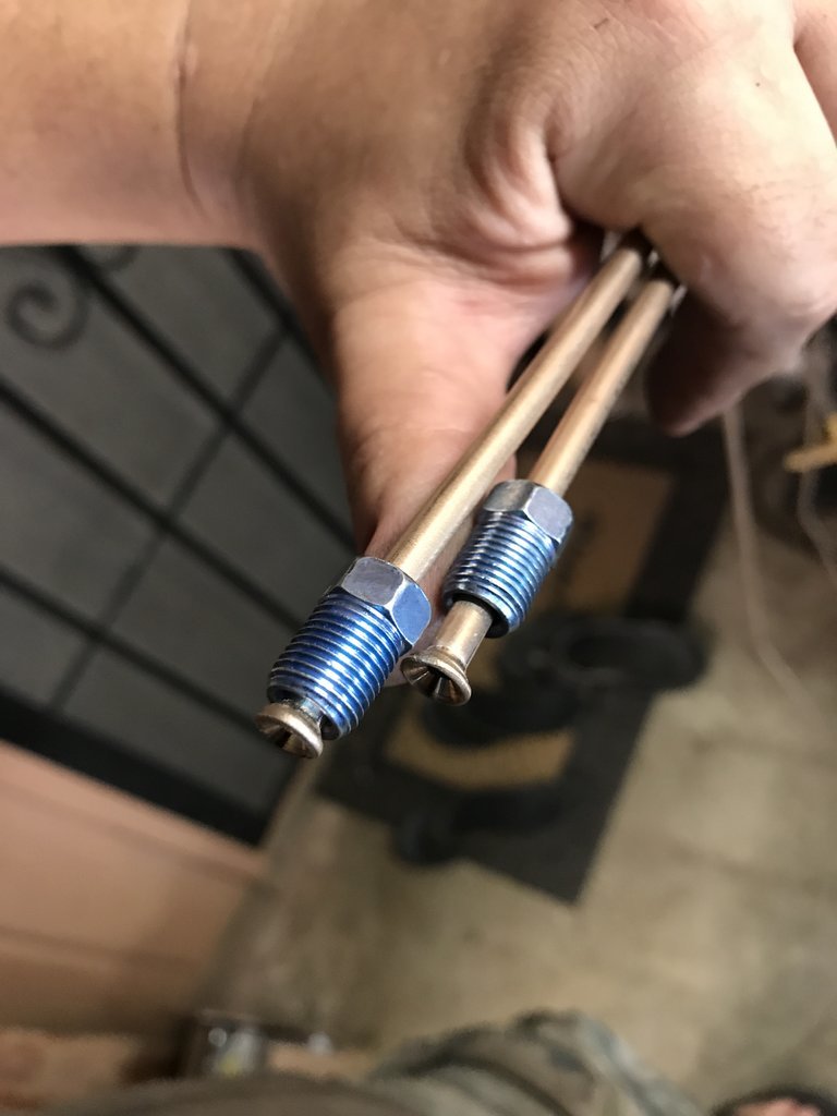

    Ran hard lines from the master cylinder down the firewall, connecting to my braided lines right above the top link. I used copper nickel lines. Easy to bend and double flare.
    Bled the system and drove around my valley. Brakes work great. They were weeping a bit, as well as the fittings on my power steering return lines. So I tightened them up and drove it around again, now no leaks or weeping. Bad news is I left my phone on the bumper and it fell off and someone ran it over :( FML...
