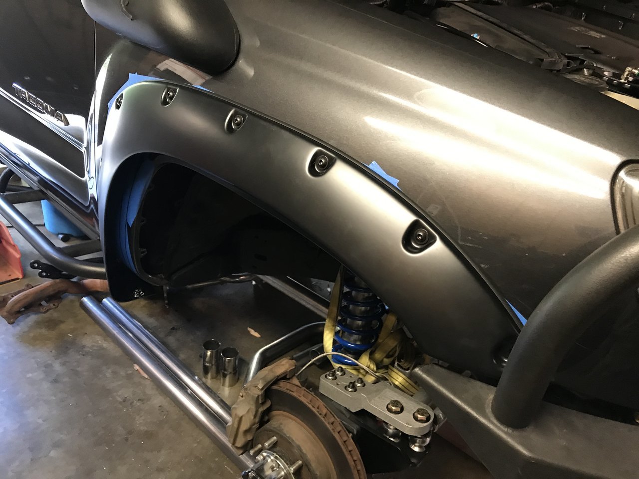

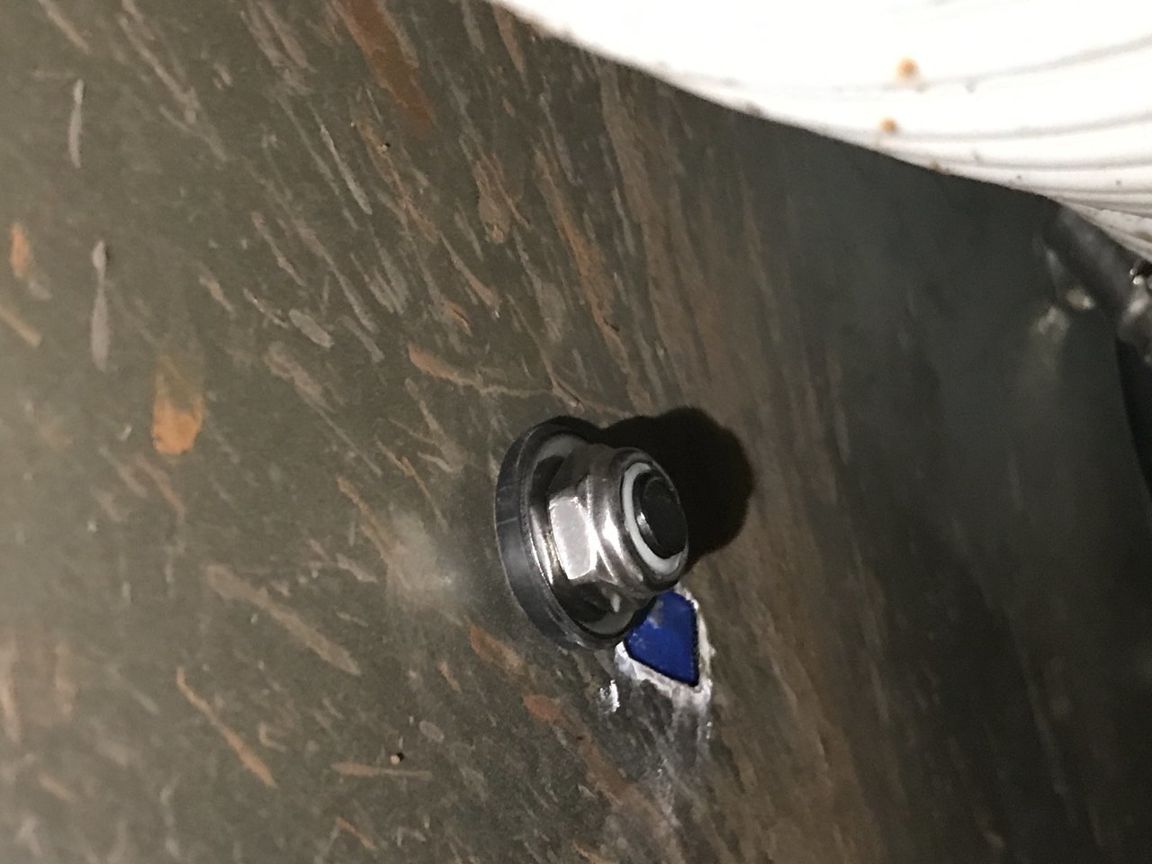

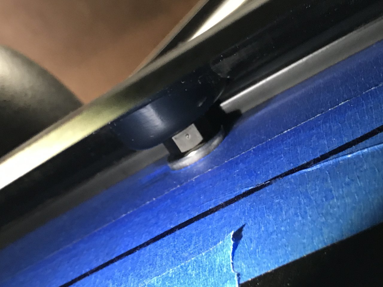

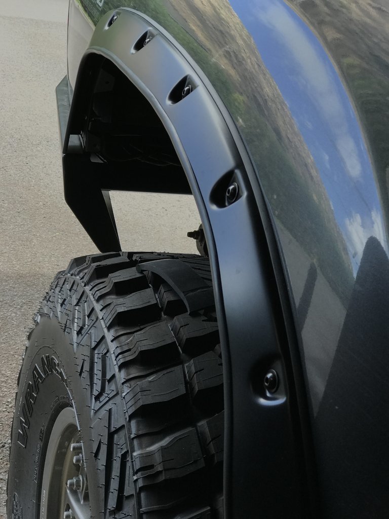

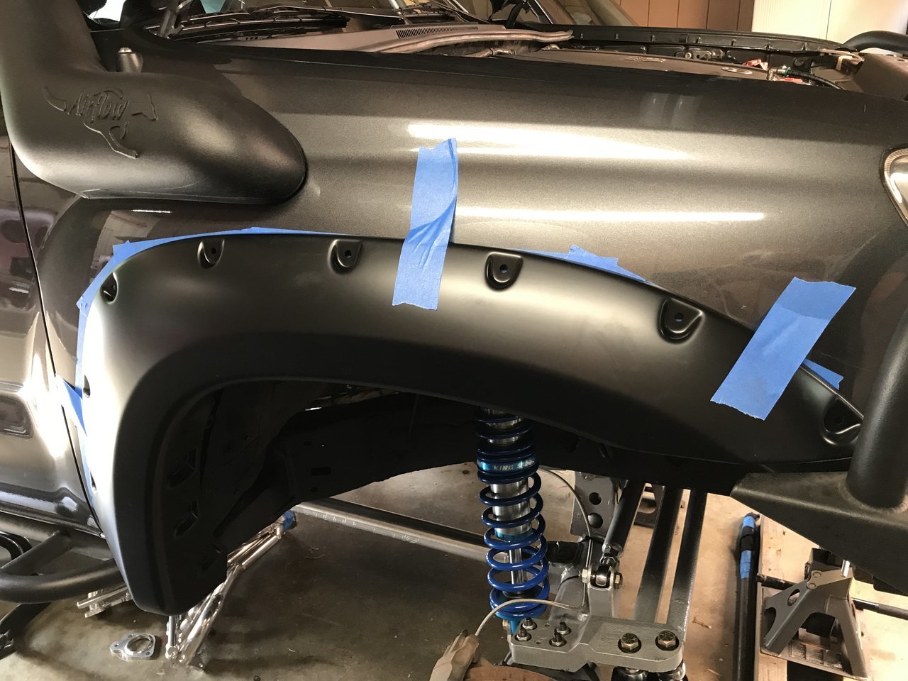

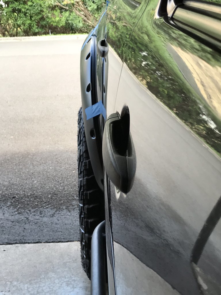

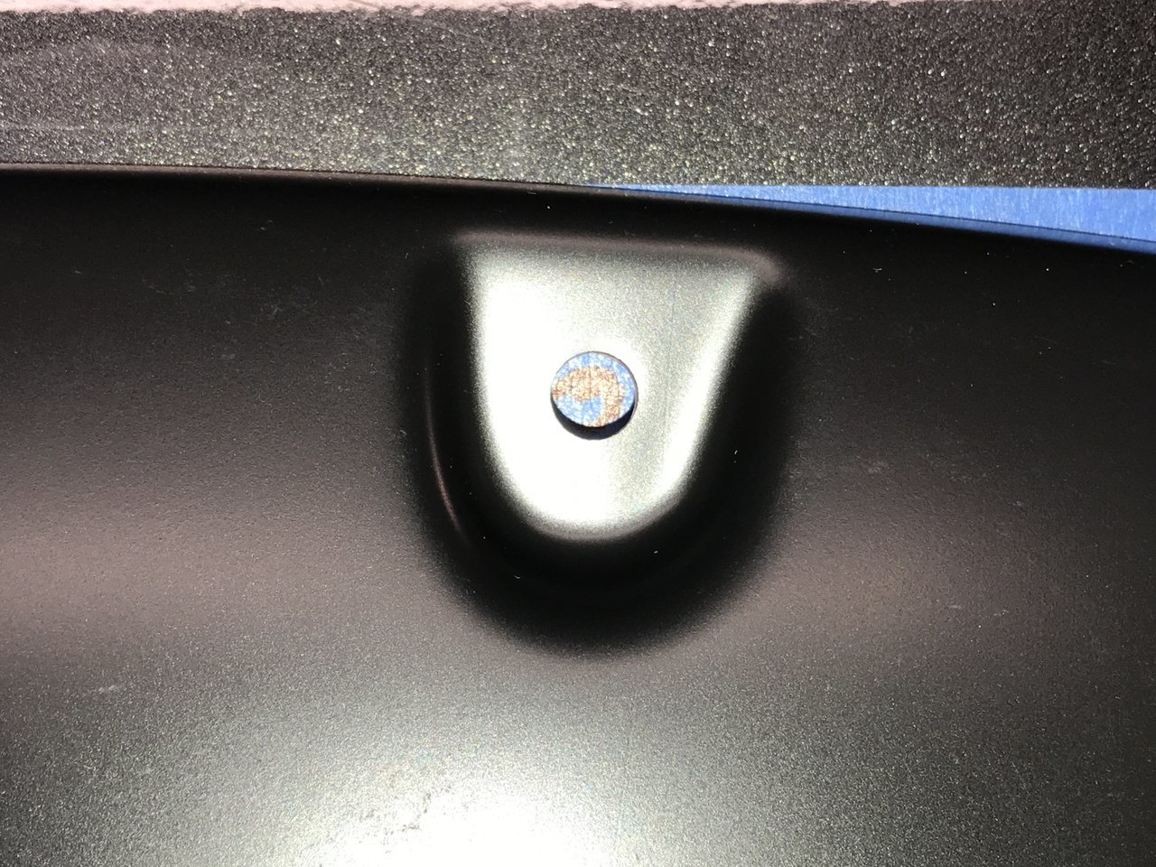

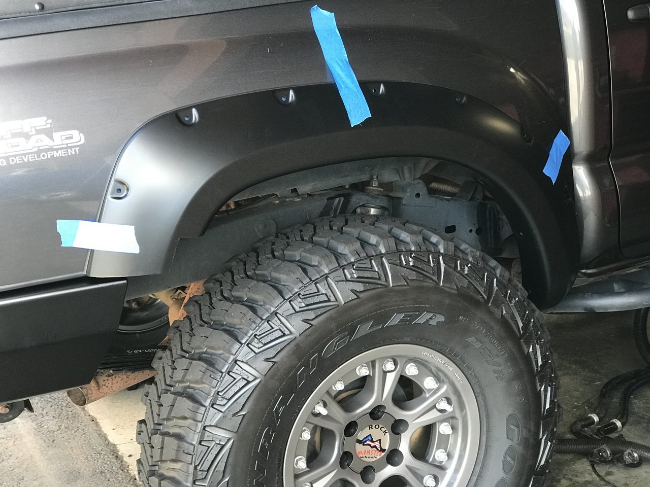

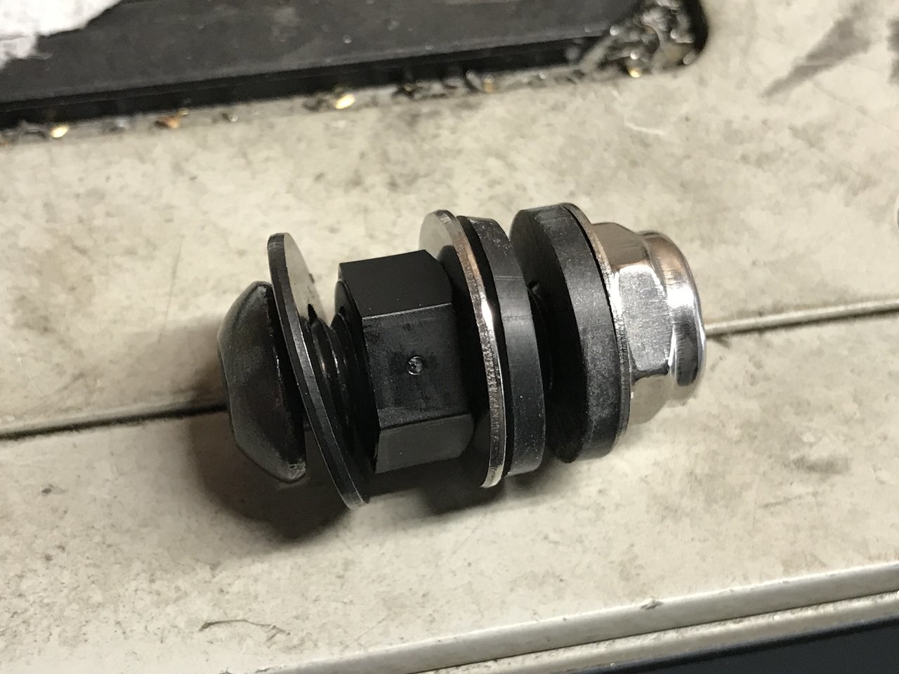

    Finally got all the hardware to bolt the bushwackers to my fenders. I haven't cut the front fenders yet since it makes it easier to line up the flare with the fenders intact. Holes are drilled and I'm just test fitting, but it bolts up nicely.
    Marking up holes.
    Bolted on.
    Black oxide stainless steel screws and washers :cool:
    Nylon nut acting as a spacer. Rubber washers squeezing on the fender to make sure it doesn't rattle or slide around.
    So here's the order: 1" black s/s socket cap screw, black s/s washer, fender flare, nylon nut, s/s washer, rubber washer, fender, rubber washer, s/s washer, s/s locknut. The locknut and last washer are taken from the bushwacker kit. Everything else is from McMaster.
    I'll still need rubber flares to cover my front tires since they stick out 6" past the fender, but the bushwackers cover the rear tire pretty well.

    Looks good..:thumbsup: Thanks for the intel on the spacer/washers...:cool: I'll be needing to acquire those shortly. Honestly, I think Bushwhacker should sell theirs with that spacer combination as an option...

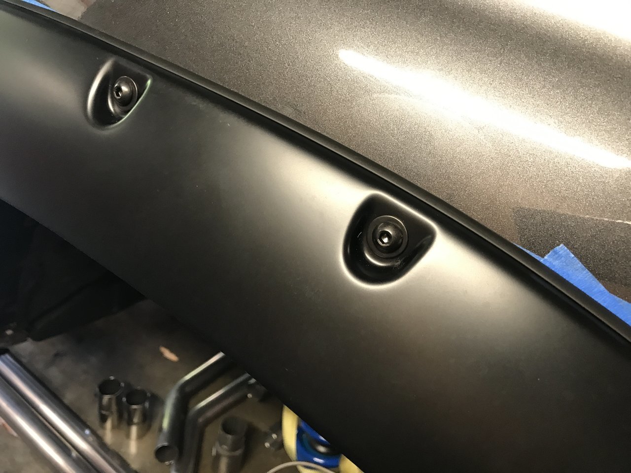

    Not much action going on... I got some rubber trim to finish the edge of the bushwackers.
