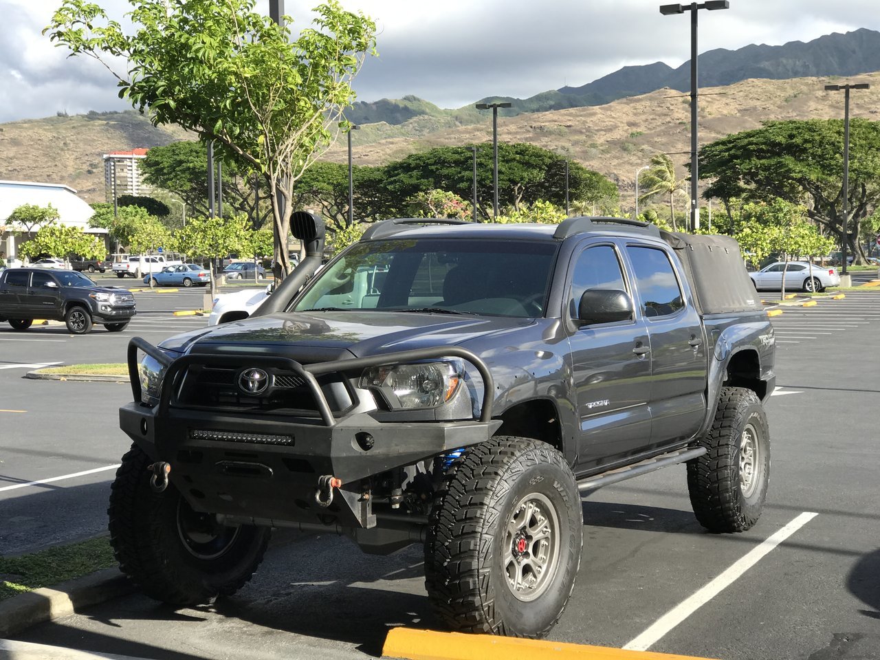

    First time going anywhere with my truck and it had to be Starbucks :cool:

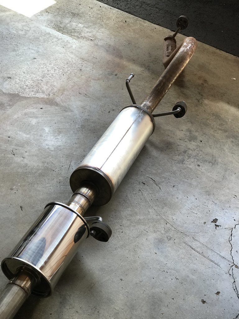

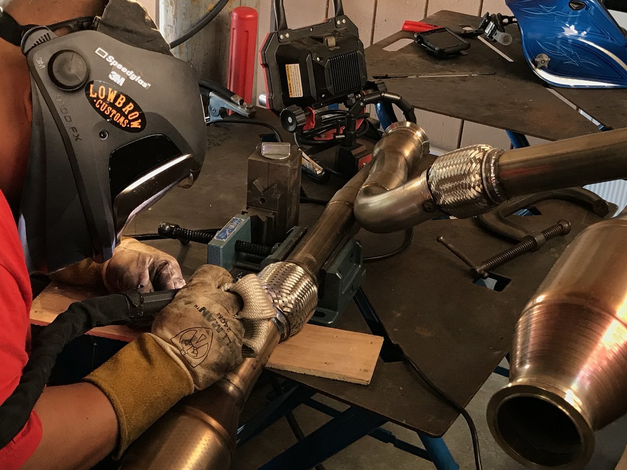

    Big thanks to Marc @wisDOMination for all the hard work fitting up and welding my exhaust system. Super happy with how it came out.
    IMG_2882.jpg IMG_2874.jpg IMG_2862.jpg IMG_2877.jpg IMG_2873.jpg IMG_2897.jpg IMG_2893.jpg IMG_2872.jpg IMG_2895.jpg
    Still need to add some more hangers and also a turboflex coupling in Y pipe. One of the V band flanges is a little off, so there is stress on it when it clamps closed. A little bit of give will keep things from cracking.
    Hit up Marc if you want some sick welding done. He also makes awesome sliders :cool:

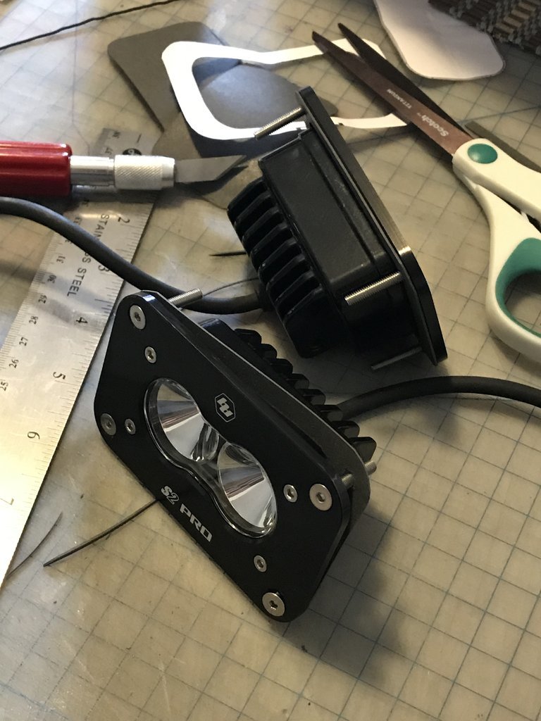

    I didn't like that the Baja Designs S2 pro reverse lights didn't come with a gasket of some kind, so I made my own out of thin rubber.
    Now I can finally mount them.

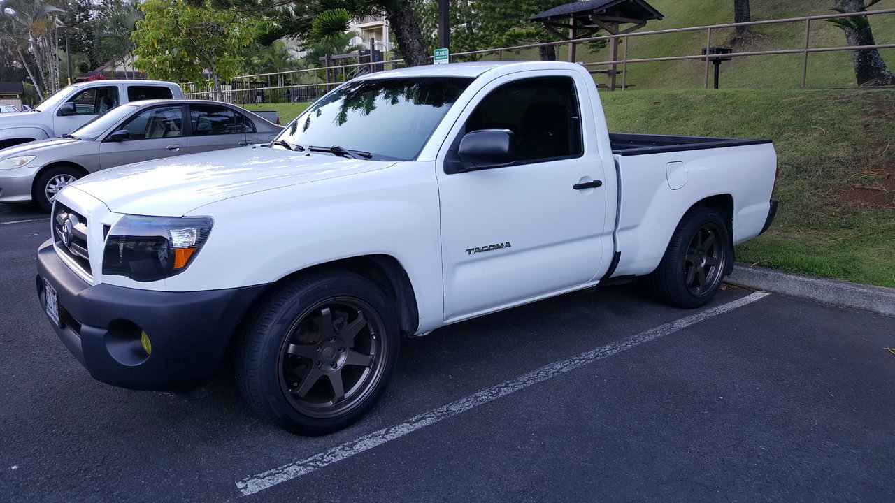

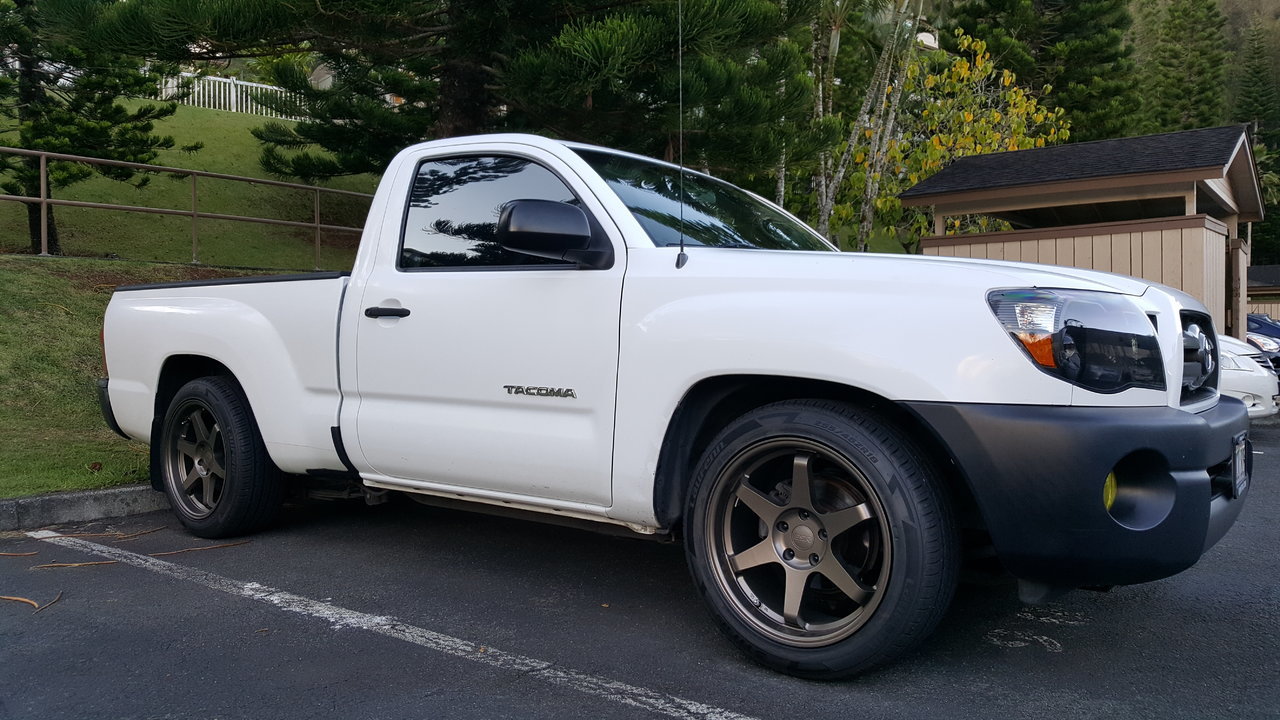

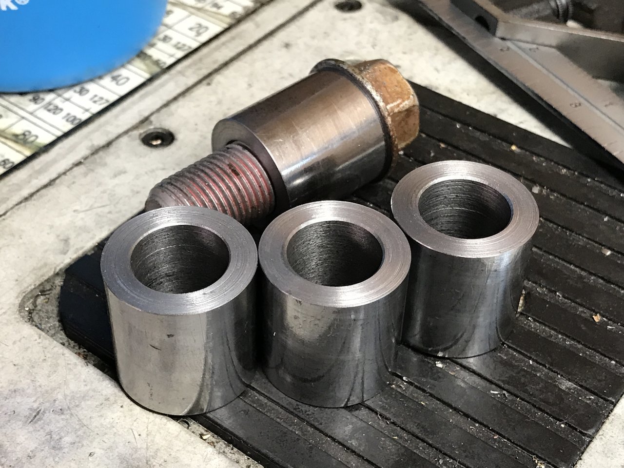

    Machined some cr/mo steel 1" spindle drop spacers for @LogCabins to lower the front of my old 5 lugger.
    Gonna look sick!

    Mucho Mahalo'z! cant wait to get rid of my bro lean....looking like a race truck right now:eek:

    Its mild though....any lower in the rear and I would have to do a frame c-notch...no Bueno (for me anyways) but it definitely looks better then the stock stance

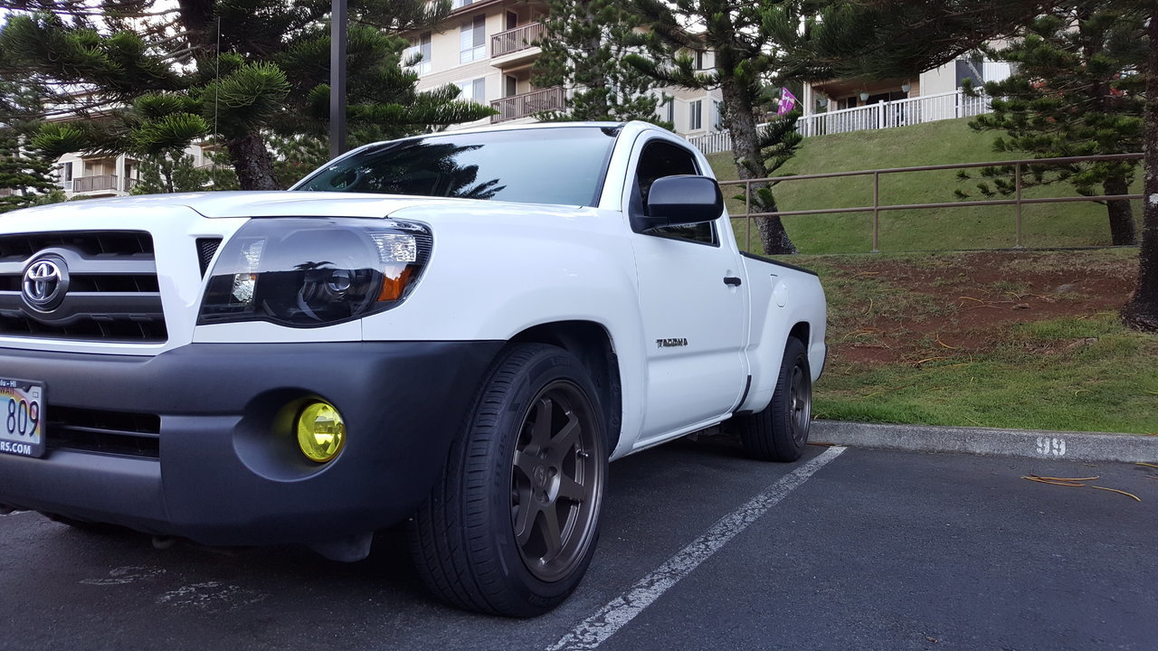

  17. Aug 4, 2017 at 3:16 PM
    #1597
    LogCabins
    LogCabins Well-Known Member
    Apr 30, 2014
    #128878
    2,310
    Robert
    Oahu
    99 SR5 3.4L 4WD
    No more bro lean!!!

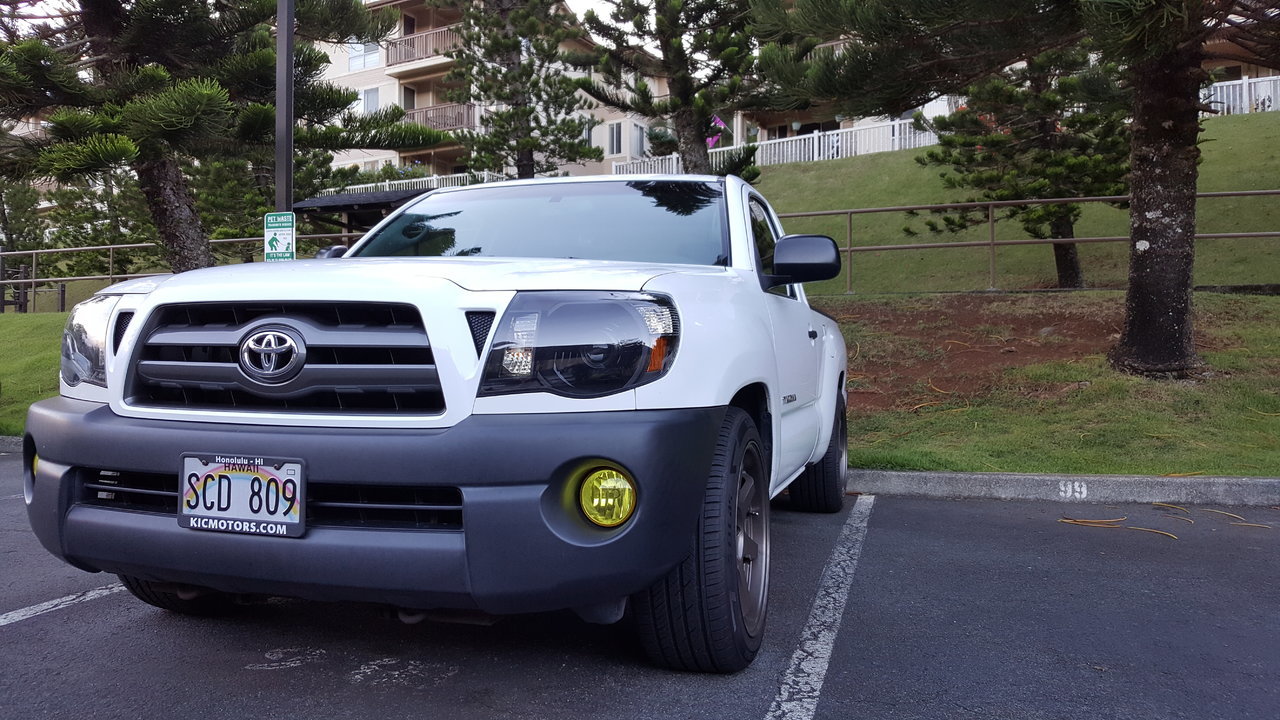

    Mahaloz again for the spacers
    :D
    20170803_182151.jpg 20170803_182105.jpg 20170803_182140.jpg 20170803_182134.jpg
    jubei, Vigo, la0d0g and 12 others like this.

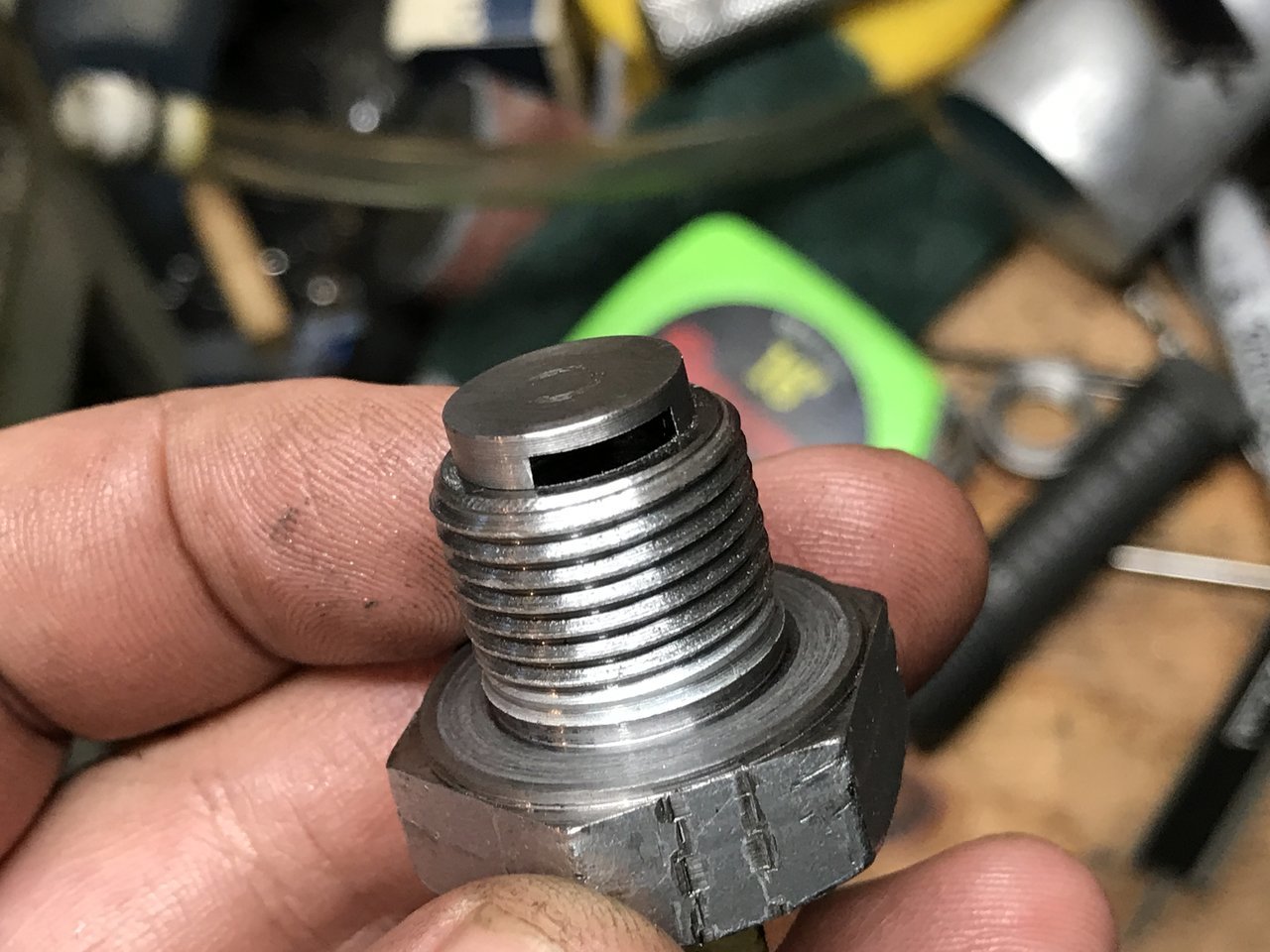

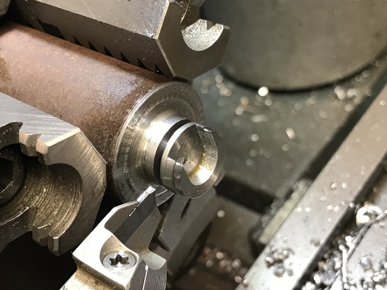

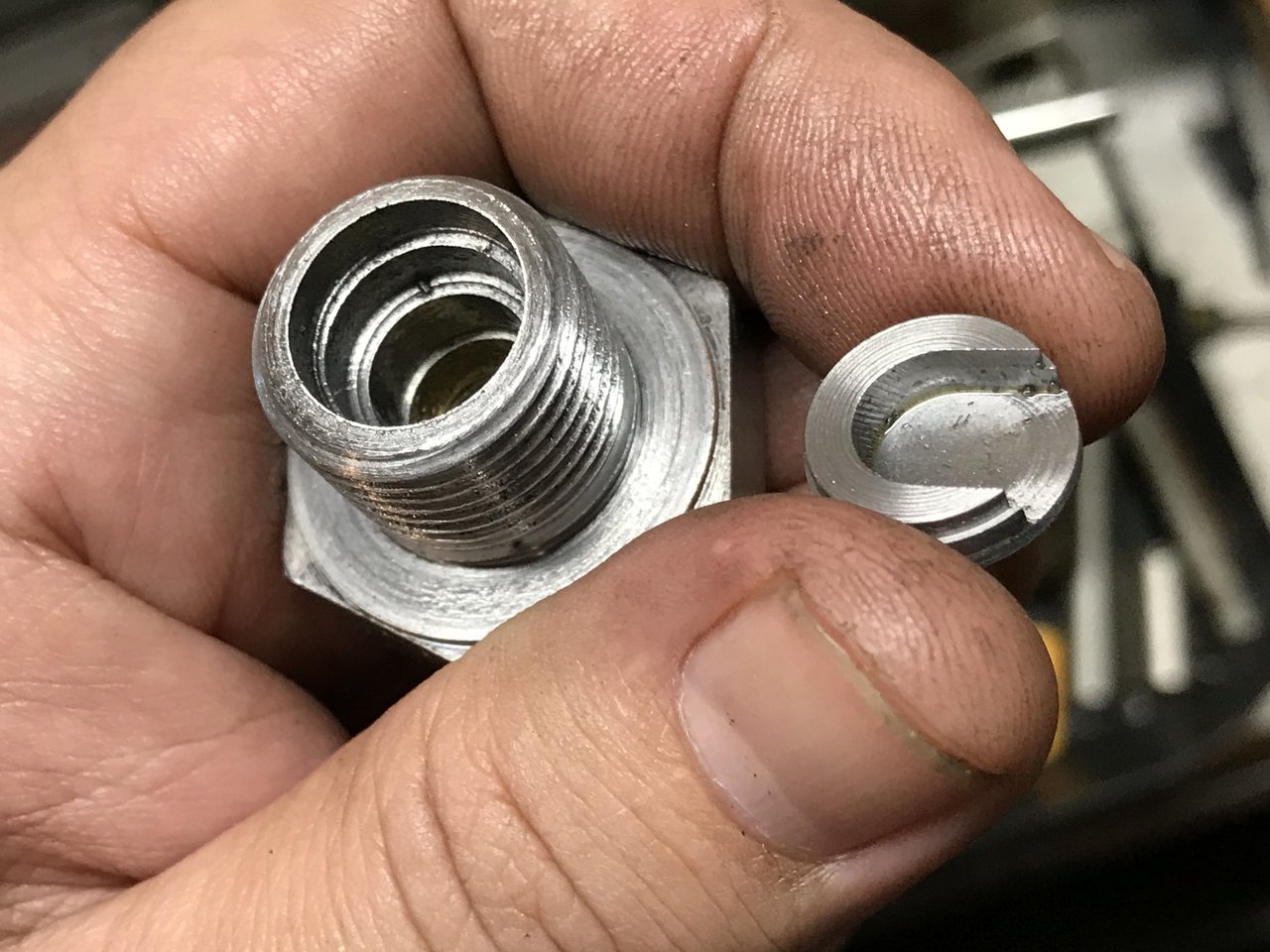

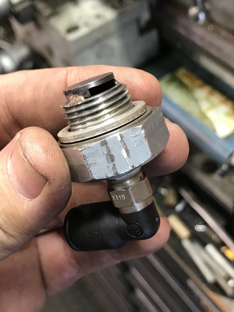

    So because of the way I sealed my T-case to the underside of my body, the breather would have been in the cab. Gear oil smells terrible, so I plugged it up and used the hole for the neutral sensor to be my breather. The problem is it's right inline with the chain to drive the front axle. So when I took the truck for a test drive in the sand and engaged 4wd, I puked out a bunch of gear oil. I wasn't running a tube yet, but I thought a splash shield might be needed. The top of my plug was marked, and the opening is at the bottom. Also gonna run a larger ID tube to the breather so any oil should run back to the T case.

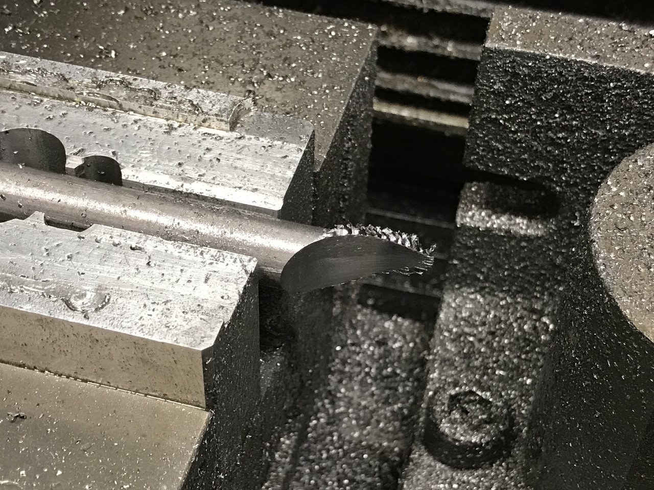

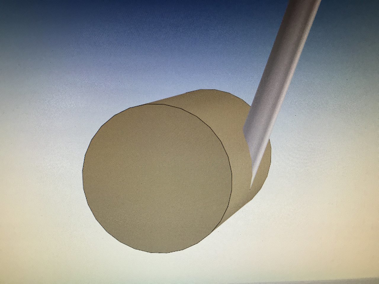

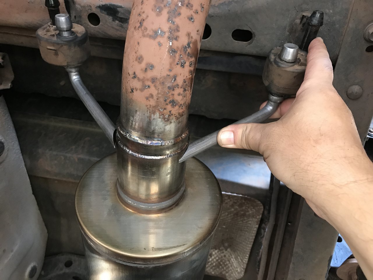

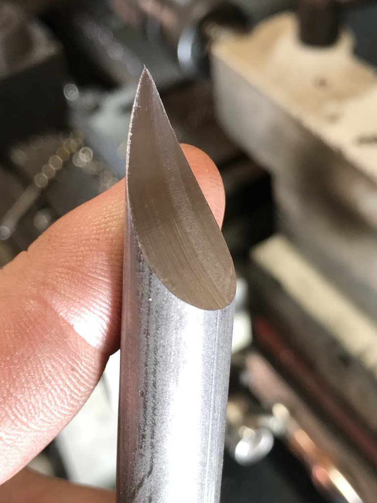

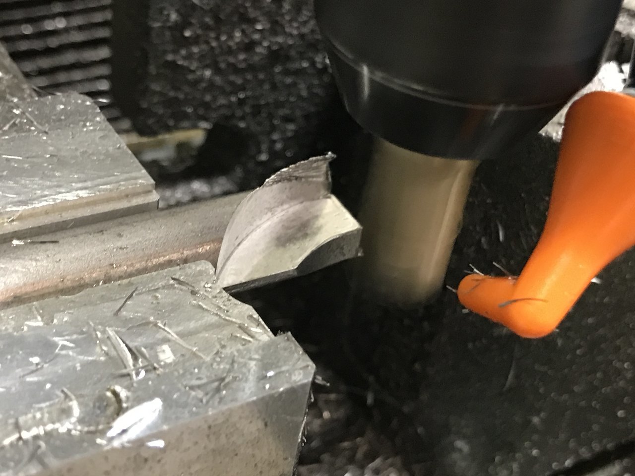

    Also, I didn't have a way to accurately bend the 1/2" solid stainless steel hangers, and we wanted a little more contact between the hanger and tubing, so I decided to write a program to cope the round bar to the pipe OD. Worked out well and looks pretty damn clean.
    About 15 minutes run time, pretty conservative cut. Material and cutter are cool to the touch when finished.
    Deadly :eek:

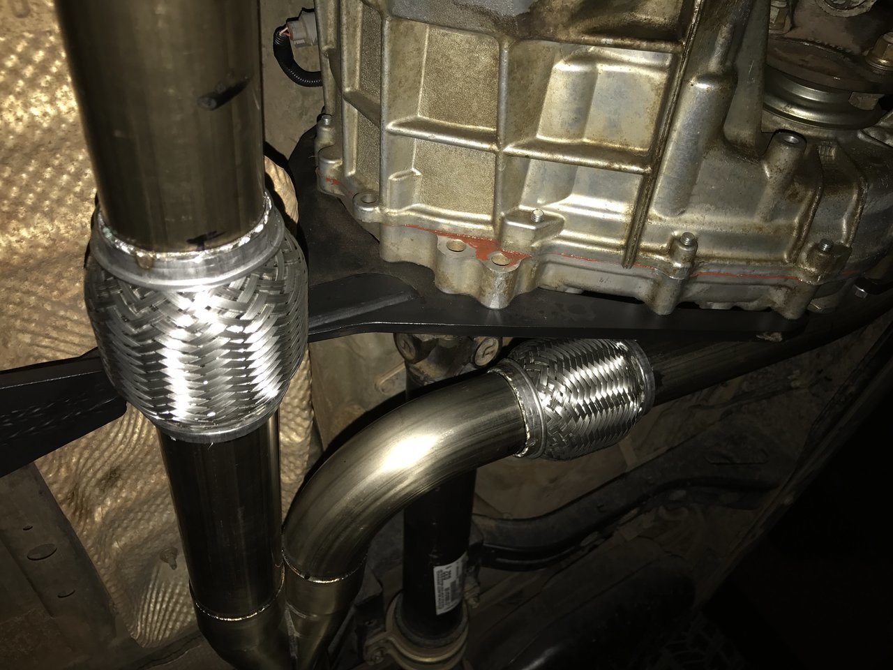

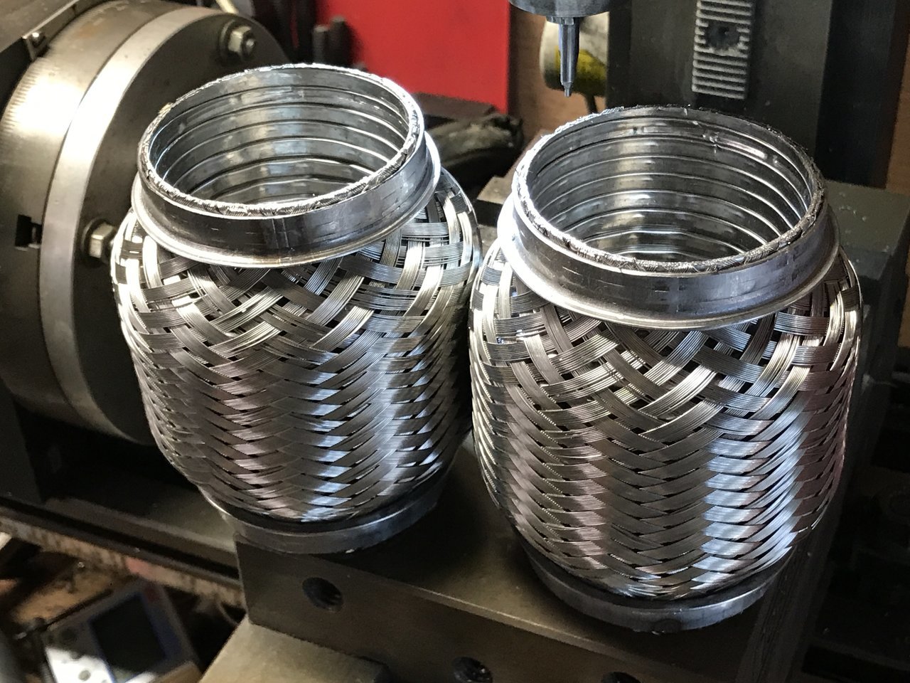

    Also, turboflex couplings are in. Gives the system some much needed flexibility.
