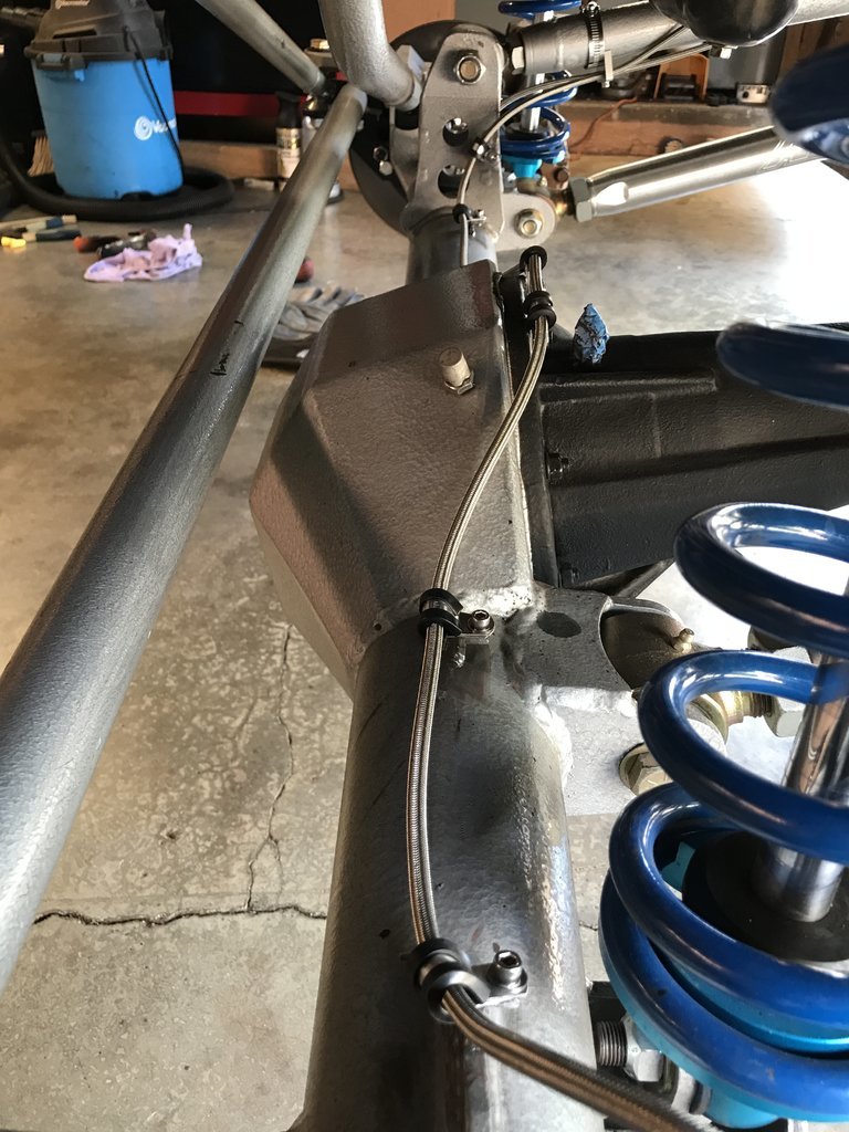

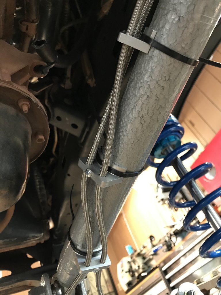

    Okay so recon inspector didn't like my brake lines zip tied to the axle. He told me the brake lines can't be touching anything, which makes sense, since any friction can eventually wear through the lines. But these braided lines are just temporary until I can get some custom hard lines like how @THROTTLE231 has his lines running on his killer setup.

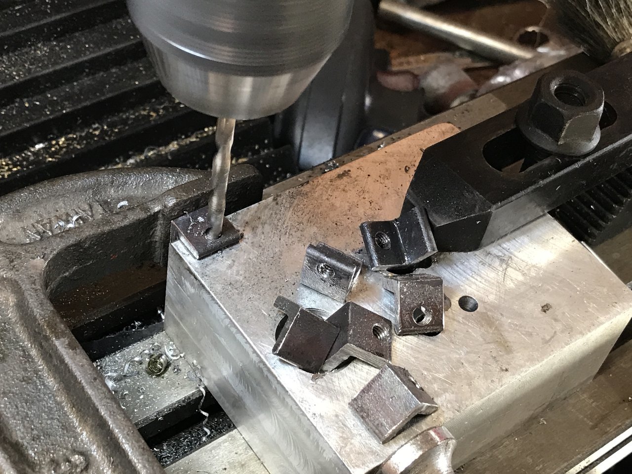

    So I chopped up a bunch of small steel angle, set up a quick and dirty drilling and tapping jig, and made a bunch of tabs, and bought some brake line clamps.

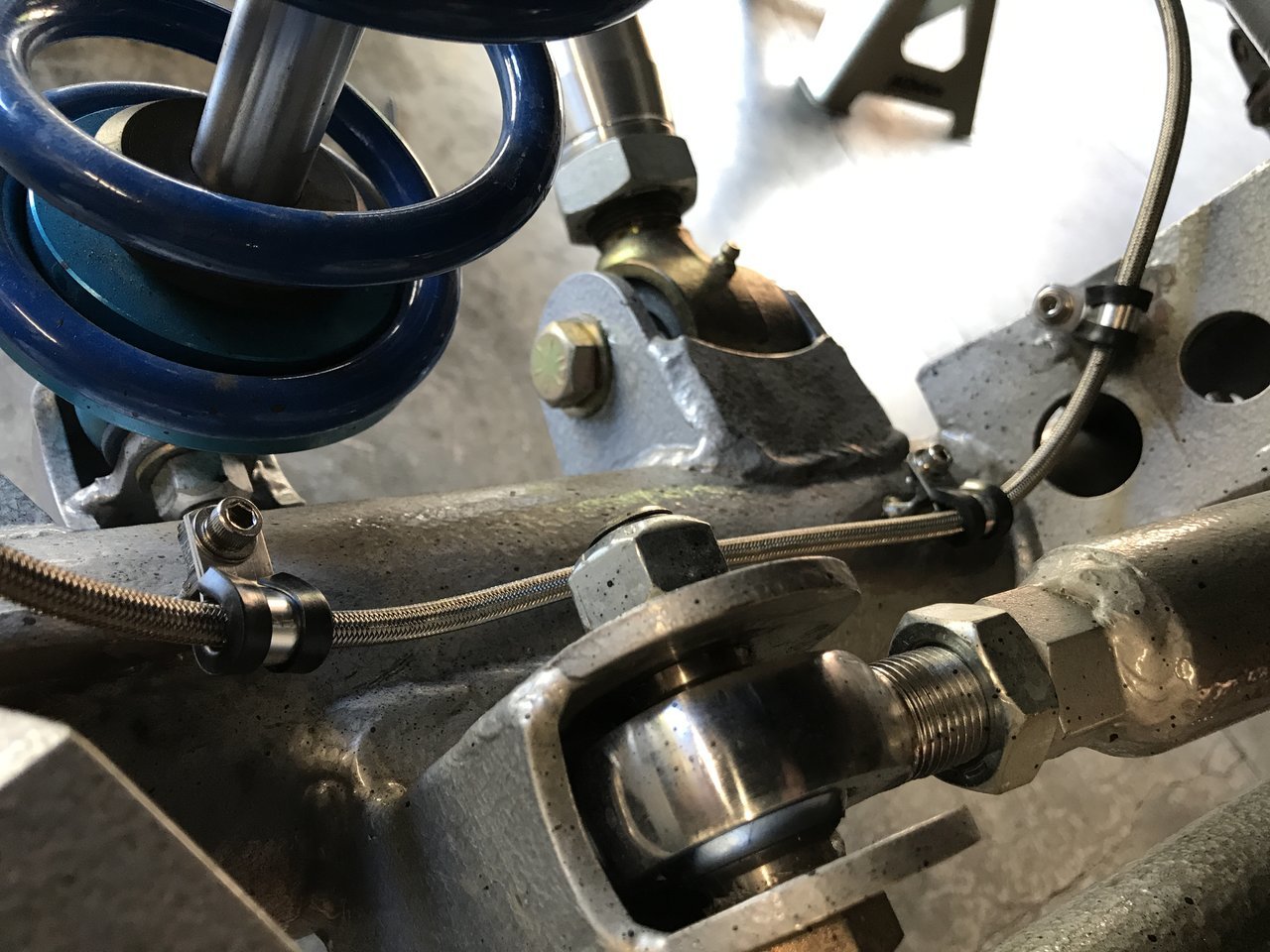

    Then I welded them to the axle making sure that it doesn't contact anything, and that I have enough slack at the ends for full lock to lock turning angle. Axle is also at full droop to make sure it has enough slack on the top link.

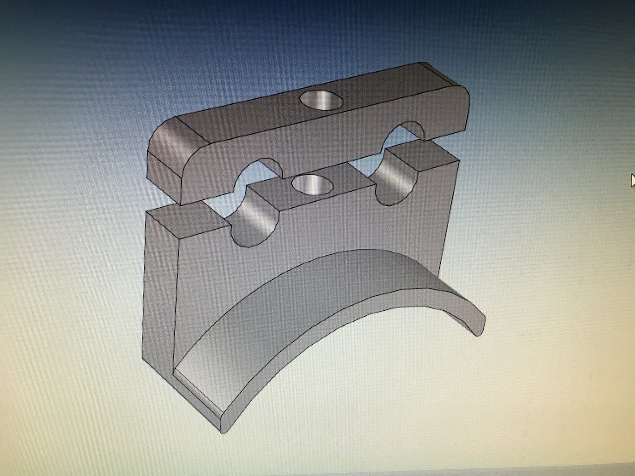

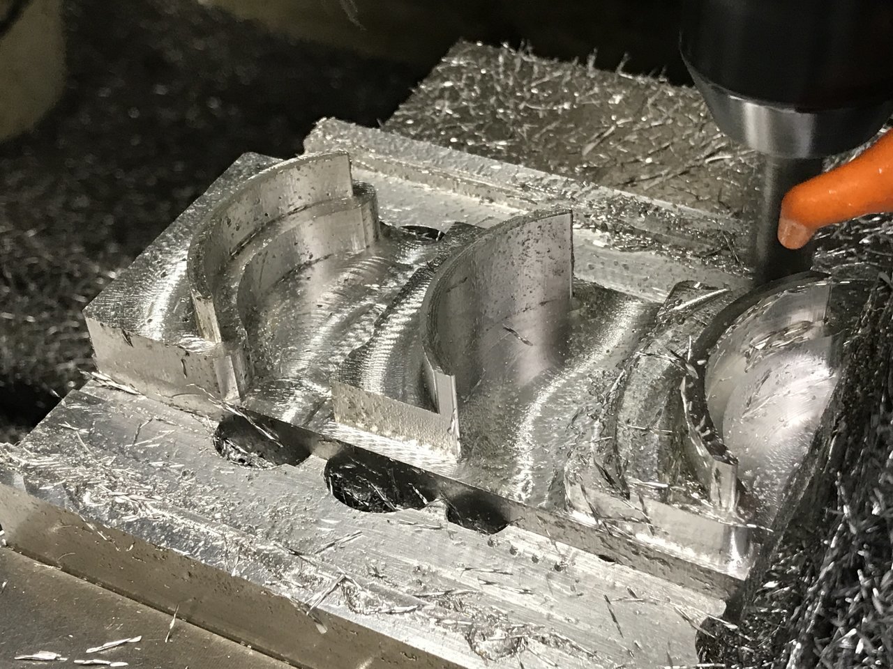

    To run the lines up the top link, I designed a simple clamp in cad, then machined it out of 6061 aluminum on my tormach.
    The zip ties were just for fit up. They have hose clamps on them now.
    Everything looks good enough... and recon can't bitch about it. Too bad it's all getting cut off eventually :laughing:
    Hopefully I can get recon and safety check sticker next week :)
