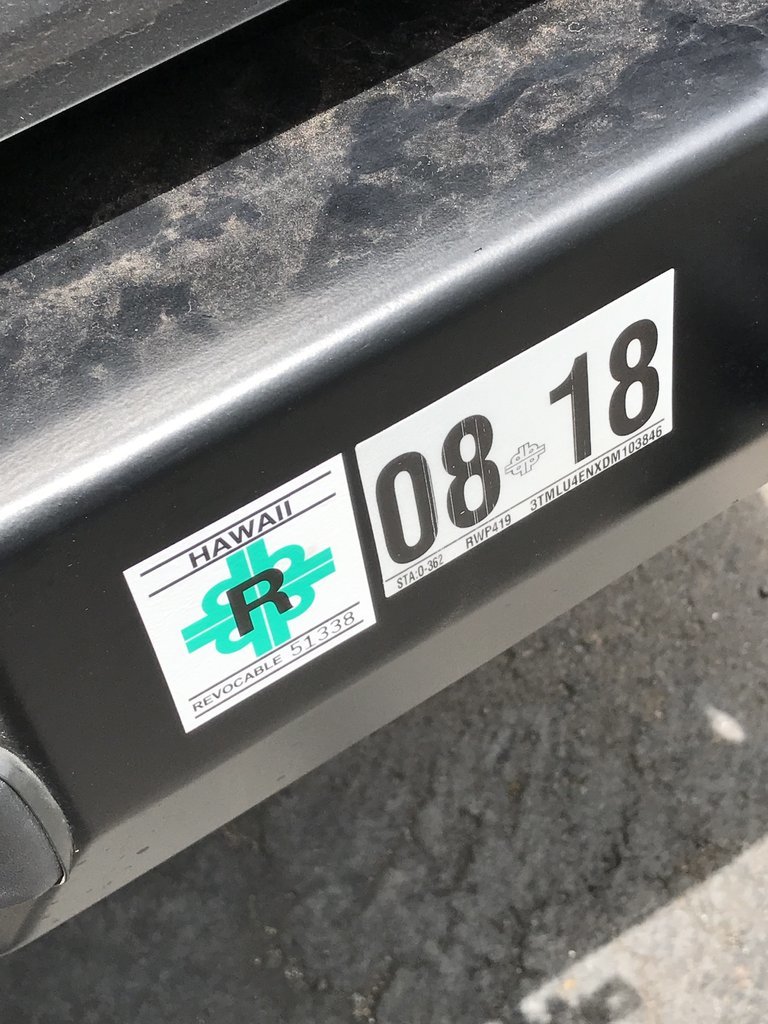

    Yeah, this is just required on Oahu. This is separate from the safety inspection. Have to list all the major mods. And modifications to the vehicle supposed to get a reconstruction permit.

    TRD supercharger, URD 2.85" stealth pulley, TRD exhaust, TRD intake, DTLT headers, URD y-pipe, TRD boost gauge, PLX DM100 touch with OBDII and SM-AFR modules, 885 OME 3", Icon UCAs, Satoshi grill, Solid rear window, SCS stealth 6, 285/75/17 toyo AT2.
    Yay! Celebratory beers

    Passed safety!
