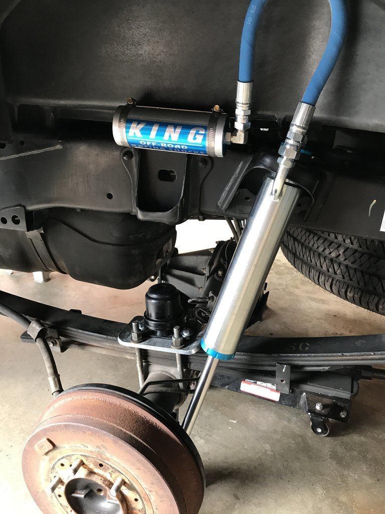

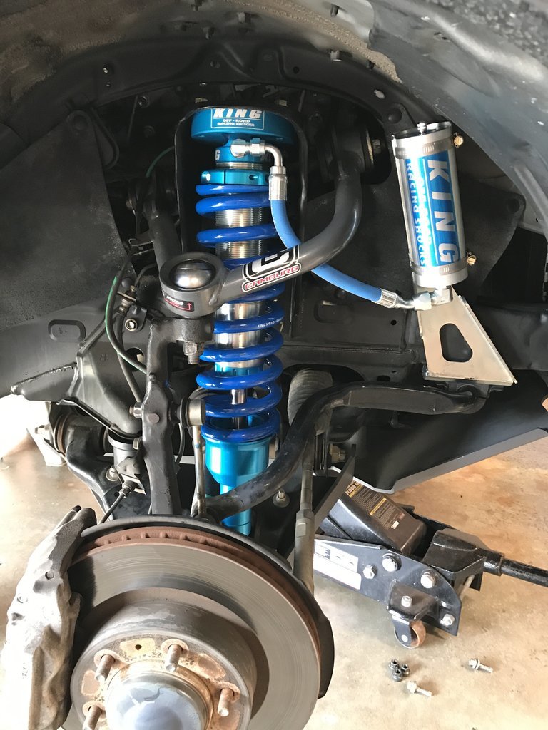

    Haven't really touched my truck lately, but helped my friend @huli467 install some sexy Kings :cool:
    I let him do most of the work tho :rofl:

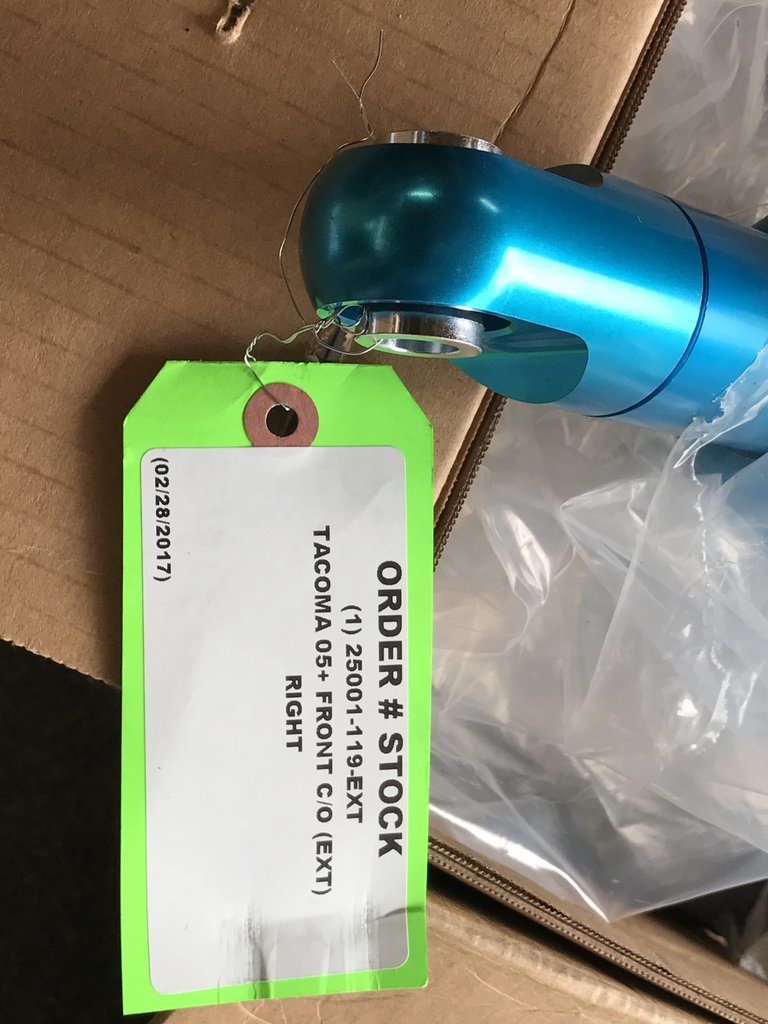

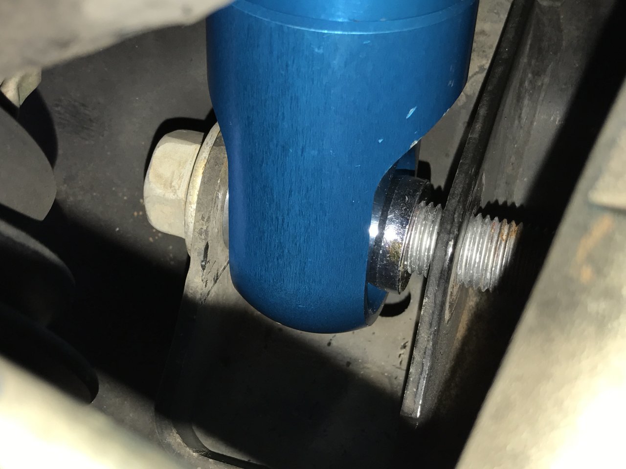

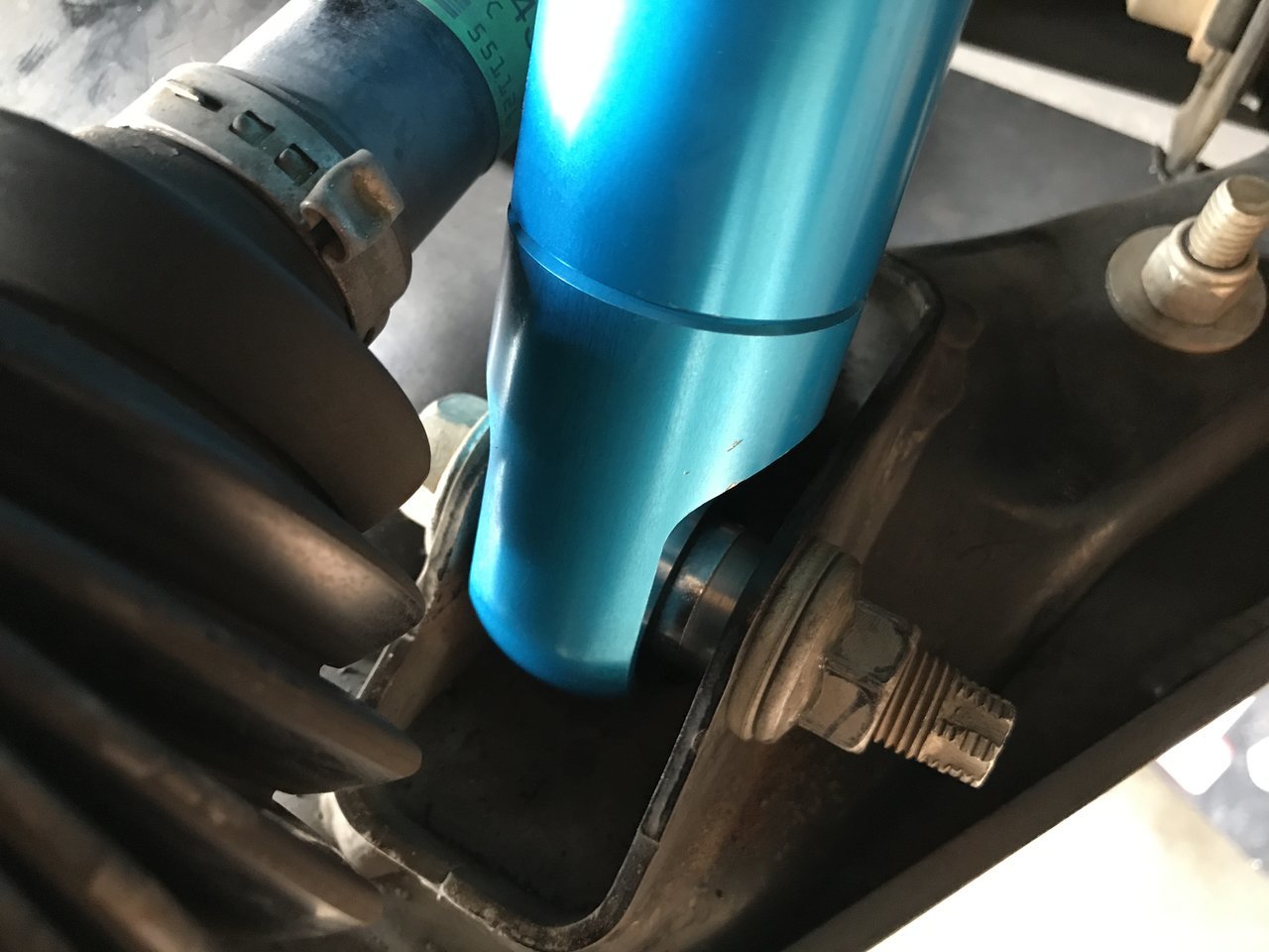

    And this is the first time I seen something wrong with Kings!
    Wrong spacers in the lower spherical bearing! Kinda weird for off the shelf shocks...
    But John called them and got the guys email and sent some pics. Right spacers are on the way. Luckily I had some Cro-Mo steel laying around and made him some temp 0.220" wide spacers.
    Everything else went pretty smooth and quick.
    Also threw in superbumps front and rear.
    Jealous! :drool:

    I had the same problem with DSM.

    I was telling him at the time, whoever assembled those shocks probably fucked up more than one pair, so king might be getting some phone calls. I think @huli467 said it came from wheelers.
