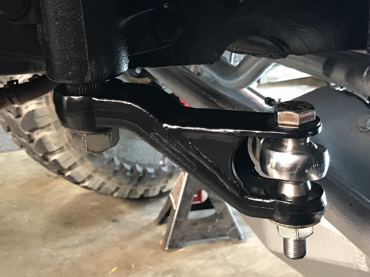

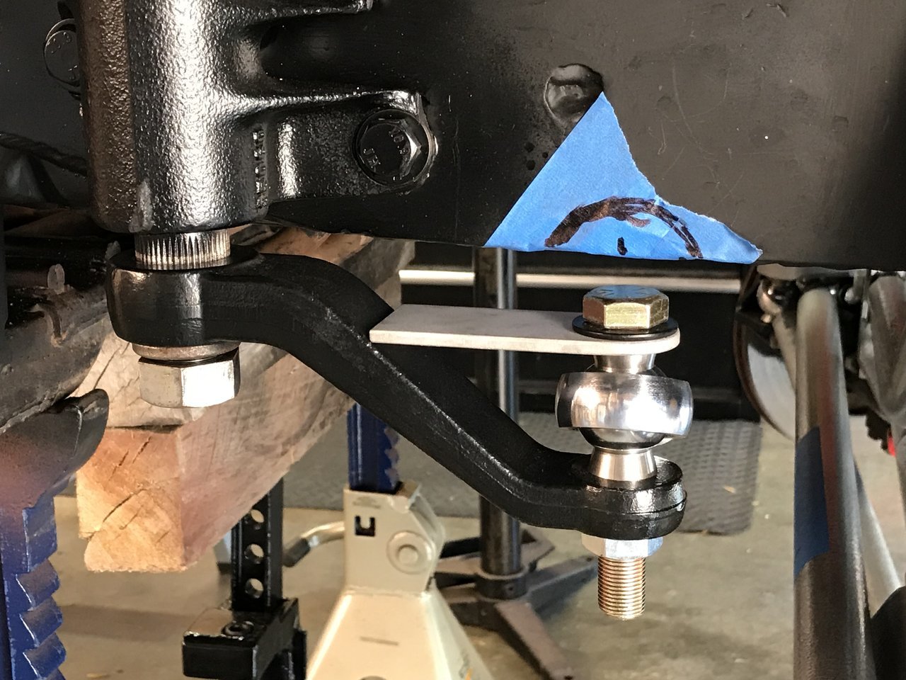

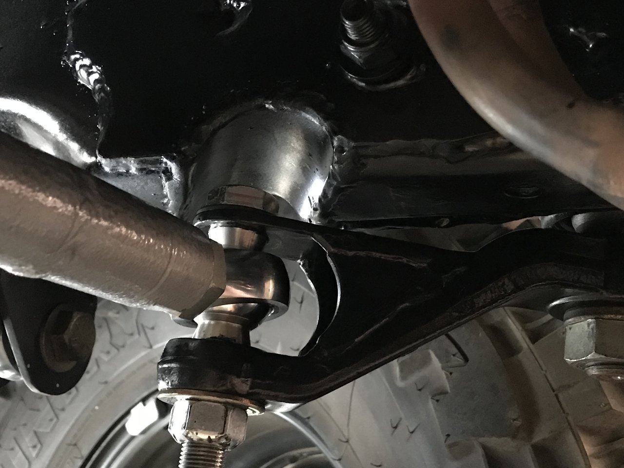

    Boxed in the pitman arm yesterday. Bolted it on today. Now to fit up the HA...

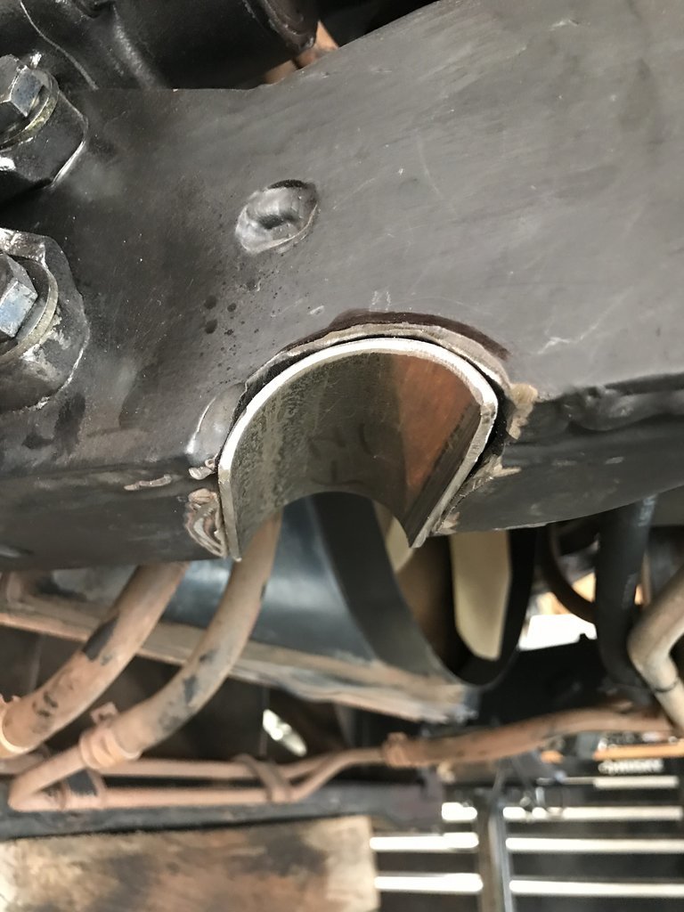

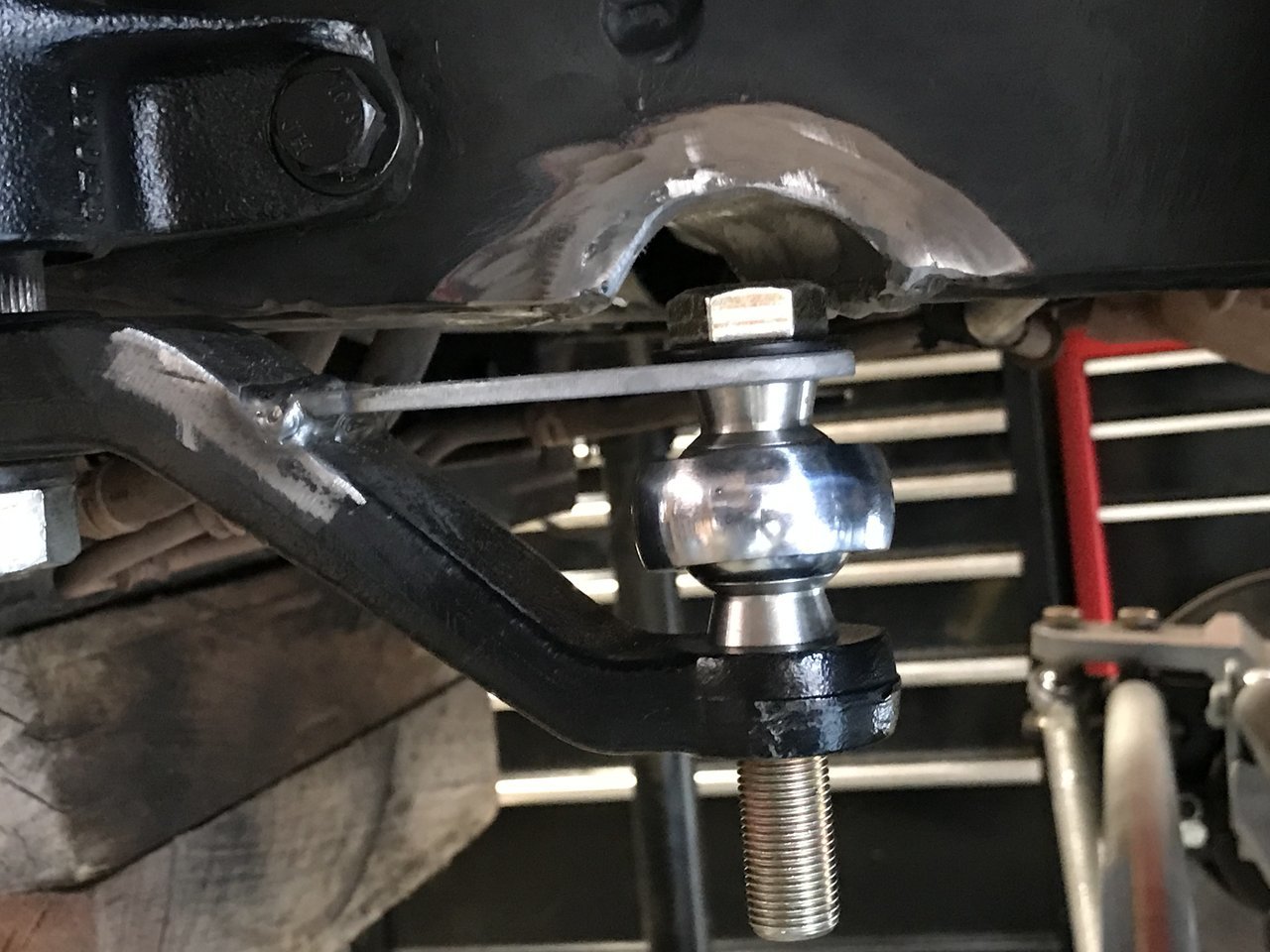

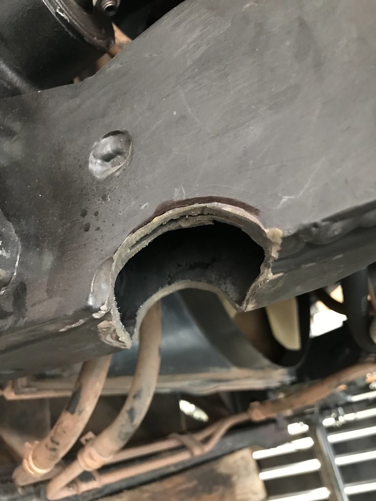

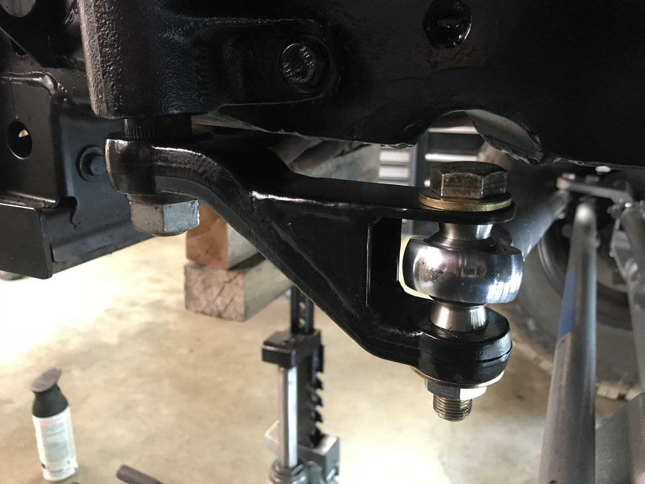

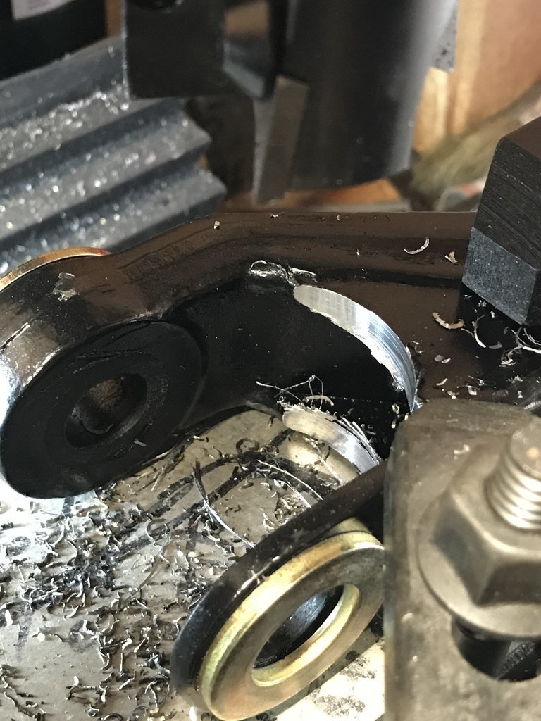

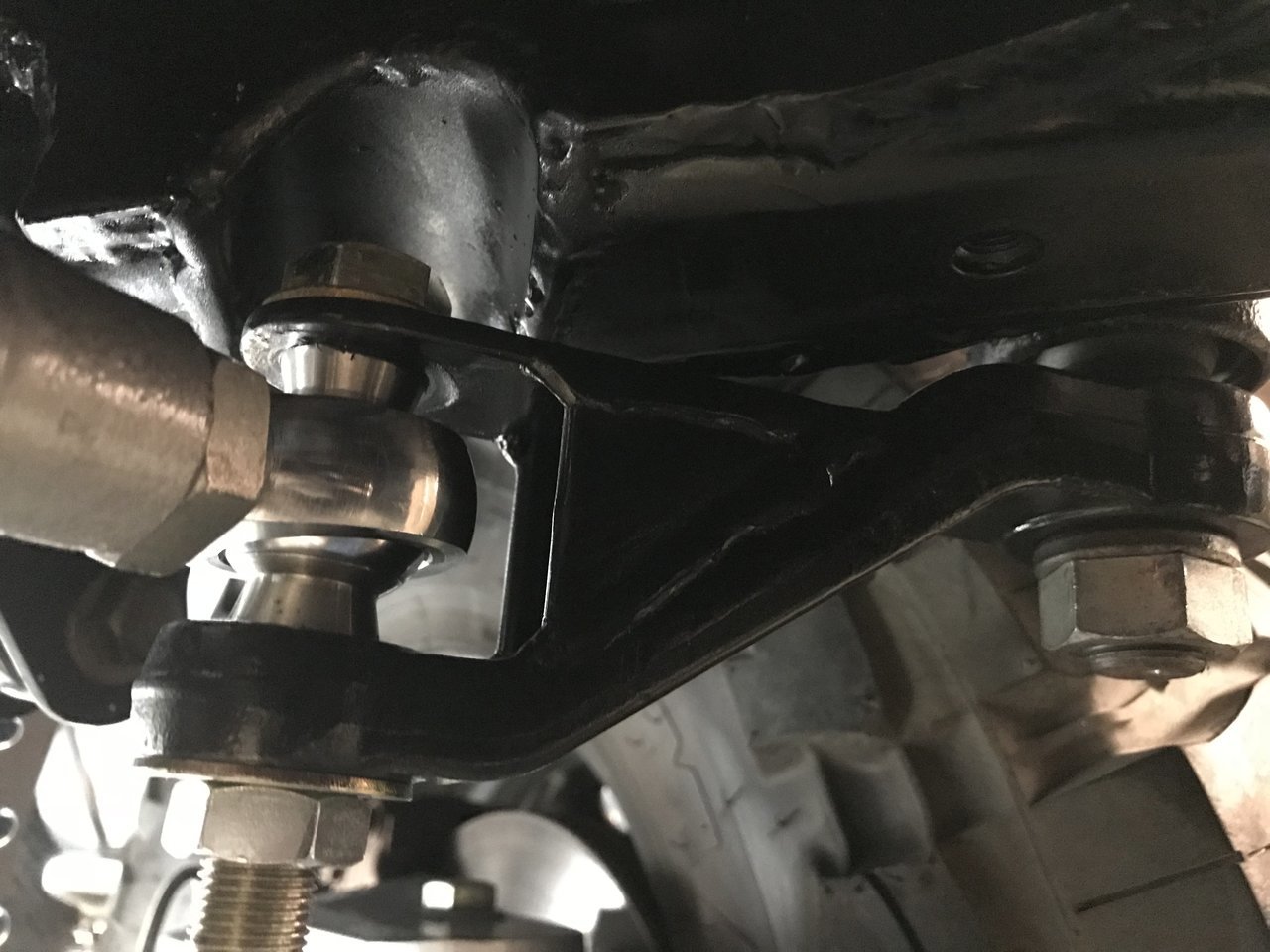

    The box plate I added to the pitman arm was a little close to the drag link at full drivers side steering lock. So I pulled the arm off again and cut a radius in it by plunge cutting with a carbide insert face mill. Looked good so I did both sides.

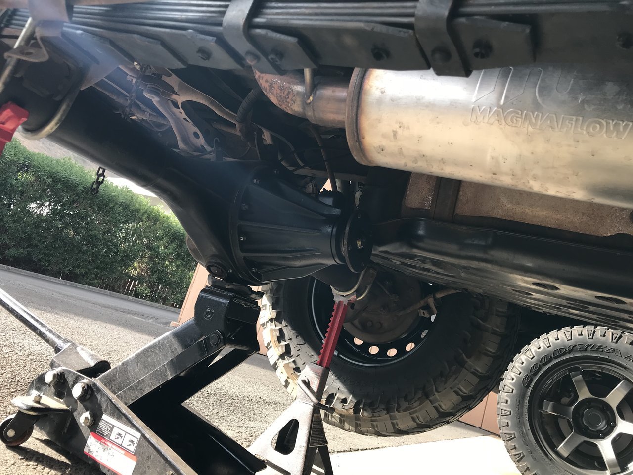

    And I also finally got around to swapping out the pinion seal that ECGS sent me. I gotta check the oil level tomorrow. Hopefully the outside of the third member and the bottom of my truck stays dry now.

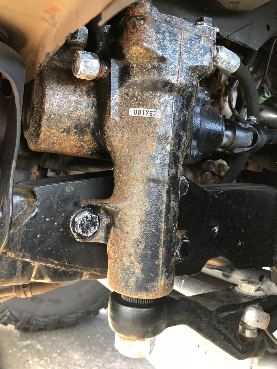

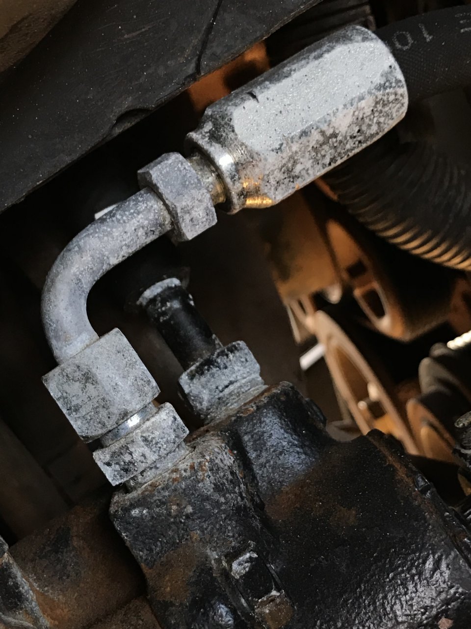

    So... I sold my townhouse on Oahu and bought a place with a real garage on the big island. And the boat ride over rusted the shit out of everything!

    Yeah, can't help it tho. Only one company ships vehicles interisland, and they are right on the deck of the ship. Truck was covered in sea salt.
