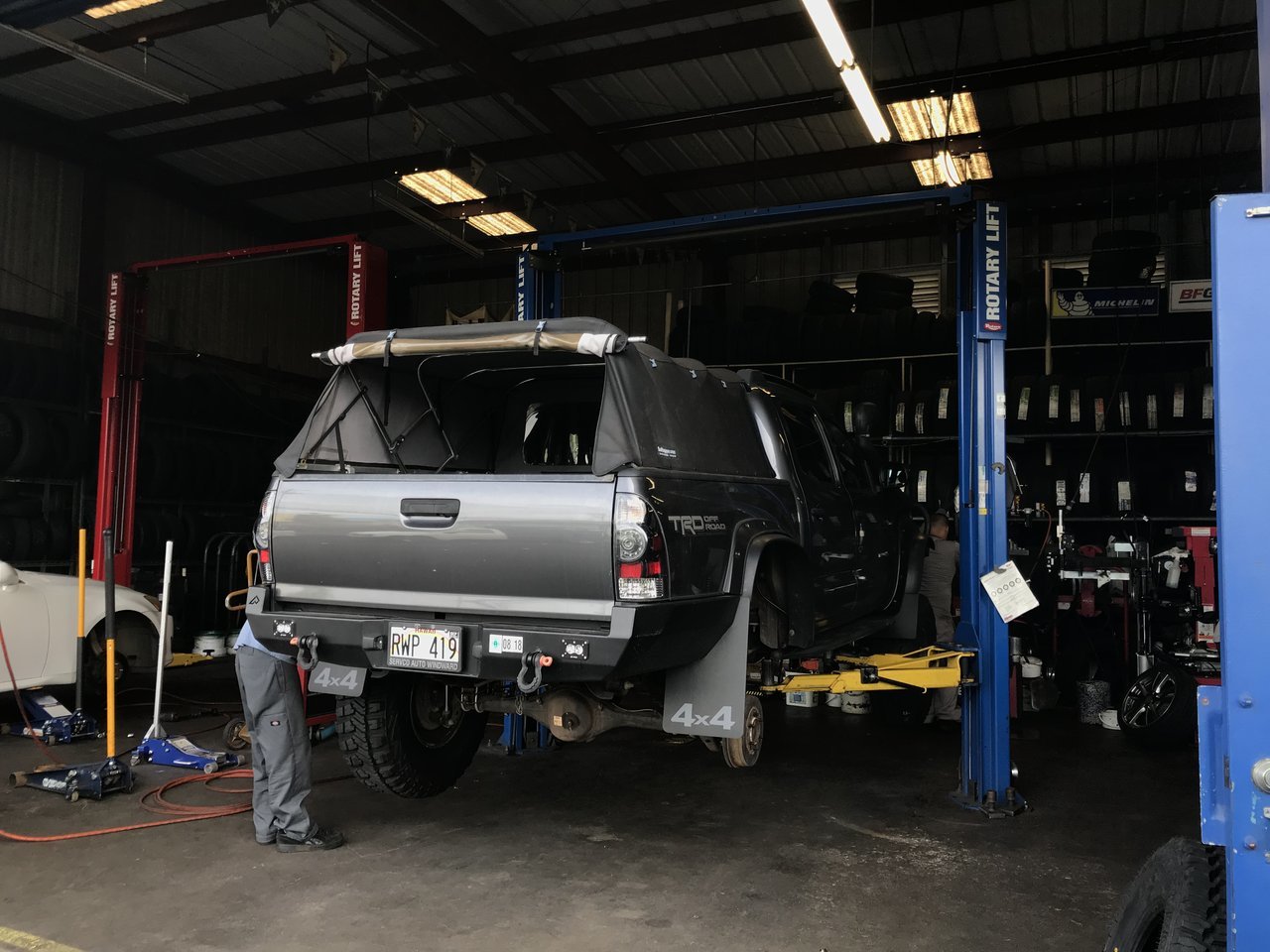

    As far as the truck goes, I was still getting some death wobble, so I took the truck to K&J tire in Hilo, and they do road force balancing there, and their machine is big enough for bus tires and stuff so 37s were no issue for them. One rear tire was still out of round, and they tried everything they could to get it true. They took apart that Hutchinson wheel 3 times trying to reposition the tire on the wheel. It was reading over 0.050" if runout on that tire, and the best they could get it was 0.040". Still out of tolerance, but better, and it made a difference on the highway. Bed doesn't shake as bad at +50mph, and I haven't had death wobble since the visit to the tire shop.
    Now I just need to slap the hydro assist ram on the front axle, and mount the king hydro bumps on the front and rear... any day now...

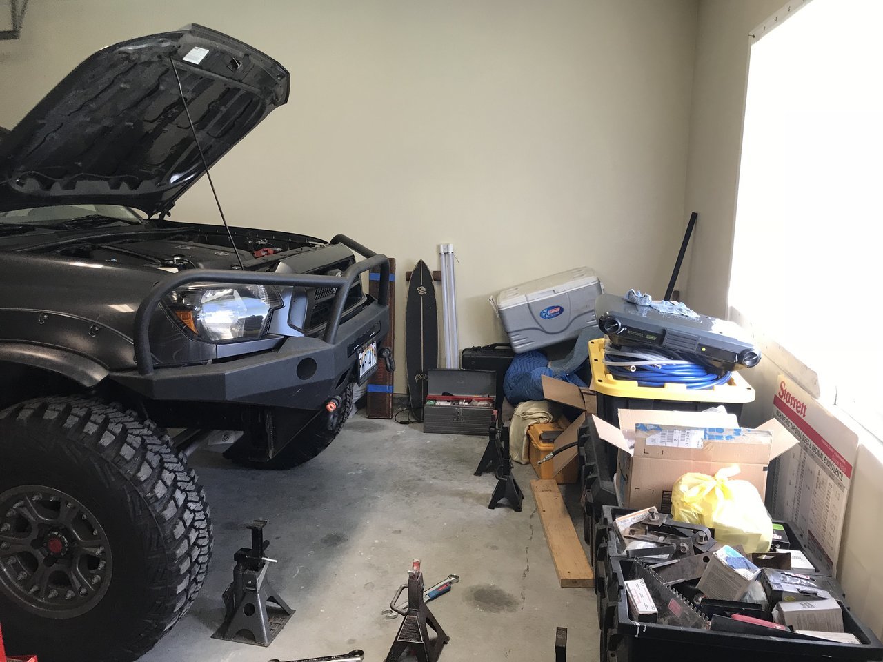

    Congrats on the house and the new garage. Looks beautiful! I'm in the same boat as you with just moving into a new house. Where to put everything and damn I have too much shit. Sorry to hear about that rust. Looks like you need to go explore some new trails!
    :mudding:and post some pics of the adventure.

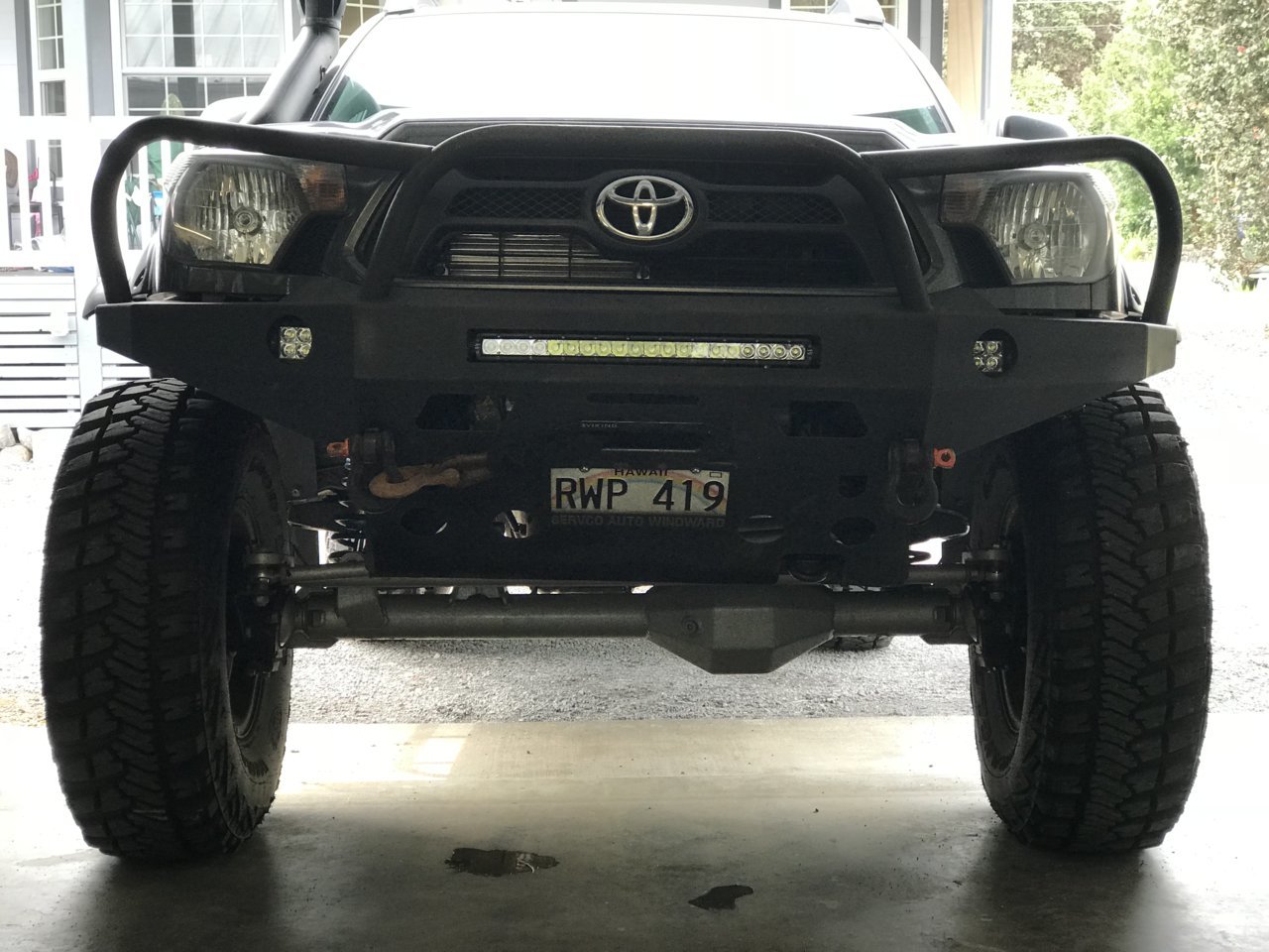

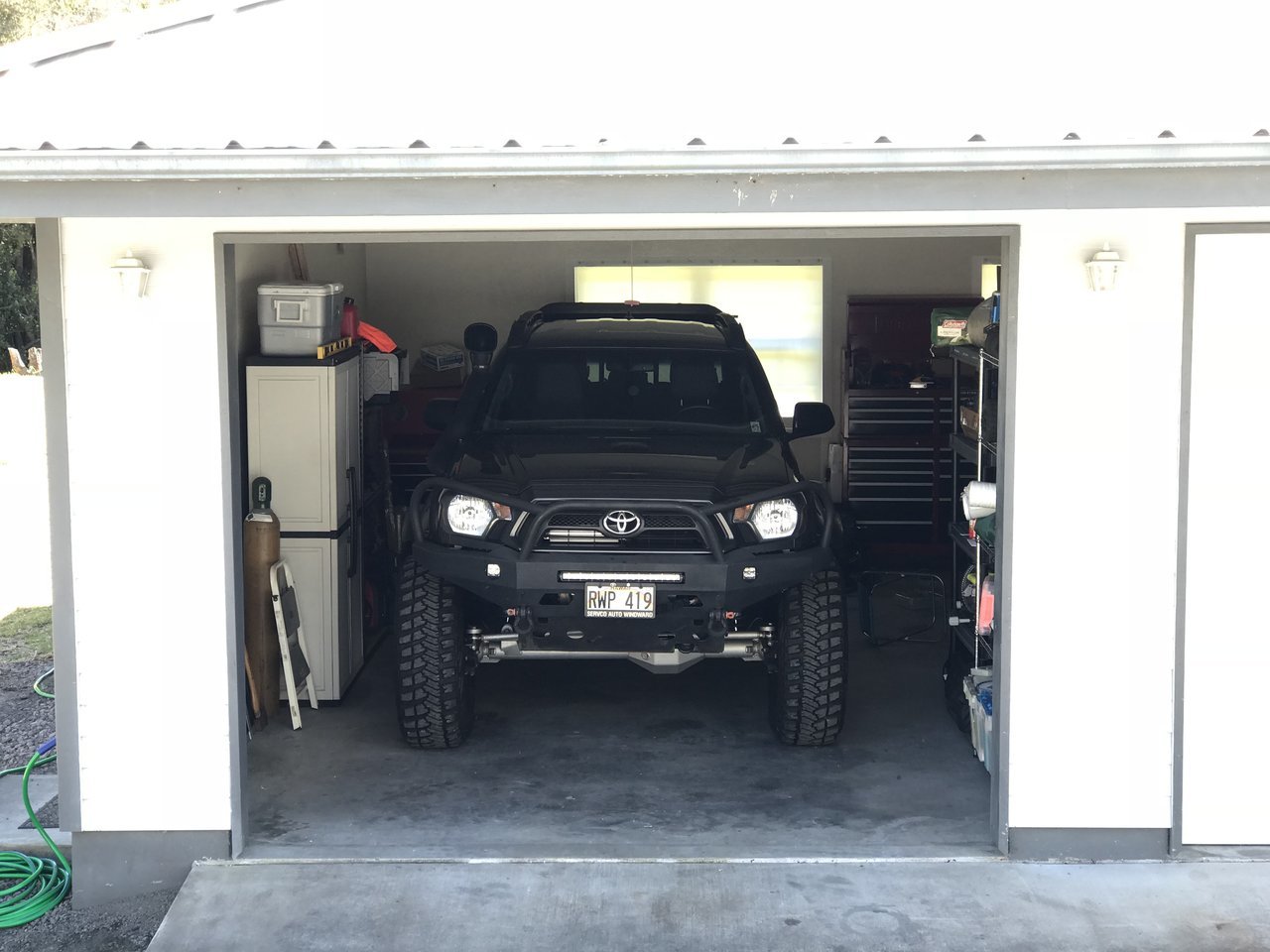

    Not much going on with the truck. I can't down it till my wife gets here with her truck. It's my only wheels, so I can't put it on jack stands to work on the HA or hydro bumps.

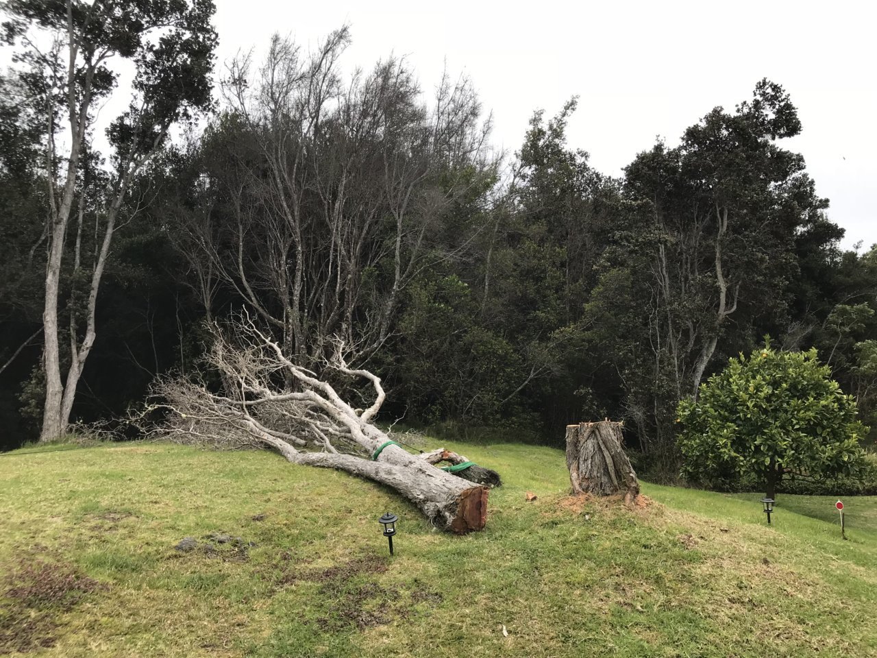

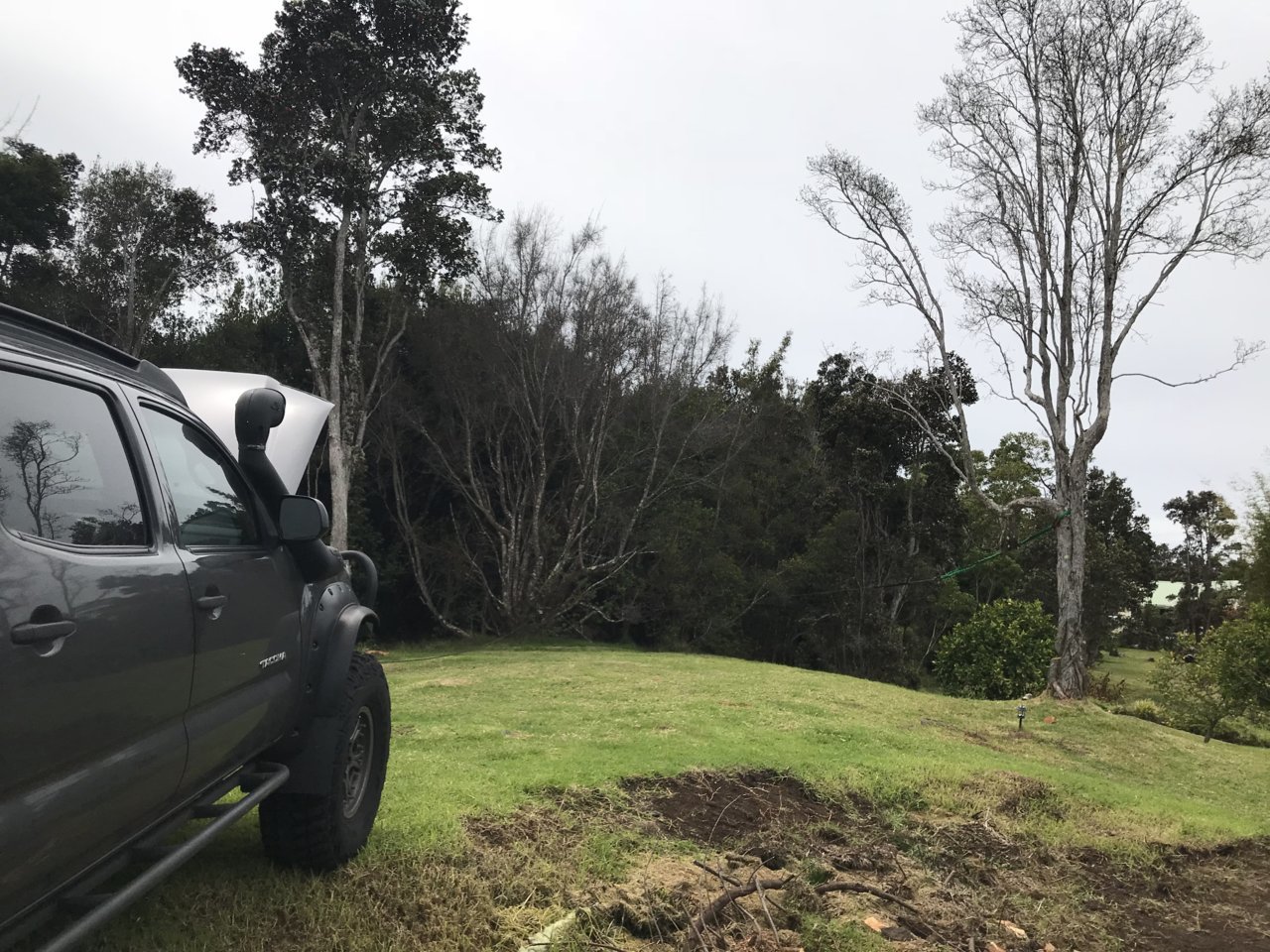

    But one thing I finally did was drill holes in the pelfreybilt bumper for the license plate. I got tired of cutting off the zip ties every time I needed to use the winch. There are always tourist stuck in the mud on the side of the road, and I also used it to safely cut down a tree.
    Used the snatch block to make sure it falls away from the house, and my truck.
    Free fire wood!

    Love how the hoops are angled from the other pelfreybilt bumpers

    Me too :D

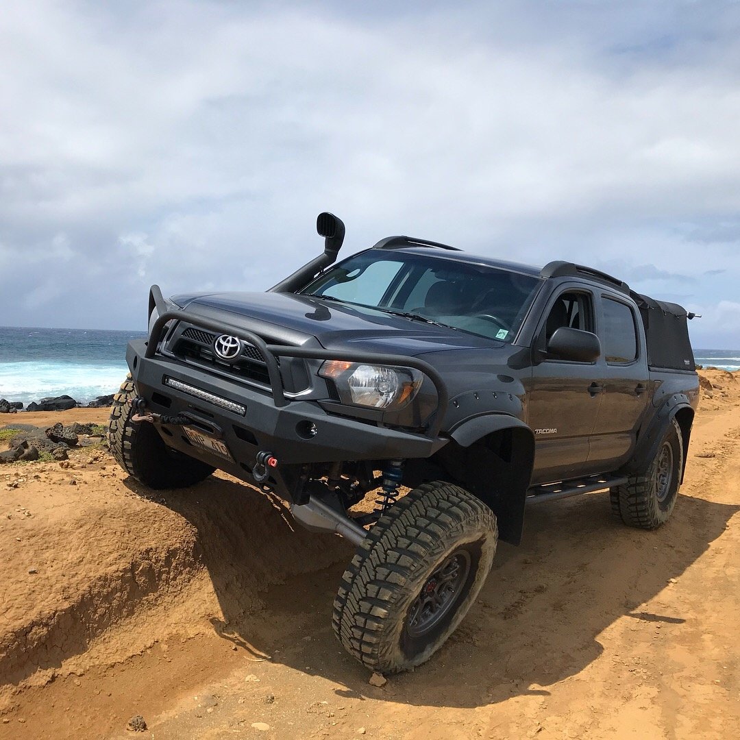

    Posted this on my IG, but forgot to add it here. Went down to south point to check it out since @squint0241 was visiting.
    Had some pretty good off roading. I hit a couple climbs and drop downs that would have been a little sketchy with the IFS, and rick got out to shoot video, but it was so easy with the sas that it was a really boring video...
    And we also checked out halemaumau crater.
