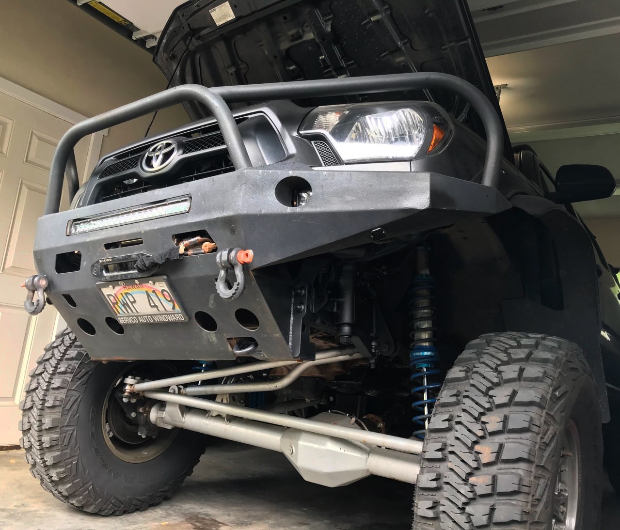

    Happy day! My death wobble is gone!!! :yay:

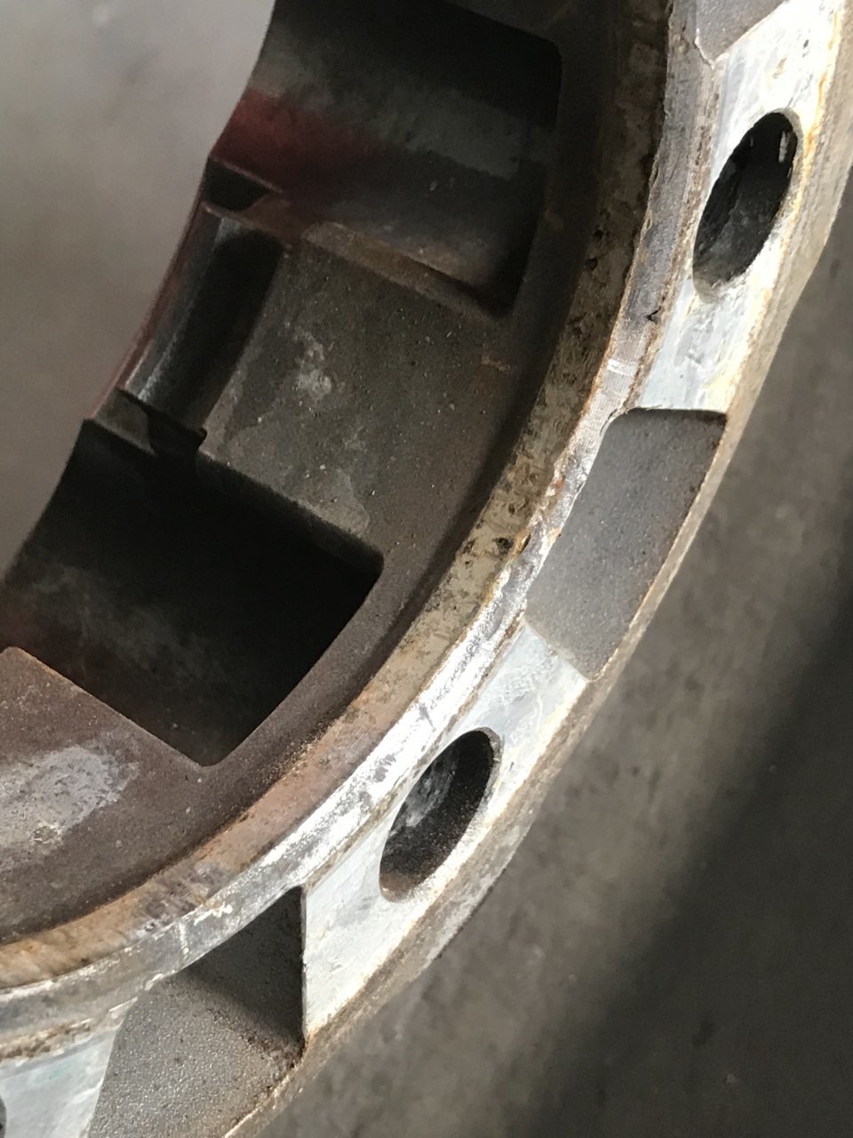

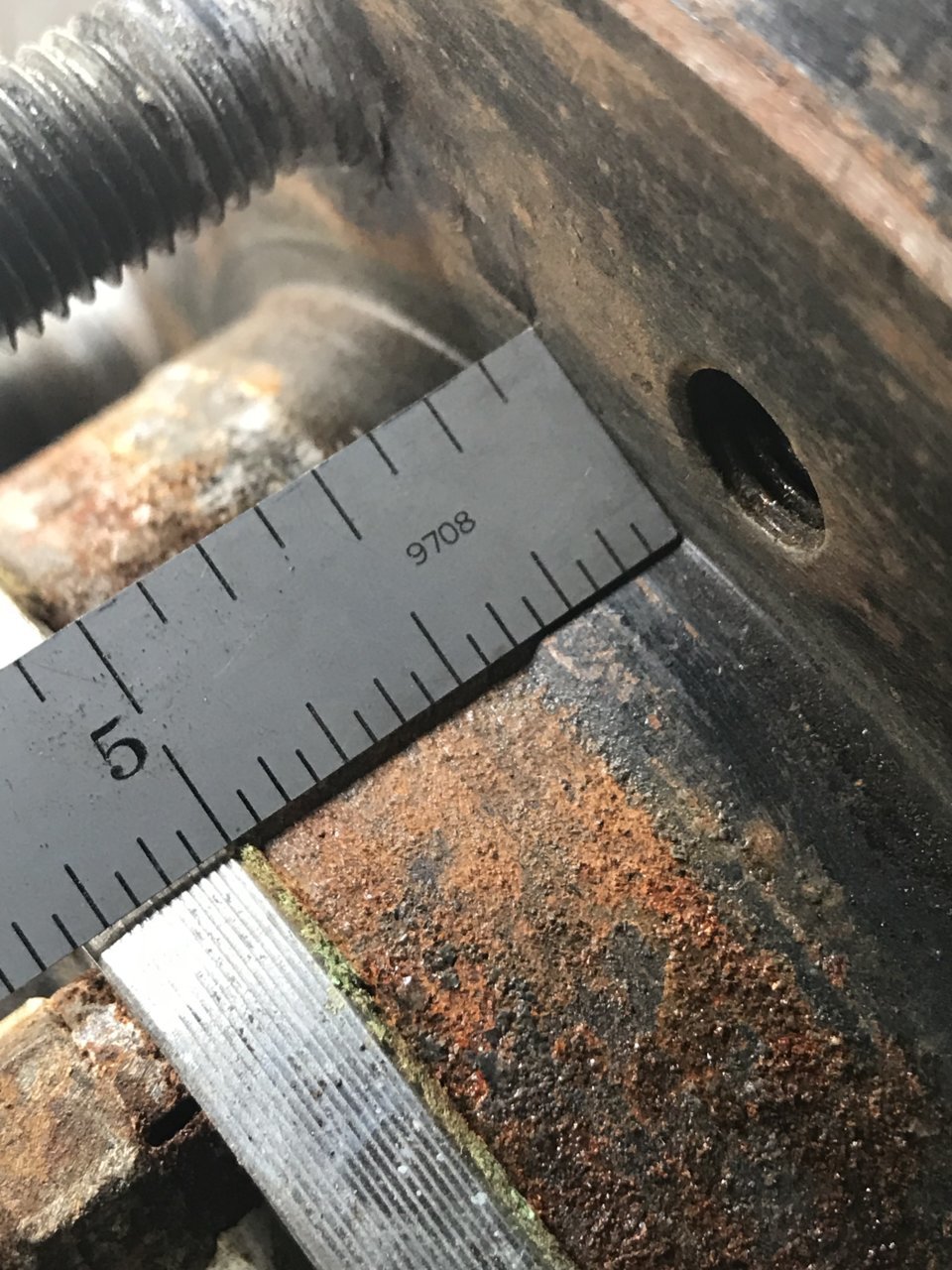

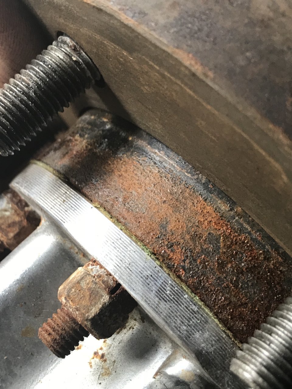

    I took off my wheels and tires last week to check on my links and make sure everything is tight.
    My wife was on Oahu and her truck was at the airport, so i threw the tires back on real quick cause i had to pick up my daughter from boarding school for the weekend, and the death wobble was worse. Way worse. I couldn't drive between 40-45 on the speedo. Which is actually closer to 45-50 actual speed. Faster is fine, but was raining so everyone was driving right in that bad range :rolleyes: and her school is 100 miles away...
    As soon as i get home, i pull off the tires cause it's weird that it got worse.
    I finally realized that there was some slop on the way the stock Tacoma brake rotors fit over these solid axle hubs. And the landing is very small. Barely 5/16" without the rotor on the flange.
    Once the rotor is mounted, it's less than 1/8" and the Hutchinson's have a massive chamfer on the bore. The landing might be enough for steelies, which is why the 35s on steelies @Vigo let me borrow ran fine.
    The Hutchinson beadlocks are hub centric so they use the shouldered lug nuts, not tapered lug nuts to center the wheel. So the rotors and the wheels were just kinda floating until the lug nuts are torqued. So Anyway, I machined some quick hubcentric rings out of delrin I had laying around, and the truck is smooth as glass. Unbelievable... didn't take any pics of the rings, but they worked great! :bananadance:

    Ha and here you were blaming the tires.
    Mtrs are the tits

    :oops: It would have been nicer to have figured it out and made rings long ago :rofl: I knew the rotors were not fitting that well, and I made small rings long ago to center them on the lugs, but they didn't seem to help, so I took them out. Now everything is surprisingly smooth.
