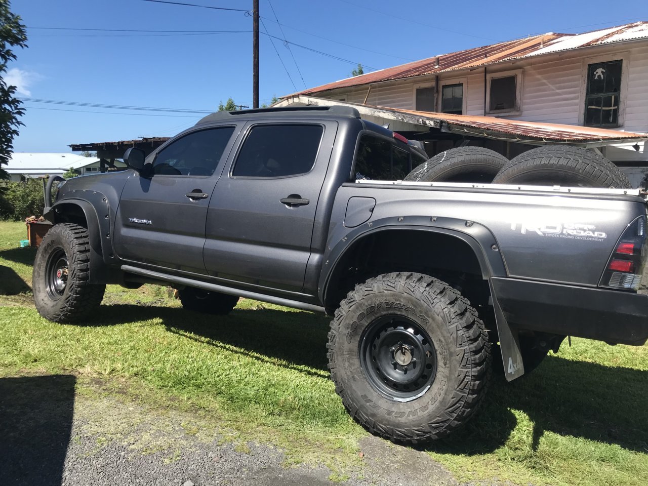

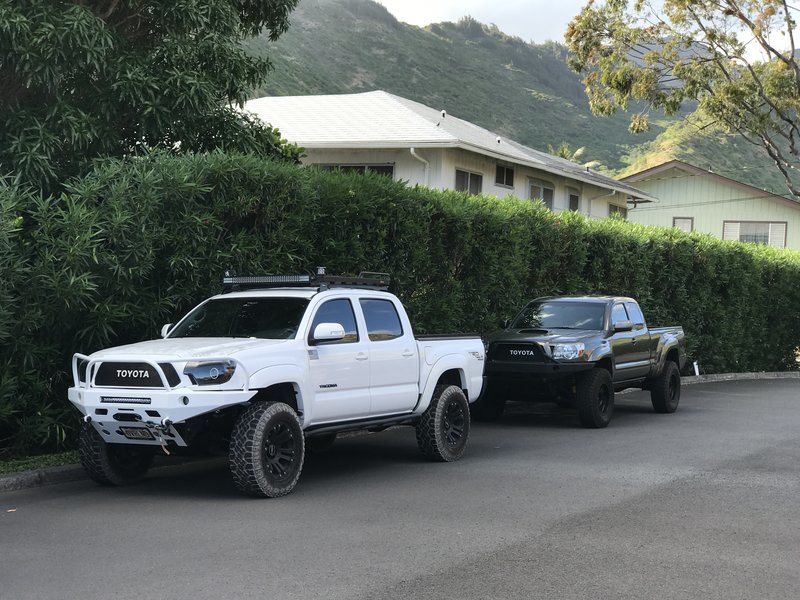

    :D Got a set of FJC steelies and mounted my 37s on them. Truck is a lot smoother now. I love the Hutchinsons, but they just won't work with my hubs :(

    much better :cool:
    I still can feel it trying to death wobble when the steering box is centered while going 40-50mph. But it's much more manageable. I think all the DW made the steering box a little sloppy. All my heims are still nice and tight. When the axle is off the ground, I can shake the tire a little. I just gotta get off my ass and mount the damn hydro assist :annoyed:

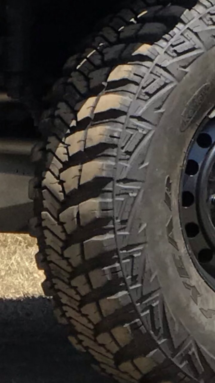

    Oh, update! I rotated the tires. The fronts were pretty cupped so i threw them on the rear. Drove it to work today and zero DW. Truck drove smooth :cool:
    can see how bad there were in the pic above.

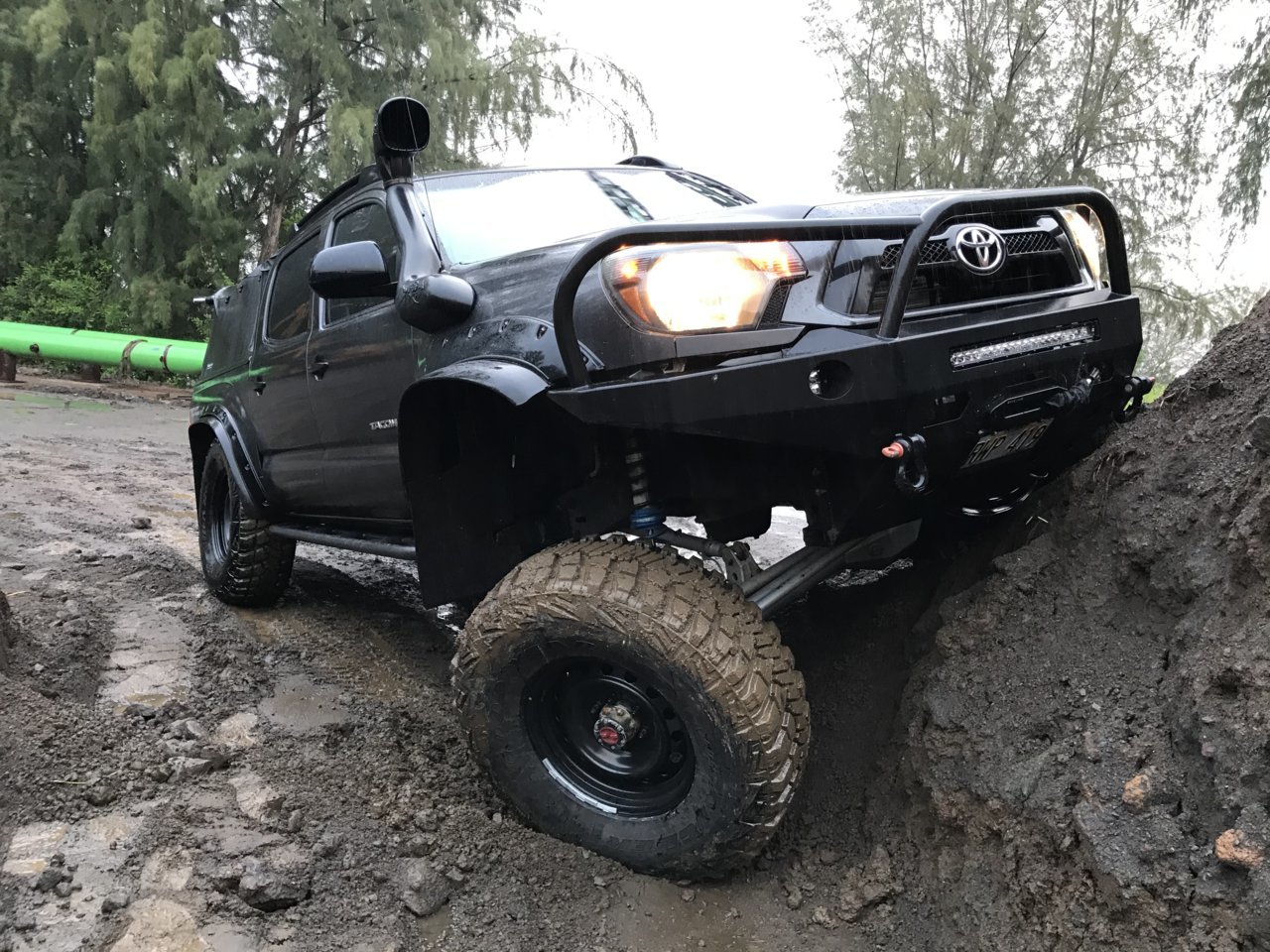

    mad flex yo! :D I think I could have gotten more, but lockers still aren't hooked up :oops: Still stuffing those 37s.
