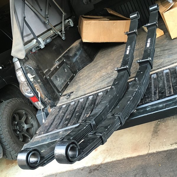

    No alignment yet, but truck handles and rides great. Looks good too, higher stance, and nice rake. Loud thumping did go away, but still hear a thump once in a while, might still have to change wheel bearings. but that's gonna have to wait.

    Cool. Make sure to check over everything after a couple hundred miles.

    Yes I will. Most likely when I do the brake lines or install the longer shocks (gotta get them first though)

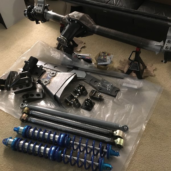

    The pile is getting bigger :D
    Secks...
    All pro standards. Eventually will probably do some rear shock hoops and shackle flip.

    I think the standards will be perfect for a shackle flip because you won't be so ass high compared to the expos. They are nice and plush.

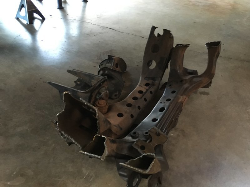

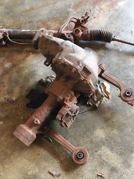

    Started doing what I can until my buddy shows up with a plasma cutter.

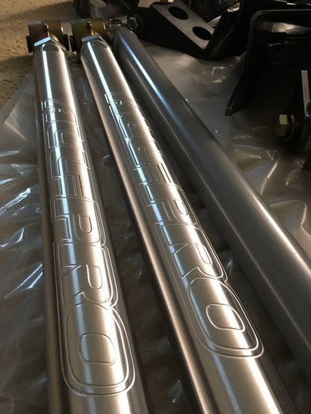

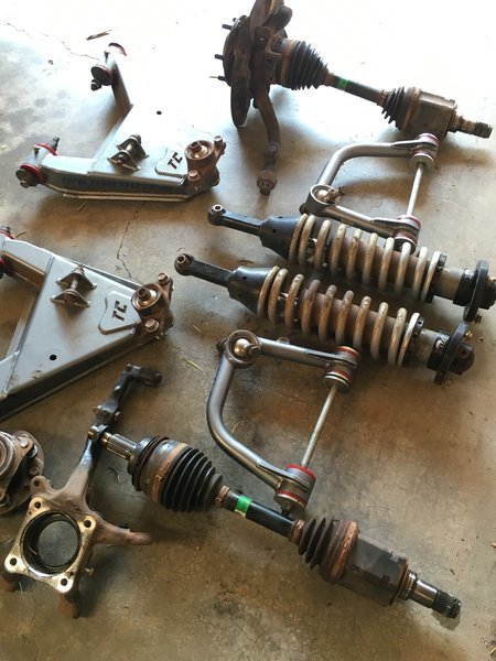

    No more mid travel! Don't ask... Everything is spoken for :p
    And I'm officially a prerunner! :rofl:
    There is a lot of crap to cut off and grind smooth :eek:
    Pirhett, omaguz, mouse007 and 12 others like this.

    How much for the front diff? :rofl:

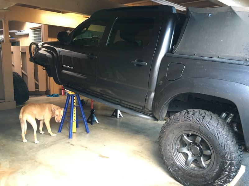

    Should have grabbed my 10 ton jack stands.

    I think it's free for you Jesse...:D

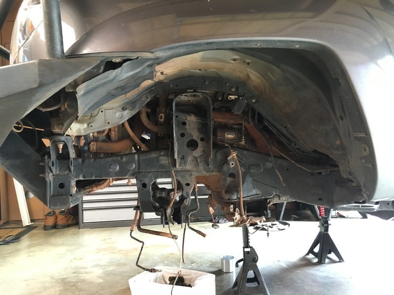

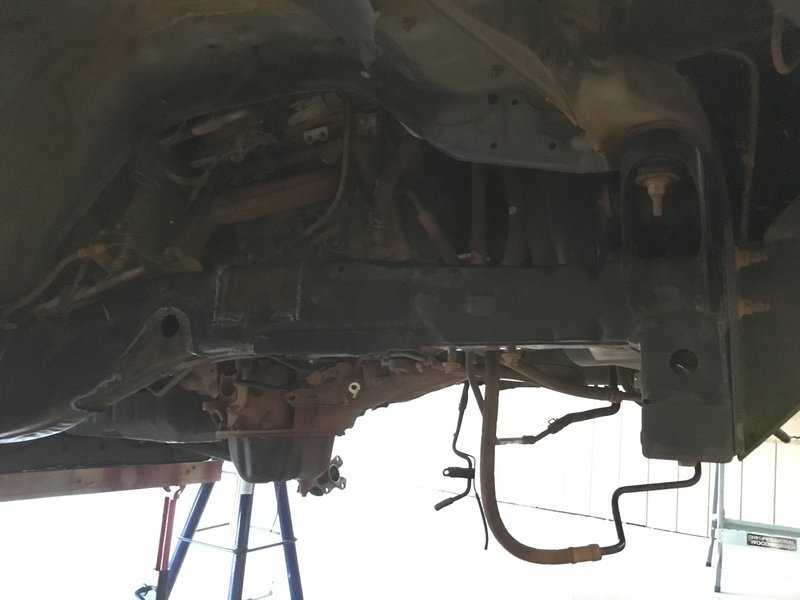

    Past the point of no return. I'm all in now. What makes it worse is that this "kit" won't work with the stock t case cross member, and it wasn't really mentioned anywhere...

    This is when the instructions read :
    Installation is NOT reverse of removal.
    I wonder if all pro designed for the manual trans. Maybe the crossmember is in a different location.
    Good luck, just glad that I can live vicariously through your build.

    Probably gonna have to run the front range off road crossover, and maybe throw in an FJ manual t case and Marlin crawl box while I'm at it... What's another $1500? :rofl::anonymous:
