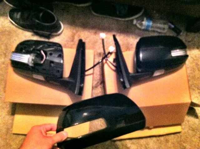

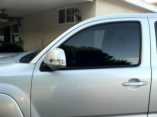

    i guess ill give it a quick update...
    installed 2010+ 4runner mirrors with turn signals and "foot" or "puddle" lights as alot of people call them :rolleyes:
    sent them to get colored matched
    next to stock
    ^^^passenger side swapped

    diggin the mirrors, had the same idea, maybe eventually...now I know who to hit up to wire them up, speaking of which how did you wire them? do the lights just come on with your alarm or something or is there a switch?

    turn signals are wired directly to the turn signal wires under the dash (i have the diagram) with my alarm, the dont blink when i unlock or lock, but with the stock key fob they do
    the "puddle" lights or w/e you want to call them, are wired to the dome light wires on under the dash as well
    those lights only come on when i unlock the truck with my alarm and if i open my doors. if im inside my truck and turn on the dome light from the inside switch, they will not turn on. also the dome light switch can be off and they will turn on if you open the doors.
