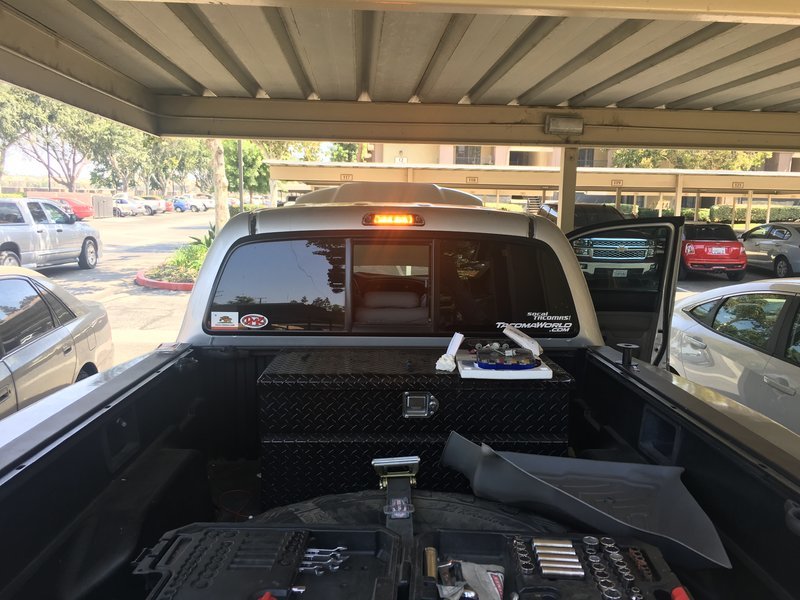

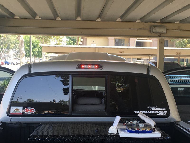

    @Jerez what was that 3rd brake light on your Instagram?
    Jerez[OP] likes this.
  9. Jun 28, 2016 at 4:05 PM
    #1209
    Jerez
    Jerez [OP] SoCal LED Dash Swap
    Feb 1, 2010
    #30488
    17,975
    Rod
    Diamond Bar/Ontario, CA
    08 TRD 2wd converted to 4wd
    Estock
    it is this
    because I wanted to hid my rigid dust light up and away...
    Dr3w likes this.
  10. Jun 28, 2016 at 4:06 PM
    #1210
    Jerez
    Feb 1, 2010
    #30488
    17,975
    Rod
    Estock
    also, had the rear sua installed finally.
    and i cant remember what else i did :anonymous:

    SO how did you do this? I'm a little confused.
  12. Jun 28, 2016 at 4:41 PM
    #1212
    Jerez
    Feb 1, 2010
    #30488
    17,975
    Rod
    Estock
    removed stock 3rd brake light
    cut the cab some
    cut the light bar some
    ran the wiring for the light bar to a switch.
    bought a clear lens 3rd brake light cover and drill 3 holes to add 3 bolt led lights (super bright might i add)
    cut a spare 3rd brake light housing i had so that the rigid bar can shine through 95% of it.
    reinstalled it all and connected the new lights to the stock brake harness up inside the cab.
    alot to do :anonymous: and i might not keep it because i want an aluminum camper shell

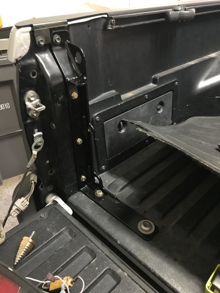

    Installed the total chaos bed stiffeners today.
    Let's see how well they actually don't let the bed much tomorrow on the Mohave rd :cool:

    Estock
    Yea maybe
    Took it out to the desert today and the bed seemed firm compared to before that's for sure.
    Especially with fiber glass fenders there's less weight and support back there
