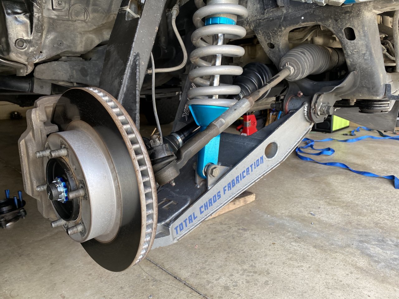

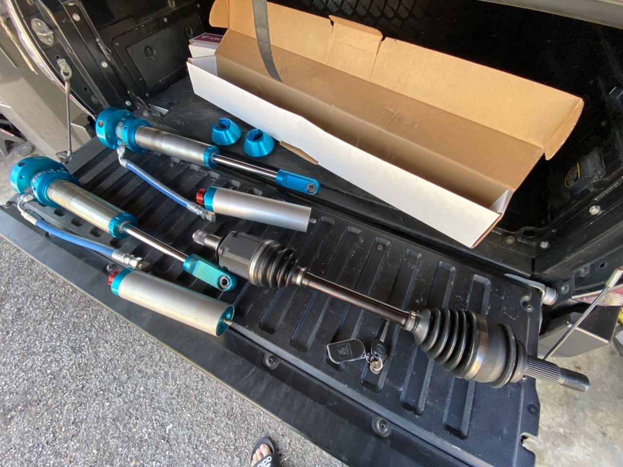

    So updates I guess are in order
    Installed FJ t-case into the truck at the end of feb;
    Got some extended axles and front diff (needs regear) waiting to be installed switch front coilovers to total chaos spec Kings with extended lower rod ends for extended axles

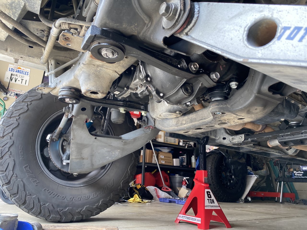

    Well...she’s almost 4wd; yesterday i installed a new to me front diff with 4:56 gearing and front extended tc axles, 4wd hubs and the whole enchilada...
    just need to modify the drive shaft and install the wiring harness I made for the front ADD on the diff and it’s done :woot:
