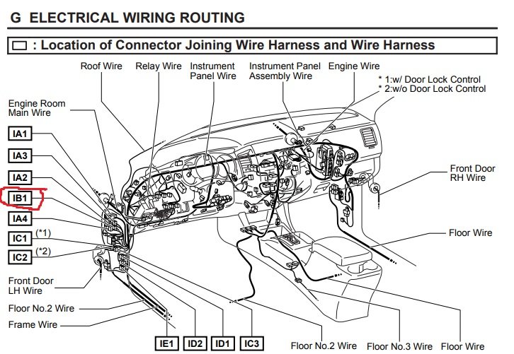

    You may also want to check connector IB1 Pin 8 (Black/Red) behind the driver's side kick panel and make sure it's not burnt.

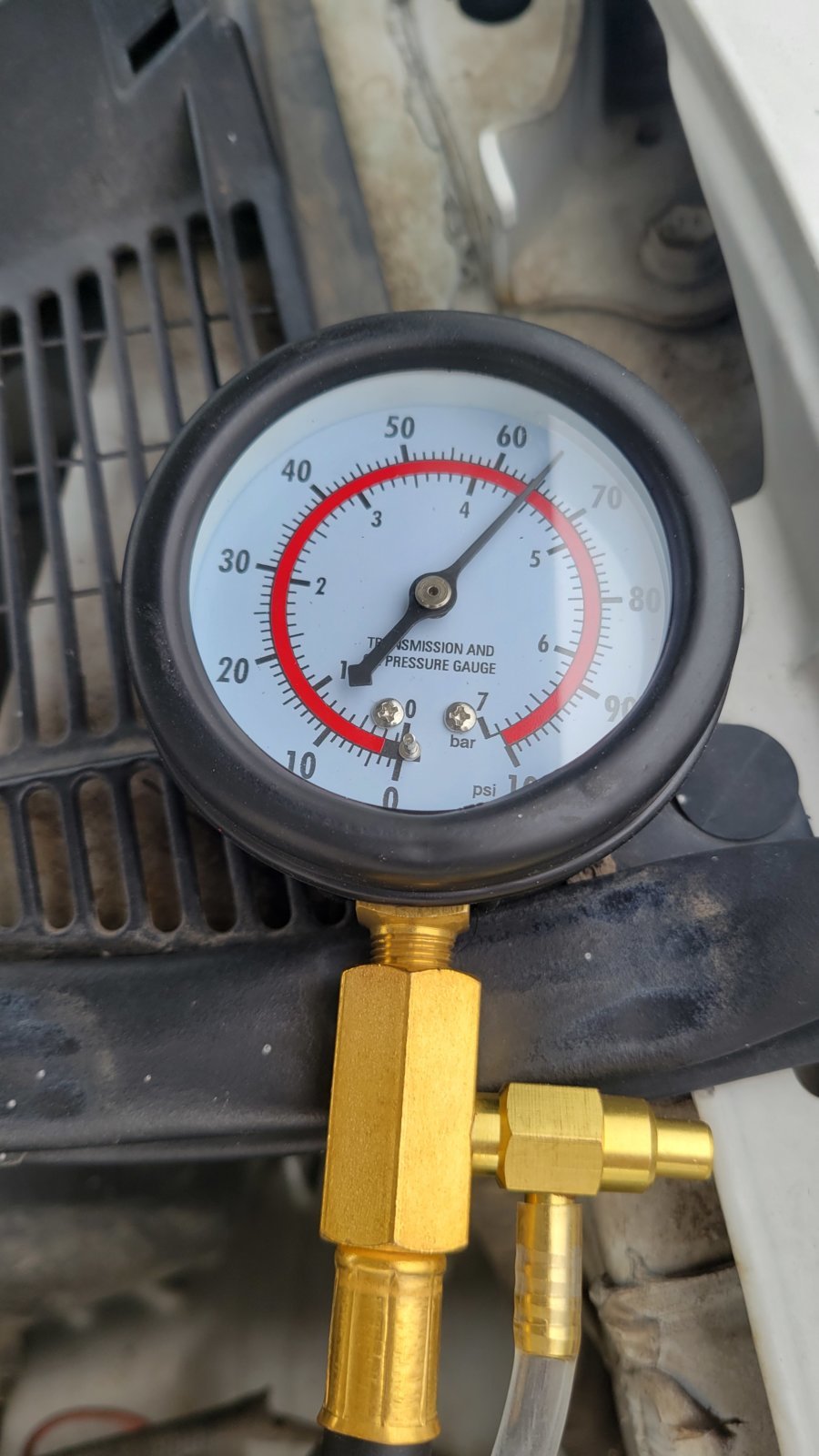

    Tested fuel pressure. Showing about 65psi, which based off my small amount of research seems very high. I let the truck get to operating temps and still above 60psi. Turned off engine, let it sit for 15 minutes to see if there was a significant pressure drop but it remained above 60.
    Pressure regulator on the way out? This is a new OEM pump assembly installed August of 2023.

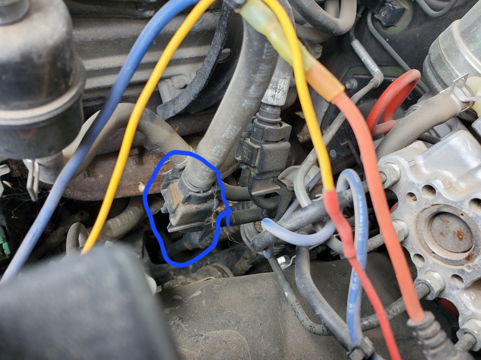

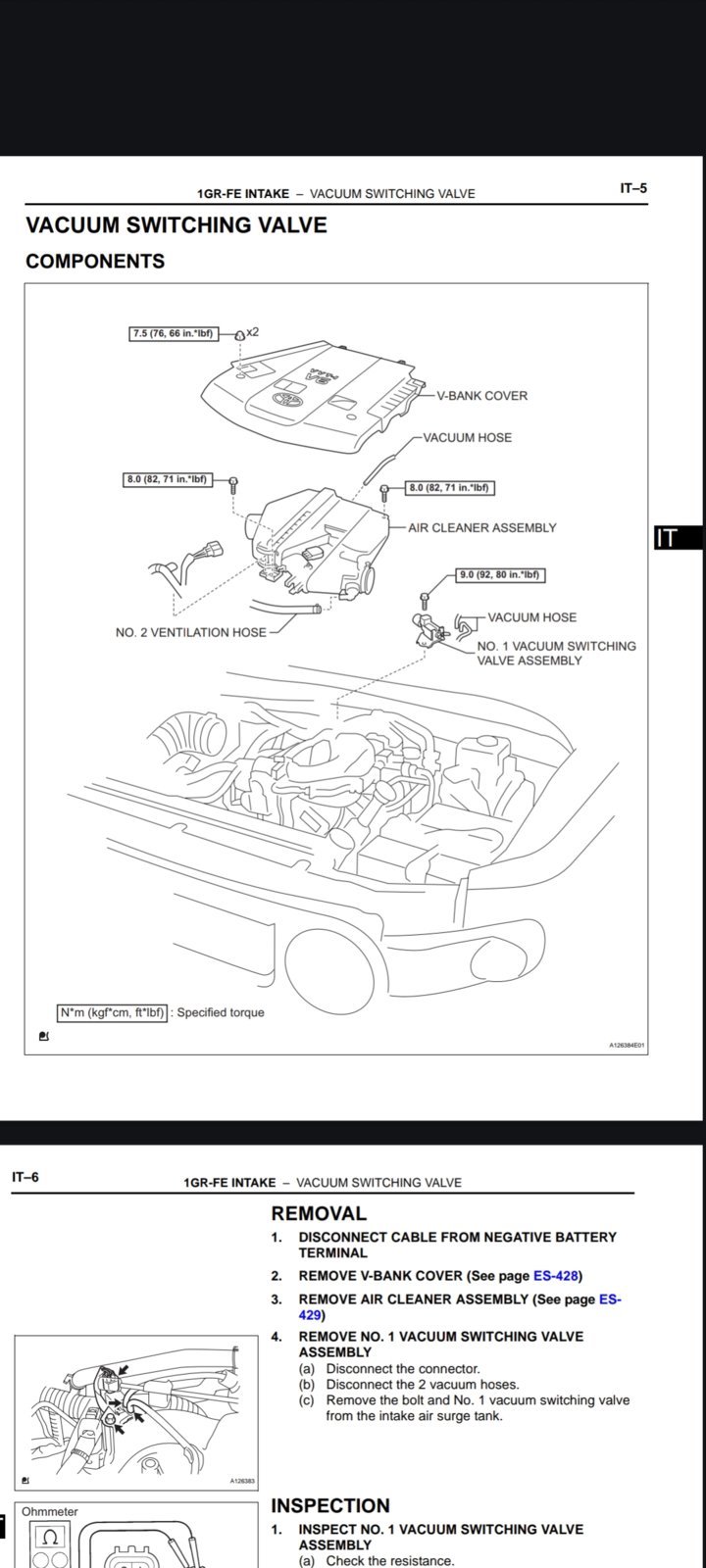

    Maybe a dumb idea, but does that model have a FPR VSV? If it's not opening, that can cause warm start issues.

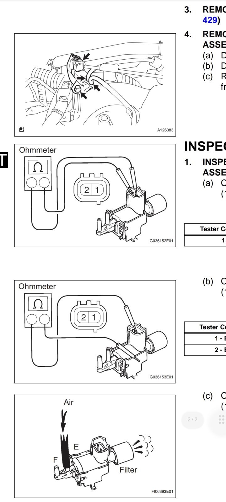

    If you mean this little guy? I actually have a new one of those I was going to install, it's sitting in my shed. The parts cannon is loaded, ready to fire haha.

    2nd gens don't have a VSV for the regulator, they use a 2 speed fuel pump.
    That valve is for the ACIS (intake manifold runner control) it won't affect starting.
