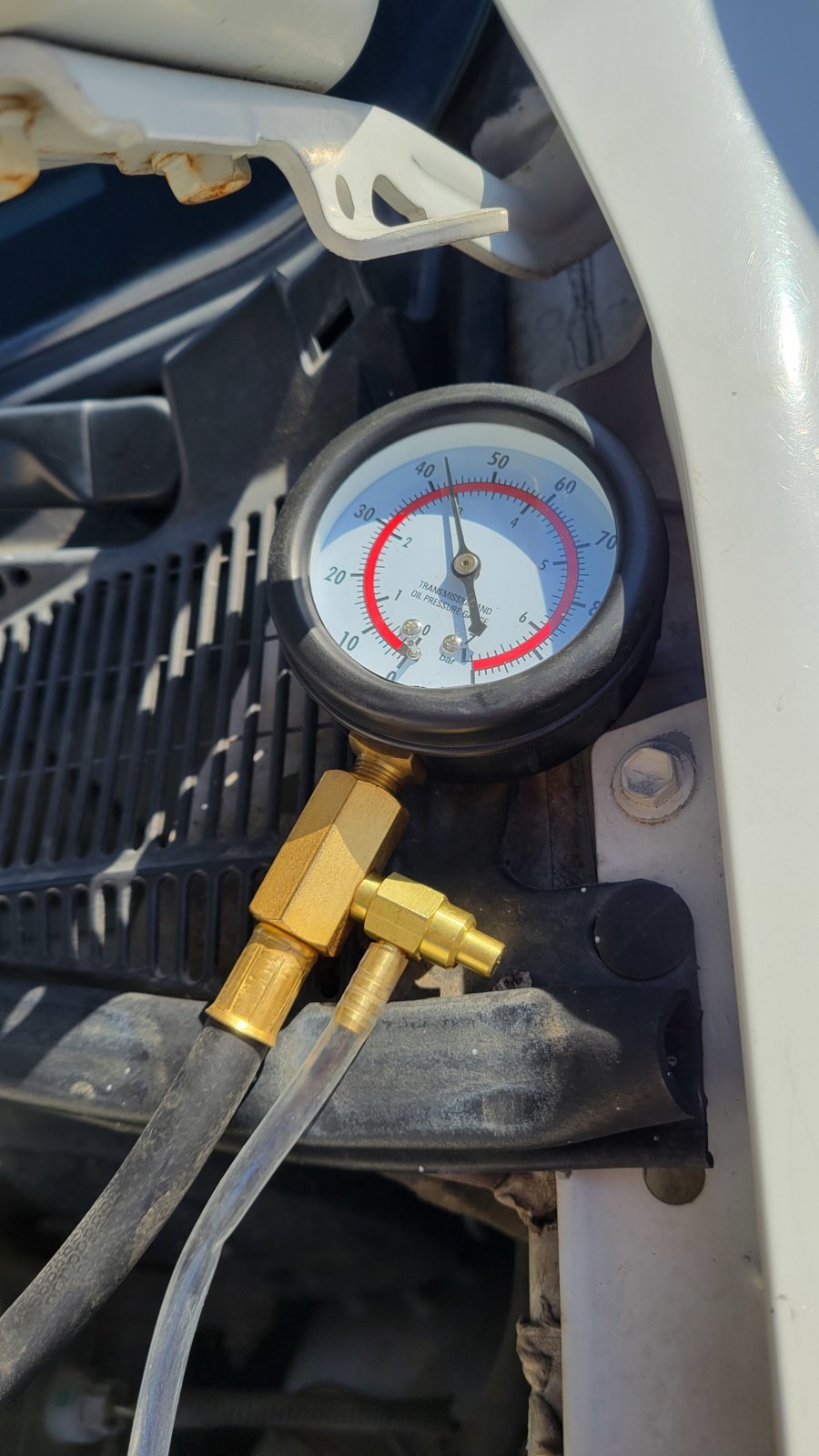

    New fuel pressure regulator brought it back down around 40psi, much closer to stock. Truck feel like it's driving a bit smoother now, throttle does not seem as touchy. Time will tell if this was the culprit for the no start.
