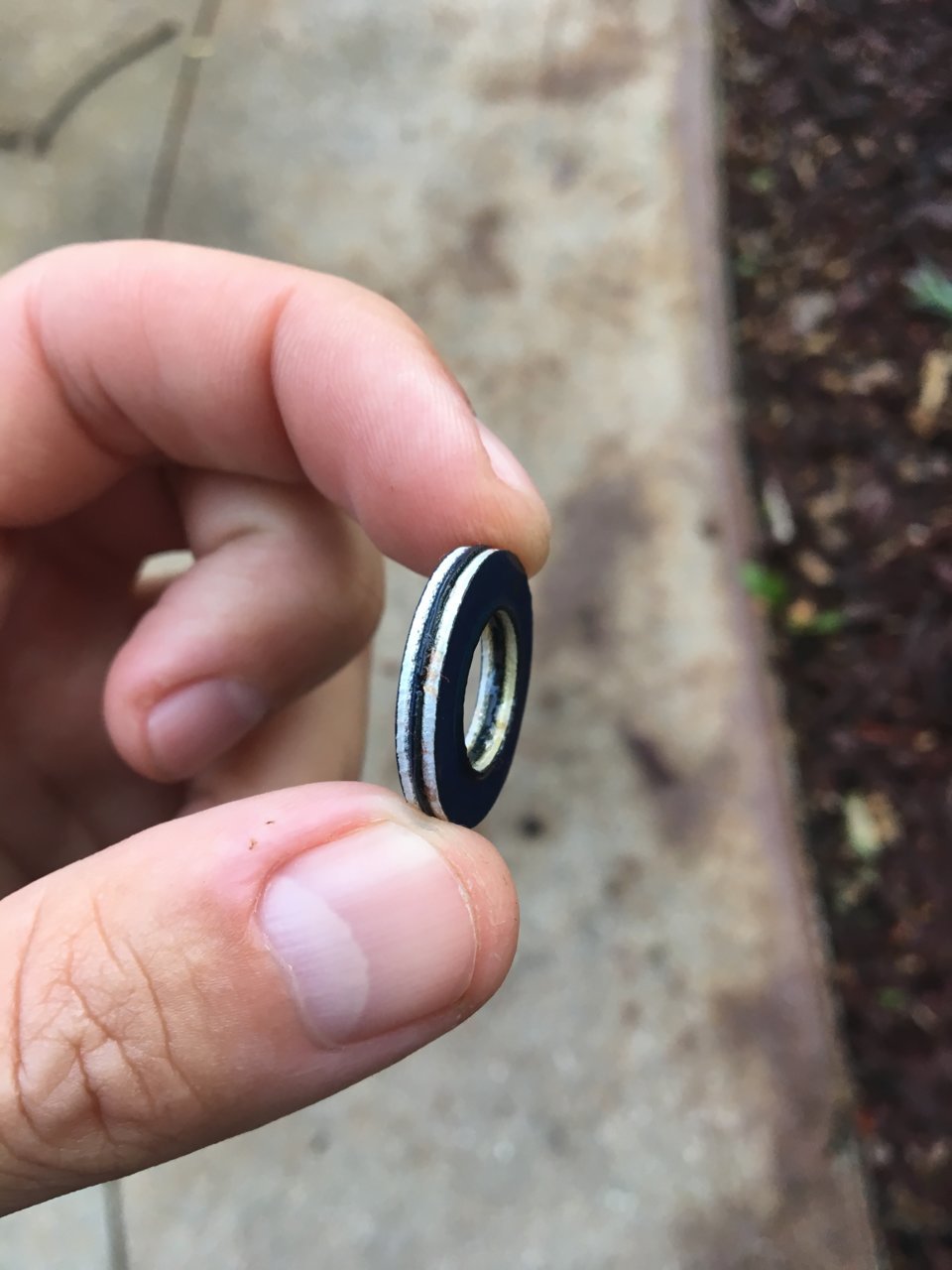

    Just drained the oil...a double washer stack came off with the plug. I can’t even get them apart, they’re melded. Thanks to those who predicted this!

    I posted the below before I read that you found we were correct. Glad you got it sorted.
    I posted a picture of a Tacoma 6 cylinder 1GR Oil Pan.
    There is no flange as can be seen quite plainly on the posted image.
    I have had mine stuck on the pan numerous times on all of my Toyota vehicles.
    You can remove the oil drain plug without draining the oil by using a shop vacuum on the fill tube.

    Thanks for this post because my dumbass been fighting an oil leak for two days and come to find out what I thought was a FLANGE where the crush washer sealed to end up being the old crush washer and in and doubled washered the drain plug and glad I found this post because it was kicking my ass lol

    This just saved my night, doing a quick oil change in the dark, forgot to put washer on. There must of been a double washer and one stuck because i definitely have a bronze colored flange still on oil pan. I’ll still double check tomorrow but at least I’ll be able to sleep tonight.

    Actually to clarify, I didn’t forget it I thought it was still on until I crawled out from underneath and saw it still sitting there.
