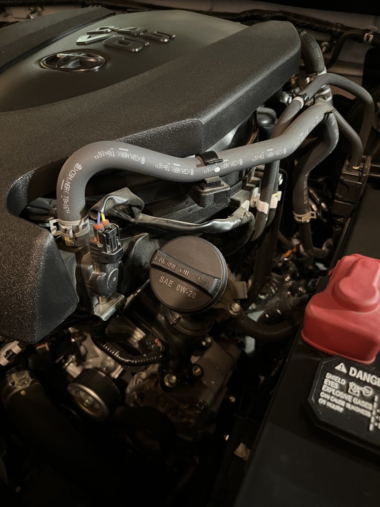

    To clarify, after the latest oil change I checked and ensured the filler cap was in place and was tight. 300 miles later, it's gone. Other people have posted about having the same issue so I'm convinced it's an issue on certain trucks.

    I picked my Tacoma up from the dealership this afternoon. Unsurprisingly they found nothing wrong and simply replaced the cap. I was told that if this new one comes loose, or disappears again, to come back and they will look into replacing the filler neck. I'm going to keep a spare cap around and check it weekly going forward.

    Toyota Parts Manager here.
    There is def something going on with the caps, but Toyota themselves haven't "officially" acknowledged the issue.
    We noticed a few customers coming back and complaining to us about caps missing and we reimbursed/replaced them and gave the techs crap about it but by the third or fourth in a row and all being Tacoma we became suspicious that there is something going on. Then my wholesale customers (independent shops) started buying them and writing them off we started telling them to go easy on their own techs as it seems there's something deeper going on.
    We ended up reaching out to the Toyota Field Service tech and asking him about this and he says he has heard rumblings but they didn't have enough evidence, and I suspect it's because most stores were blaming it on the lube techs and writing them off to policy. Plus, they never had any to look at as they all "vanished". Our techs were now on the hunt for suspicious feeling oil caps and we found one that wouldn't tighten, Kinda felt like a gas cap where any torque would spin the threaded portion of the cap free from the head. We swapped it our for the customer and held it here for Toyota. Then one of our service advisors had the issue happen to him and the Toyota FST requested we replace his oil filler neck as well and hold it here for him. They just picked up these 2 parts yesterday. It seems they are researching the issue and I'm sure they will find something. The perfect situation would be to retrieve a cap that has fallen off but so far none have come back.
