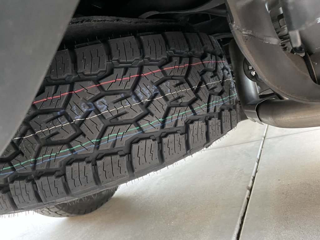

    What's the deal with the spare tire carrier, how do you fix it?

    It puts a dent in the sidewall. Crank it down when you get a chance and take a look. Easier than explaining it and you should crank it down at least once per year anyway to check for cracks and a rust-welded chain and hoist mechanism. :eek: :proposetoast:

    My fix was a rubber stall mat from tractor supply trimmed to fit the tire. Sandwich that between the tire and the cradle and you're good to go.
