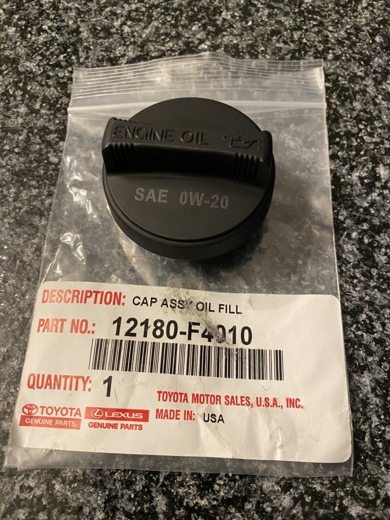

    Doesn’t exactly look like a $50 part, but here’s the part number for future missing caps. Parts guy did need my VIN because there are apparently a few different part numbers for the caps though.

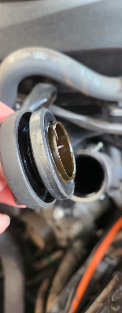

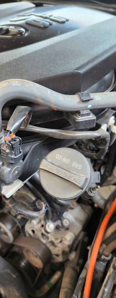

    Barsoom and HondaGM like this.
