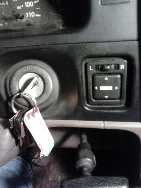

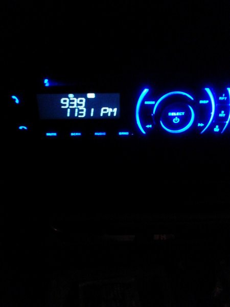

    I hated the position of the factory clock, as a lot of you do. So I replaced the stock radio with an aftermarket one that has the clock built in. I pulled the clock-delete panel out of my parts truck and mounted a power mirror switch where the clock used to be. Killed two birds with one stone... got rid of the stupid clock and now my power mirrors work!

    This looks nice. What all was needed to add power mirrors?

    2001-2004 power mirrors are a direct replacement. The switch is out of a 97 Camry. Clock delete panel is out of a 95 Taco. I got the info from the following thread.
    https://www.tacomaworld.com/threads/how-to-replace-95-97-side-mirror-with-a-01-04-mirror.172052/
    I used this wiring diagram for the switch color codes.
    http://www.justanswer.com/toyota/50...ted-wire-harness-wire-flatwhite-w-splice.html
    The wires on the mirrors are red-common, black-up/down, brown-left/right.
