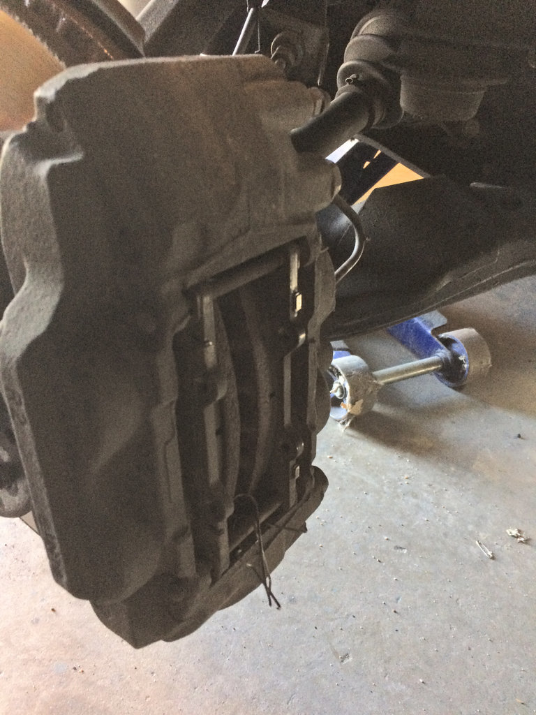

    I was getting a noticeable clunk after letting the brakes off and starting out. As the weather warmed up and I had the windows rolled down more often I noticed a metallic rattle that would stop with any pressure on the brake pedal. When I got around to inspecting it I noticed the anti-rattle spring was snapped. I ended up doing a complete brake job but replacing this $3 spring (Toyota part number is 04947-0C010) would have fixed it. FWIW the factory only puts them at the bottom of the pad but when I rebuilt my brakes I put them at both ends.

    Yes, I forgot about saying I read about that also. I recently purchased 4 new retainer springs from Toyota and will be putting those on as well. Did it solve your clunk?

    New springs did make the brakes stop clunking. I couldn't tell you if two are really necessary since I had one and it was broken. I don't see how it can hurt, older Toyota trucks (mine was a 1991 previously) had two springs.

    I put two on each side also. Cheap insurance, imo.

    My guess is that one works fine when everything is new, shiny and has some grease still. After a while one is no longer enough when the pins get corrosion and dirty.

    cool thanks, im gonna start with just the springs (2 new on each side)

    The logic is that 95% of the time you are stopping going forward, so the springs at the bottom hold the pads in the forward rotating direction. That way the pads aren't moving up and down every time you step on the brakes.
