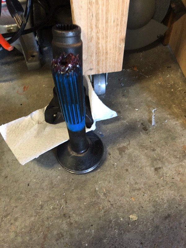

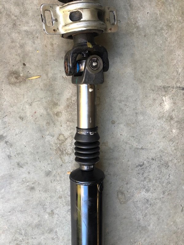

    Nah most of these trucks have the clunk. It's a design flaw due to non greasable yoke, paired with really weak leaf springs that allow too much axle movement. In the past I have unbolted the carrier bearing, pulled the two driveshaft pieces at the yoke out as far as I can, and apply the ford moly grease. It's a lazy man's cure but I didn't have to unbolt the entire shaft and the clunk went away for a few months. Came back later though.

    The slip yoke on our trucks doesn't have a grease fitting so it's not an easy thing to maintain. I personally never greased mine and by about 95k it had worn enough that grease didn't help for more than a few miles. It just gets displaced and the clunking starts again.
    As I chased it down I ended up having a new slip yoke put in my driveshaft. But I'd also replaced all my u-joints and the carrier bearing. In my case I think the carrier being completely worn and shifting around was the primary source of the clunk but the yoke was bad enough that the shaft wobble made effective balancing impossible.
