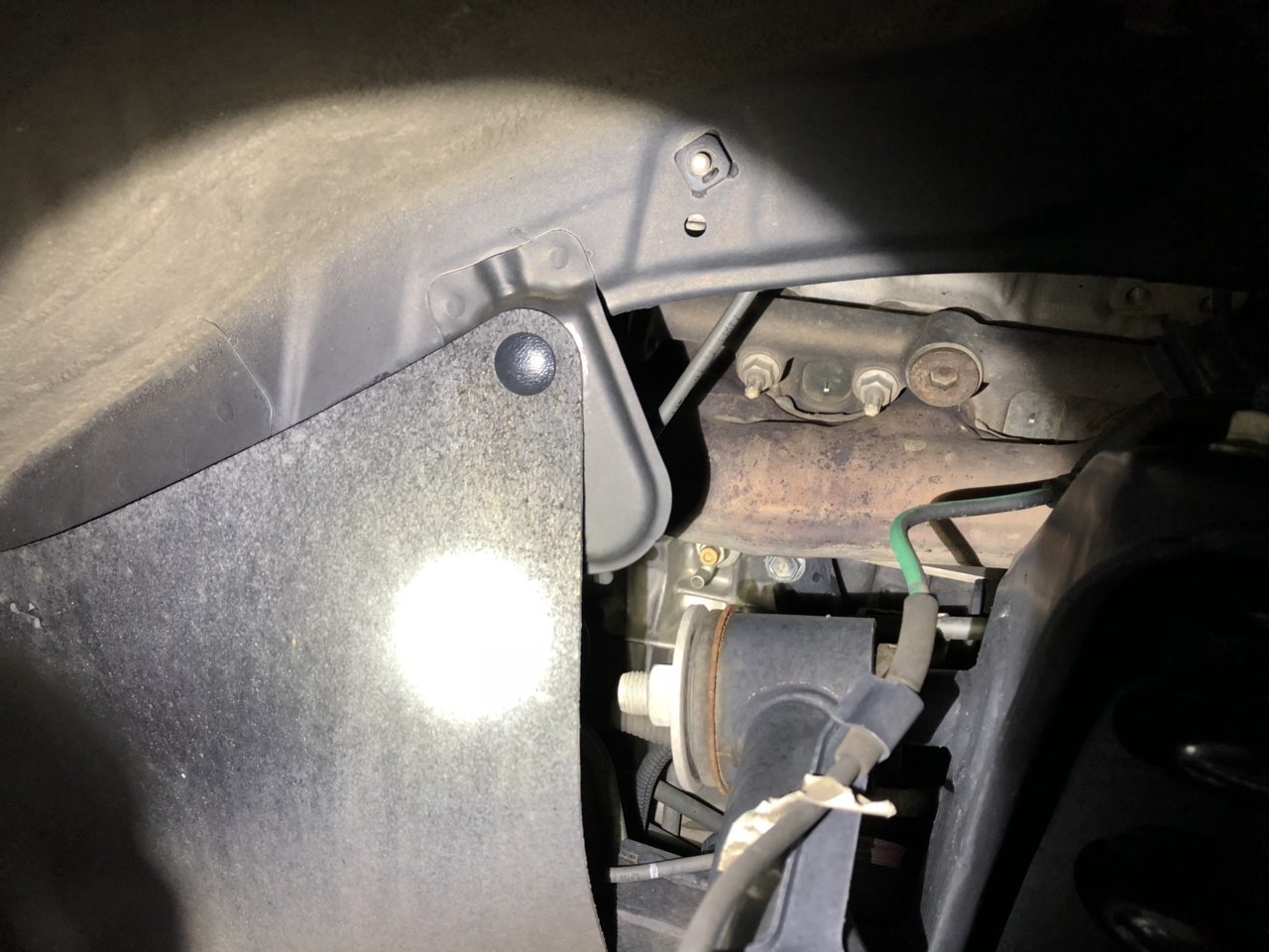

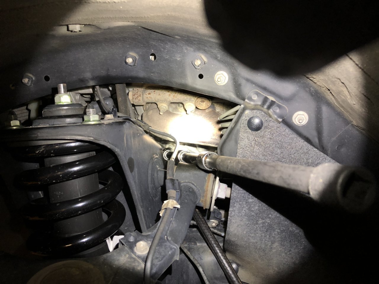

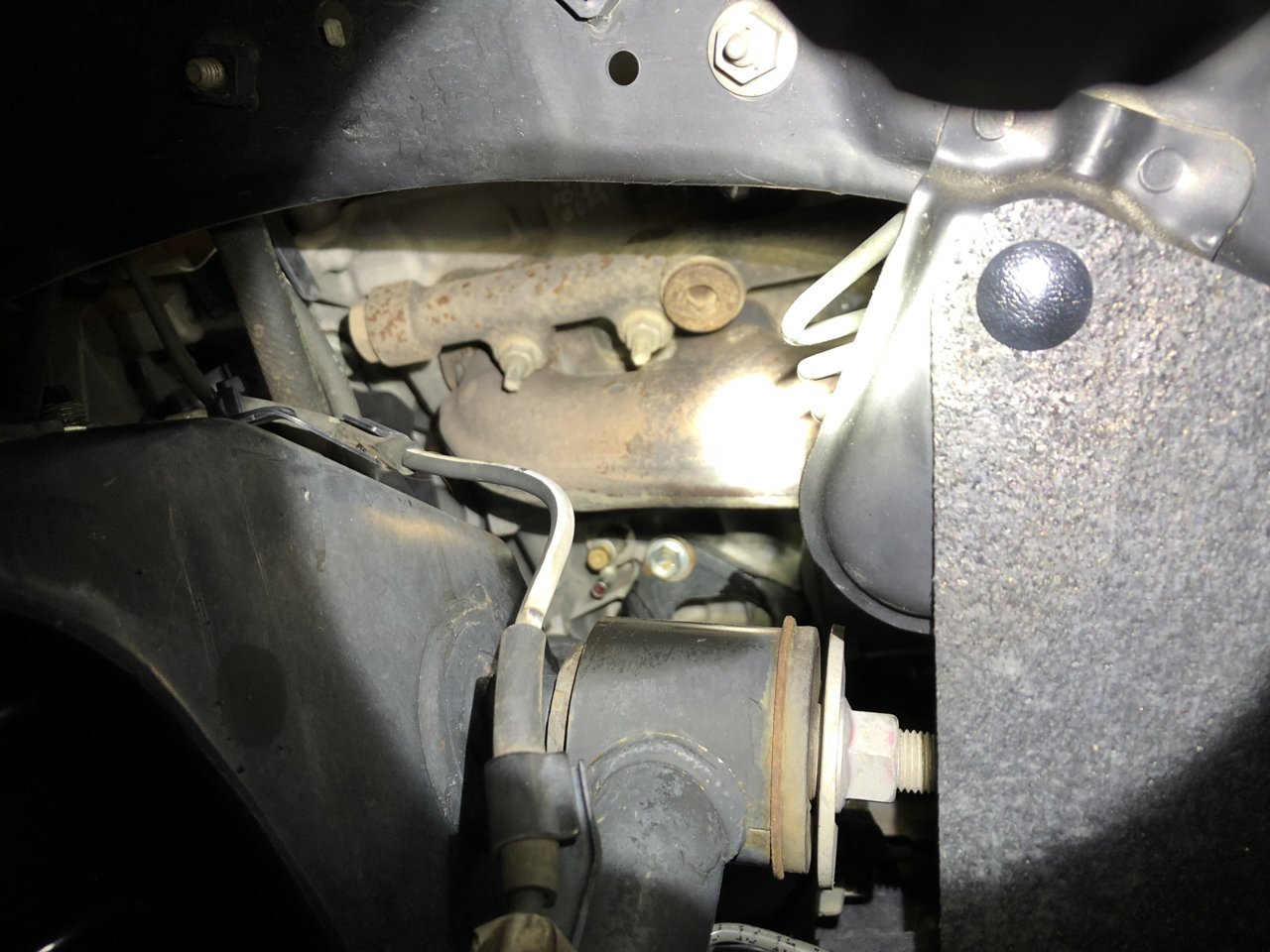

    For reference for anyone getting ready to do this - I had a tough time finding the drivers draincock from underneath the truck, but both sides are easy to get to through the wheel wells.
    Both drains are just to the left of the motor mount as you look at them, so the DS is toward the front of the vehicle, and the PS is to the rear.
    DS
    PS
    You can reach in through the opening in the liner to attach the 1/4” hose to the drain (working by feel)

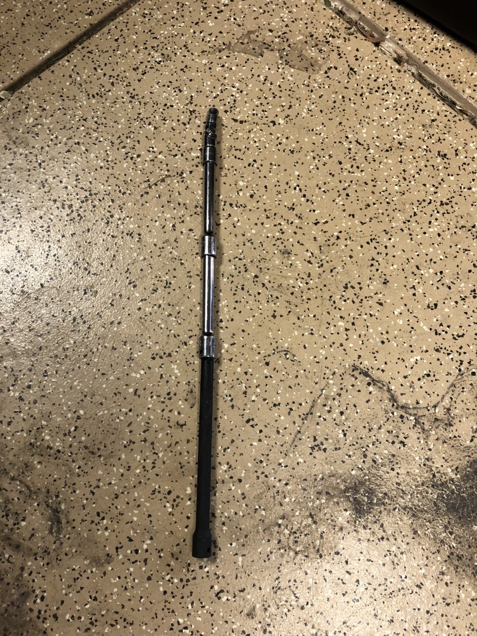

    I found the best way to open the draincock is using a 3/8 drive 10mm socket on a 3/8 universal with multiple extensions so you can ratchet from inside the wheel well

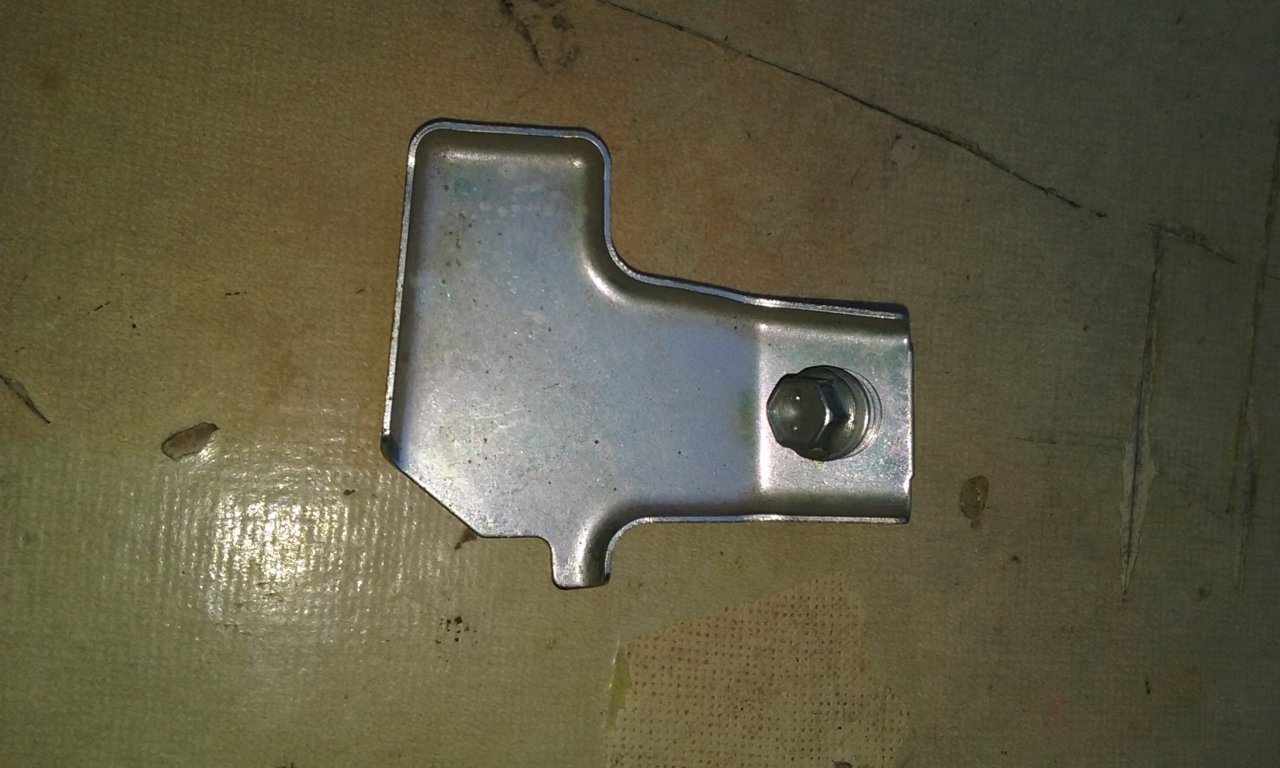

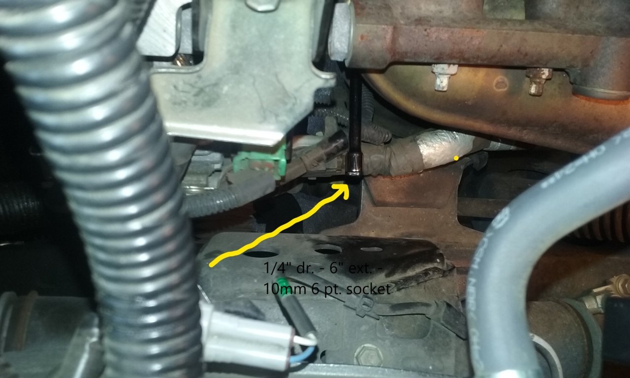

    Another approach:
    I access drivers side eng. block drain plug from the top. Remove small silver bracket in order to provide your arm better access for reaching in & feeding the extension on to the drain plug:Small slver bracket drivers side.jpg Access Drivers side engine cooland drain plug_LI.jpg

    What the heck is the "small silver bracket" for? It doesn't look like it does anything in my truck

    @k5driver It appears to divert liquids flowing downward away from the alternator.

    5. The driver’s side drain was hard to get to. I put the socket and universal joint on first. Then the extensions separately. Otherwise I couldn’t get it on the drain bolt in one single piece
