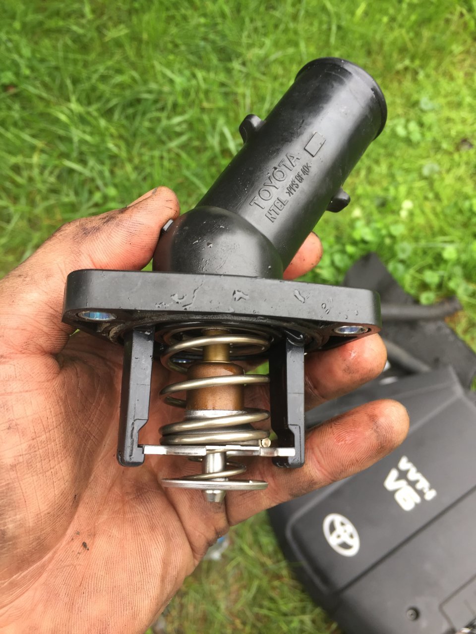

    I did my thermostat at 130k, it looked great (see pic). Def didn’t need to be replaced. But, it was $30 for a OEM part and easy to install, so I changed it out. I also replaced the upper and lower hoses with Gates hoses. I also replaced the radiator cap since I was on a roll.

    Thanks for the reply. Yeah, your thermostat looks excellent. I definitely don’t remind replacing it, but if it doesn’t necessarily need it, at this point it will just be preventative maintainance.
    Have you heard of thermostats going bad after the first initial coolant change? My radiator hoses don’t show any signs of wear other than being dirty.

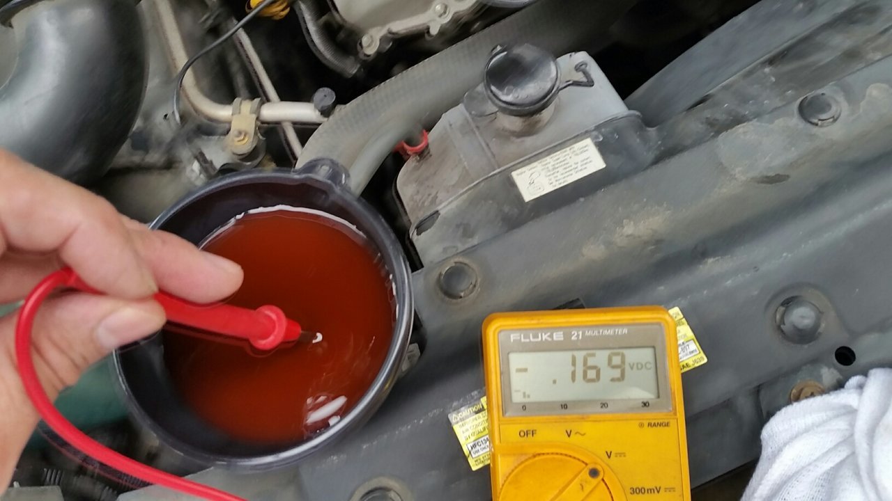

    I know this is an old thread folks so bare with me, I posted a few years back that that I had 10yrs and 160k miles on my truck with the original factory coolant. Now it's 13 years and 213K miles with still original factory coolant and thinking about replacing my coolant for the first time. I read about electrolysis and it stated it needed to be .300 dc volts(300milli volts) for electrolysis to occur. Here is what I found in mine, .169 dc volts with no issues and truck drives flawless still. ORIGINAL FACTORY COOLANT AND 13 YR OLD TRUCK. I still say that you folks changing your coolant at 60-70k are wasting your time & $$.

    .3v+ requires immediate attention. .1v to .3v shows electrolysis activity.
    As has been pointed out, there are other factors to consider. It only costs about $25 to get two concentrated SuperTech universal coolant bottles to replace the OEM coolant. Surely, your truck is worth it. Especially considering 05-06 models have higher rates of head gasket failure than normal.

    where did you get those numbers from? .1-.3 I read that all trucks , even the new coolant will read .1 mine showed .165 even after 13 years.
