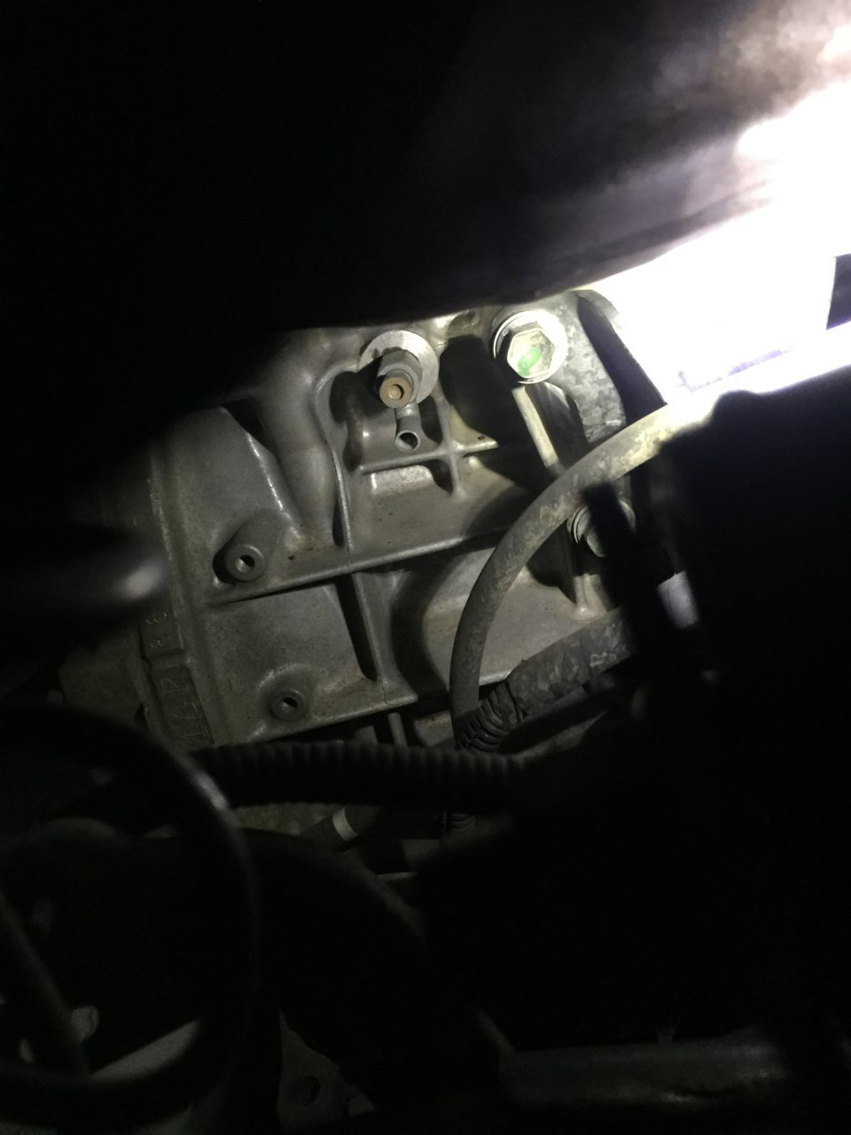

    Anyone got a pic of the block drains?

    Passenger side block drain. Should look the same on the Driver side.3F8E5EDE-AEEB-41A0-BDB0-A8F1EAC436DF.jpg

    Left or right?

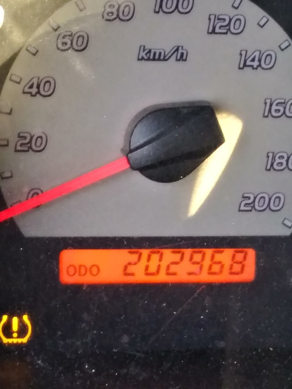

    I'm at 203,00020200306_173731_HDR.jpg . Coolant was swapped at 100k I'm the second owner. The coolant is still bright pink just like the new. Should I think about flushing it again? I thought this coolant was supposed to be longer lived?

    Yea, it's probably about time. The coolant wont discolor, but the properties will still break down.

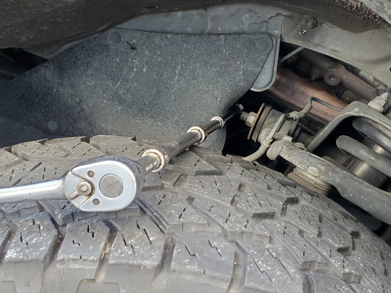

    If you remove the black side skirts in the wheel wells, you'll see the cocks straight ahead. If you have a lift, you wont have to remove the tires to slide some extensions in there to loosen the cocks.

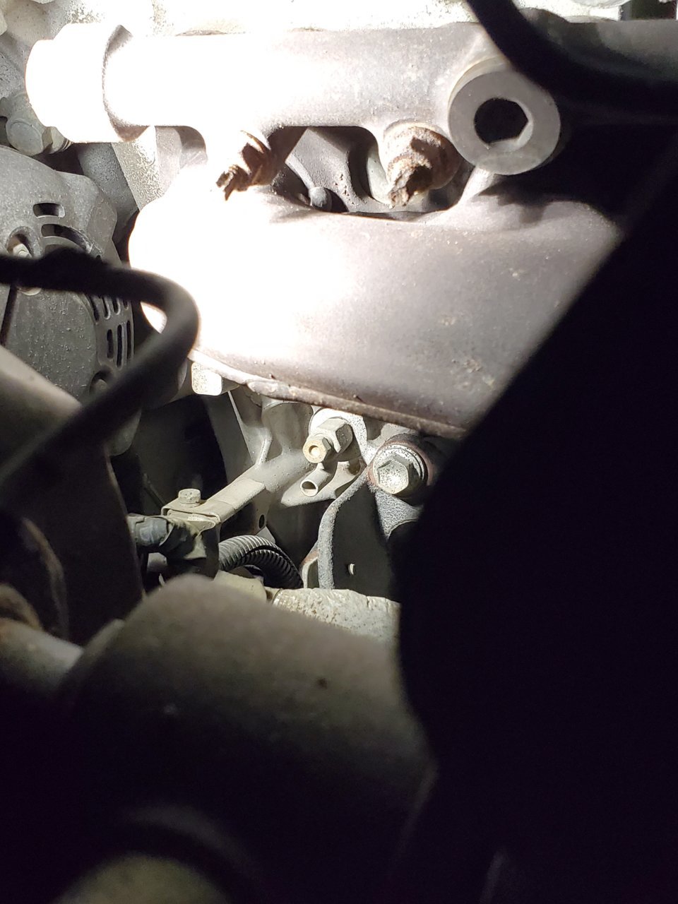

    Here is a picture of the driver side block drain that the OP claims doesn't exist:
    As seen from the wheel well. Probably easier accessed from under the truck. I tried slipping some 3/8" ID hose on there and it's too big. 1/4" is a good snug fit. You might be able to get away with 5/16" ID as well.
    Update: Did the job last night. 1/4" fits on the block drains but I had to stretch it out a bit. I'm thinking 5/16" would be a better fit.

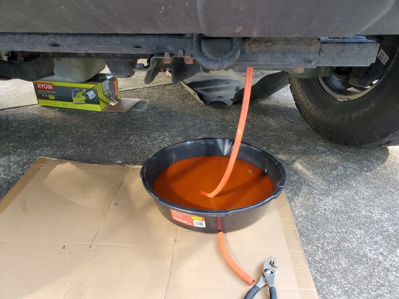

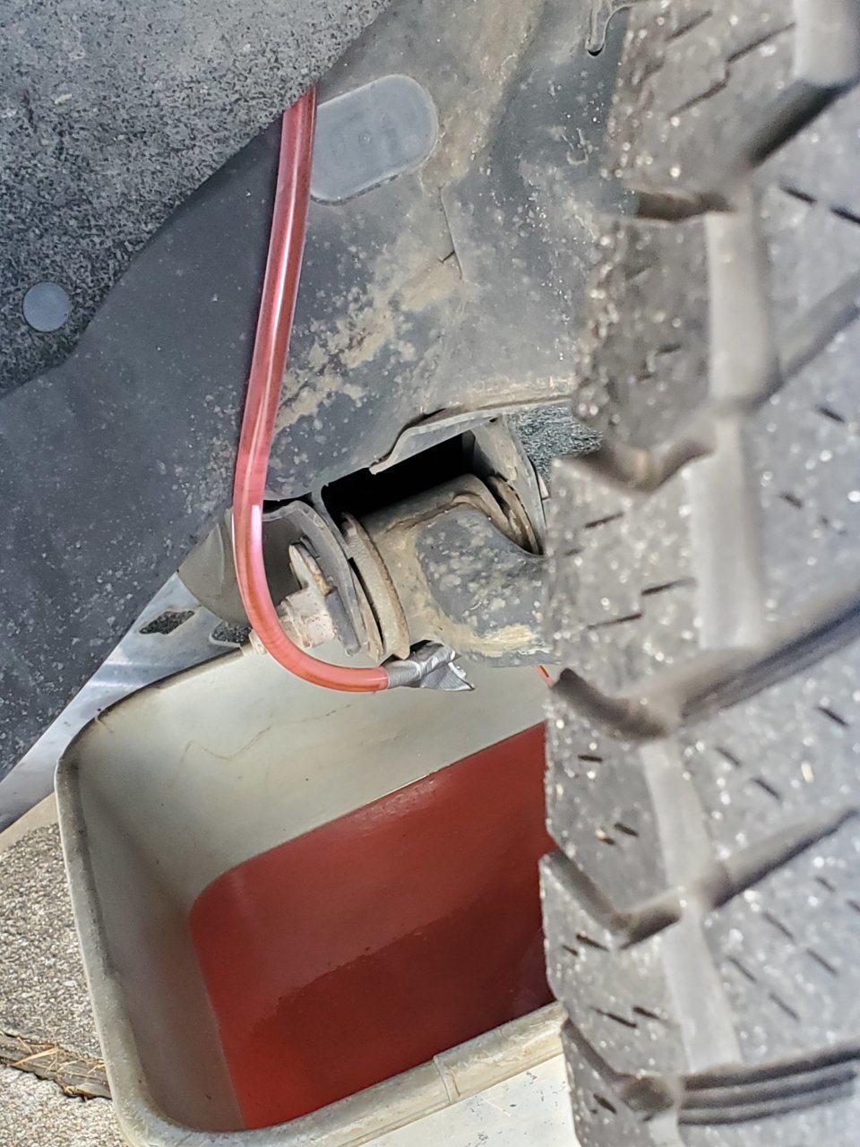

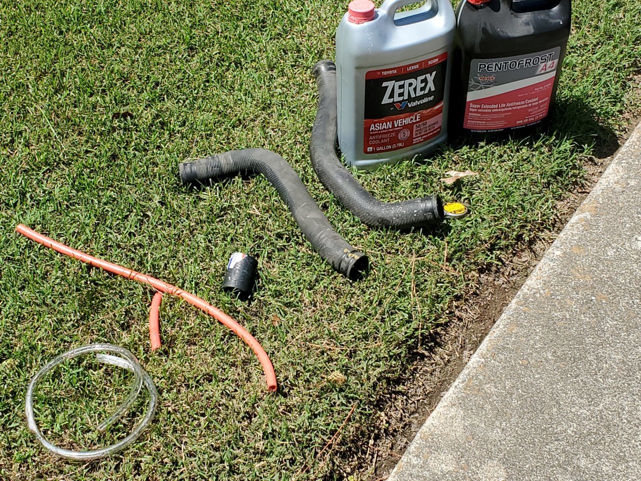

    Bought a 2012 with 140k on it. Keeping parked, even though it runs fine, until maintenance is up to snuff. So far, found it had factory front brakes, factory spark plugs and, I believe factory coolant, hoses, transmission fluid and differential oil. Been working on it to bring it up to date such as new plugs, brakes, serpentine, cleaned maf (throttle body soon), covered the worn seats. Doing differential tomorrow and then off to the dealer for a full 13 qt transmission service. Today I tackled the engine block and radiator coolant with new hoses and a radiator cap. This thread made everything simple. Pulled 2.2 gallons out of it, drained the reservoir, replaced upper/lower hoses and put a new cap on it. Only drained block from passenger side because I read that side drains more than drivers side. Had about 1-1/4 gallons of Pentofrost and a gallon of Zerex. I know the pix are repetitive so will only post a minimum. For reference I had a 30 inch extension setup to open the passenger side drain valve. Easy peasy.
    20210713_085815.jpg 20210713_085833.jpg 20210713_085838.jpg 20210713_113508.jpg
