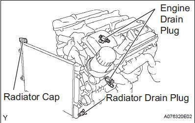

    From 2006 service manual.
    1GR-FE COOLING – COOLANT CO–3
    COOLANT REPLACEMENT
    1. DRAIN ENGINE COOLANT
    CAUTION:
    To avoid the danger of being burned, do not remove the radiator cap while the engine and radiator are still hot. Thermal expansion will cause hot engine coolant and steam to blow out from the radiator.
    (a) Remove the service hole cover from the engine under cover.
    (b) Install a vinyl hose onto the drain on the radiator side.
    (c) Fix the vinyl hose with tape.
    (d) Loosen the 3 drain plugs on the engine and radiator, and drain the coolant.
    (e) Remove the radiator cap.
    (f) Drain the coolant from the reservoir tank.
    (g) Tighten the 3 drain plugs.
    Torque: 13 N*m (130 kgf*cm, 9 ft.*lbf) for the engine
    (h) Remove the vinyl hose from the radiator.
    Capacity
    Manual Transmission 9.7 liters (10.3 Us qts, 8.5 Imp. qts)
    Automatic Transmission 9.8 liters (10.4 Us qts, 8.6 Imp. qts)
    HINT:
    • Use of improper coolants may damage the engine cooling system.
    • Use only Toyota Super Long Life Coolant or similar high quality ethylene glycol based nonsilicate, non-amine, non-nitrite, and non-borate coolant with long-life hybrid organic acid technology (coolant with long-life hybrid organic acid technology consists of a combination of low phosphates and organic acids).
    • New Toyota vehicles are filled with Toyota Super Long Life Coolant (color is pink, premixed ethylene glycol concentration is approximately 50 % and freezing temperature is -35°C (-31°F)).
    When replacing the coolant, Toyota Super Long Life Coolant is recommended.
    NOTICE:
    Do not substitute plain water for engine coolant.
    (b) Check the coolant level inside the radiator by squeezing the inlet and outlet radiator hoses several times by hand. If the coolant level goes down, add coolant.
    (c) Install the radiator cap securely.
    (d) Slowly pour coolant into the radiator reservoir until it reaches the FULL line.
    (e) Warm up the engine until the cooling fan operates.
    (1) Set the air conditioning as follows while warming up the engine.
    Item-------------Condition
    Fan Speed-------Any setting except OFF
    Temperature-----Toward WARM
    Air Conditioning---Switch OFF
    (2) Maintain the engine speed at 2,000 to 2,500 rpm and warm up the engine until the cooling fan operates.
    (f) Squeeze the inlet and outlet radiator hoses several times by hand while warming up the engine.
    (g) Stop the engine and wait until the coolant cools down.
    (h) Remove the radiator cap and check the coolant level inside the radiator.
    (i) If the coolant level is below the full level, perform the steps from (a) through (h) and repeat the operation until the coolant level remains at the full level.
    (j) Check the coolant level inside the radiator reservoir tank again. If it is below the full level, add coolant.
    3. CHECK FOR ENGINE COOLANT LEAKAGE
    (a) Fill the radiator with coolant and attach a radiator cap tester.
    (b) Pump it to 118 kPa (1.2 kgf/cm2 17.1 psi), then check for leakage.
    [​IMG][​IMG]

    I can also confirm the 4.0 has a drain on both sides of the block, it did on my 2006 and does on my 2012.

    I changed my coolant in november, and yes, there were two (2) block drains, exactly where pictured in the diagram. I drained the rad and pass side block drain first, then drained roughly one more litre (quart, whatever) from the drivers side block drain. I can see why guys have missed it, its well hidden, but they're both there.
