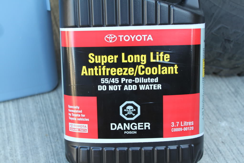

    You will need about 7.8 litres of Toyota Super Long life coolant = 2 jugs. Part # C0009-00120-wa
    Here is the coolant we use:

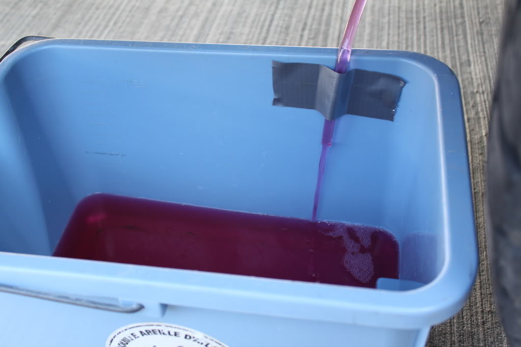

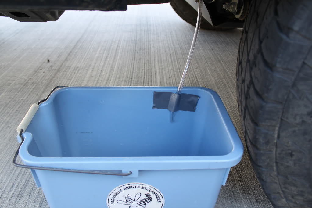

    Tape some 3/8" O.D. line to a 14 litre bucket and position under truck:

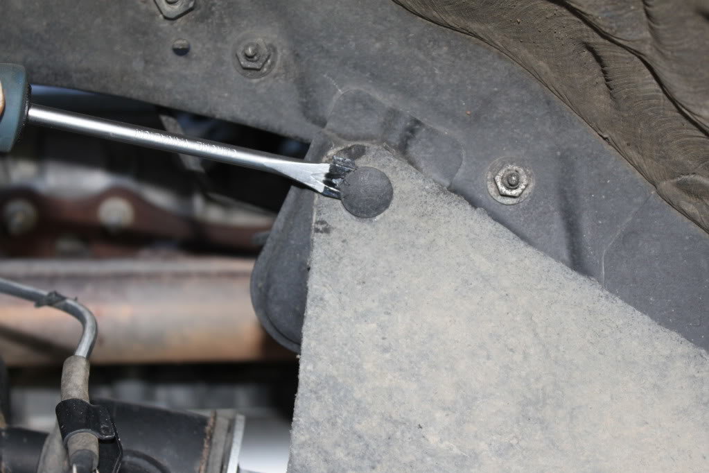

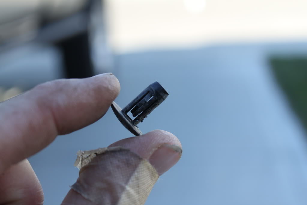

    Pop off the top button on the rubber flap so you can access & see the water jacket drains (done from wheel well:
    You may want to pick up some more of these little tabs, as they are kind of a one-time thingy:

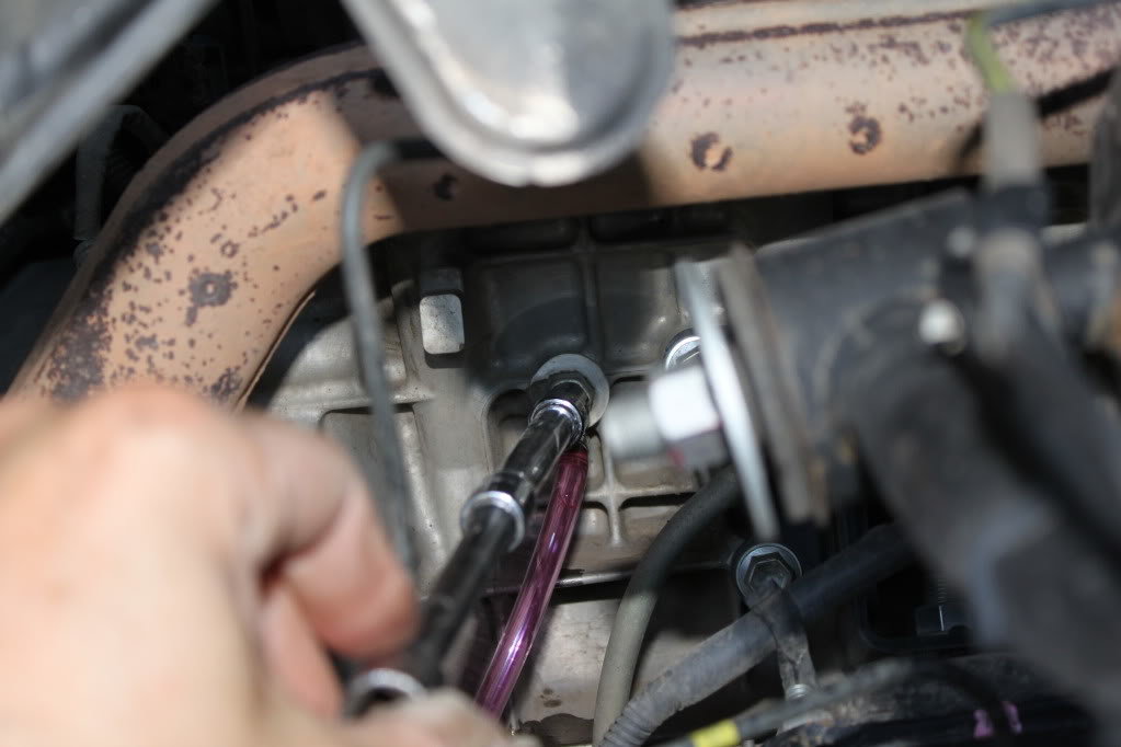

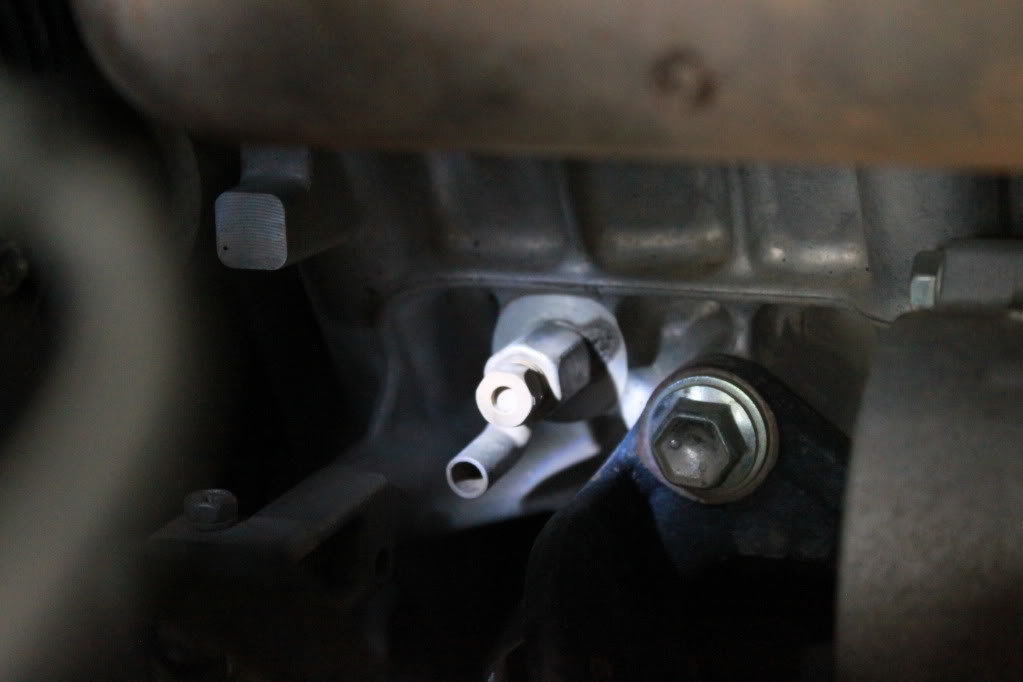

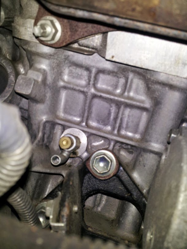

    Here is the water jacket drain we need to attach line to (access from wheel well) - passenger view:
    (Note - if anyone is having trouble finding the drains, let me know. I can post up some more shots, of where they are on both sides.)

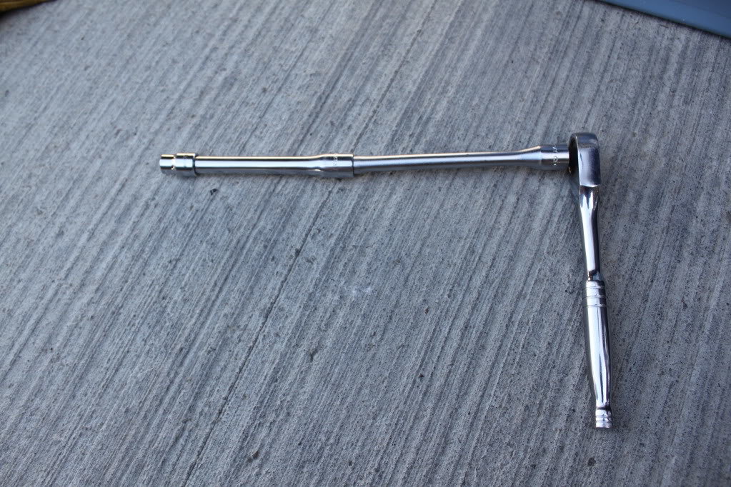

    Using ratchet + extensions (like I said longer is better), loosen bolt bolt above drain spigot:

    Here it is close up:
    Using 10 mm socket + ratchet, open drain & begin letting engine block drain:
    Drain both side of the water jacket. The driver's side sucks. You WILL need a universal socket to flex enough to reach

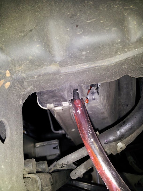

    Then drain the rad. The drain for the rad is (of course) on the bottom.... of the rad. I didn't think I needed to post a pic. The drain can be loosened by hand. And the 3/8" hose fits onto that as well!

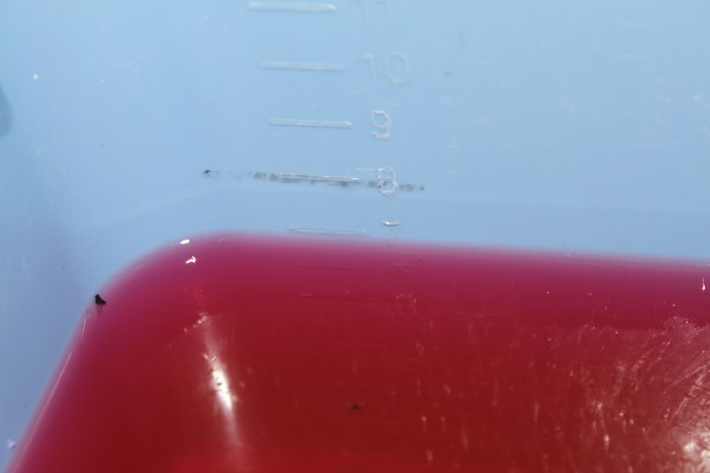

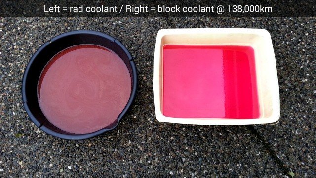

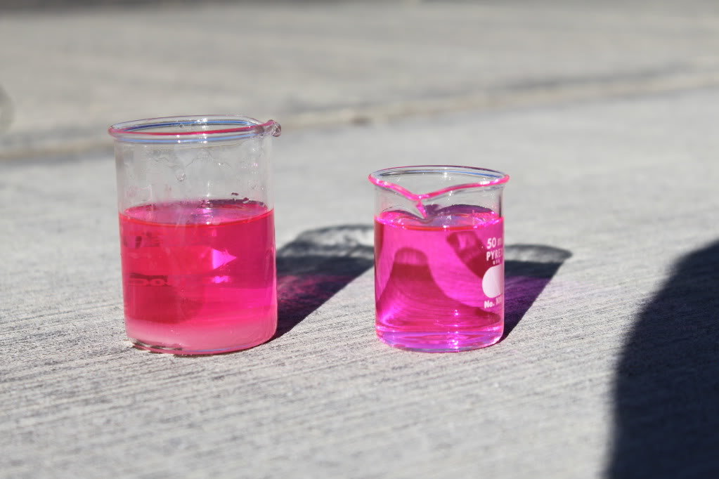

    When done, I had about 7 litres:
    Here is old (on left) VS new (on right) coolant. The white on the bottom of the beaker is dried "glue" <ahem> (hey, I only have so many to mix stuff up to "Blow some Shit up Today, as FPS Russia would say); the coolant came out pretty clear:

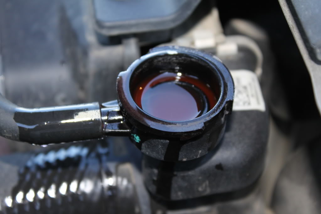

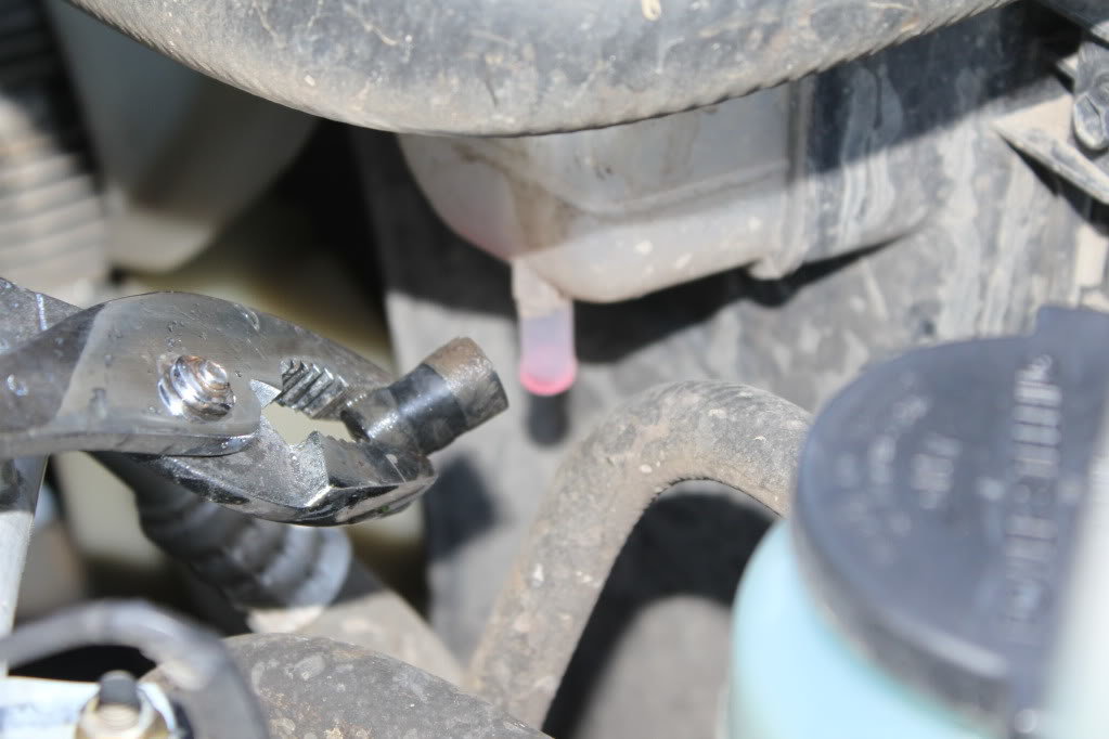

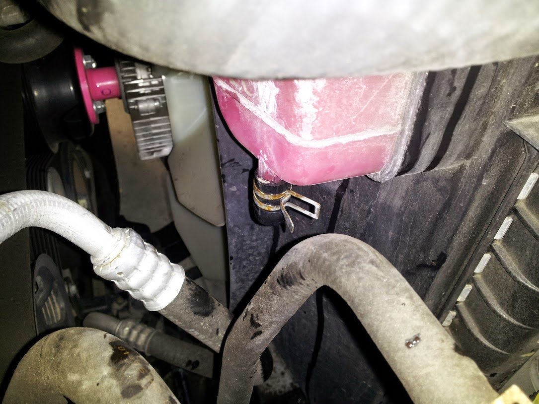

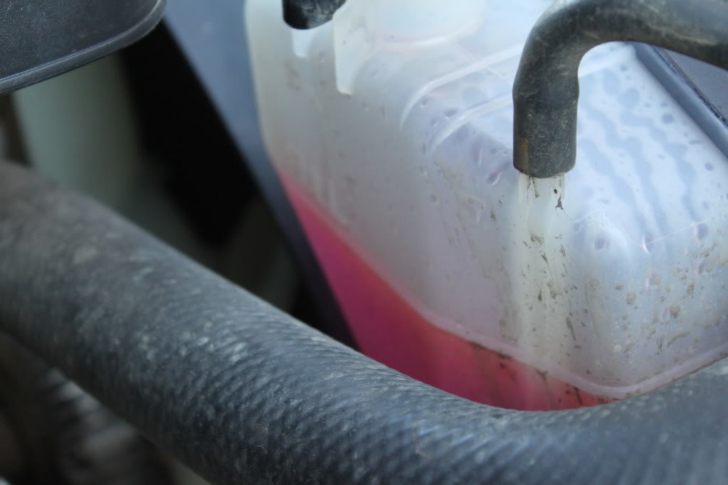

    Don't forget to drain the overflow tank:
    Refill untill rad is full:
    And top up overflow tank:

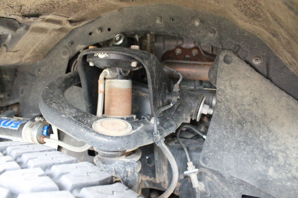

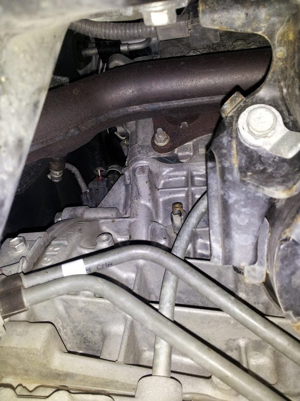

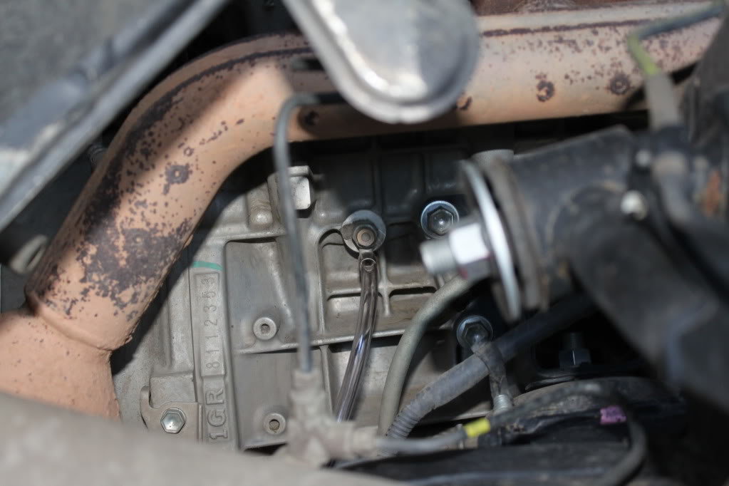

    Here's a view from the wheel well, looking above the tire[​IMG] - just for perspective:
    The area we want is just back & behind the Right hand side of the UCA & brake[​IMG] lines - That's why I pulled away the flap you can see on the right for the next pic - but as posted by others if you have good extensions you may not have to pull the top of the flap away.
    Here we zoom in to the drain:
    look for it *forward* of your starter, and *under* the exhaust manifold.
    A good LED pen-light helps here.
