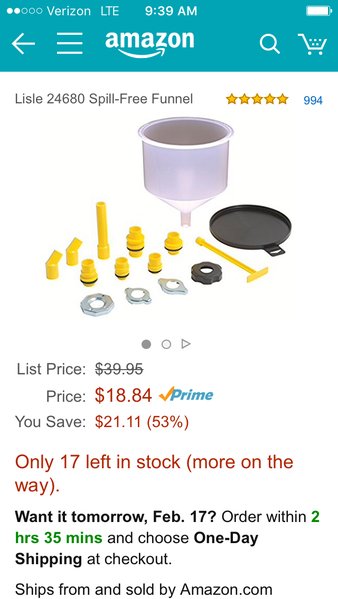

    Will be Changing out my coolant soon and ordered the Lisle #24680 Spill Free Funnel Kit, and also Discovered that a 13/16" Socket fits the Radiator Drain valve. Thanks for all the helpful Posts.

    Man that's a SERIOUS kit. I like that a lot. I've always just used a regular old funnel but I might need to invest in one of those as well. Nice.

    It's worth the investment. I like this model because the funnel is clear plastic . Thanks.

    Thanks for the great suggestion sir.
    Mine just arrived today, thank you Amazon Prime! I just used it to change the coolant on the wife's Corolla. The radiator cap adapter fit perfectly.
    It was the cleanest and easiest coolant job I have done in over 40 years. Just wish I had this a few months ago when I did my Tacoma. Actually I wish I had it 40 years ago!
