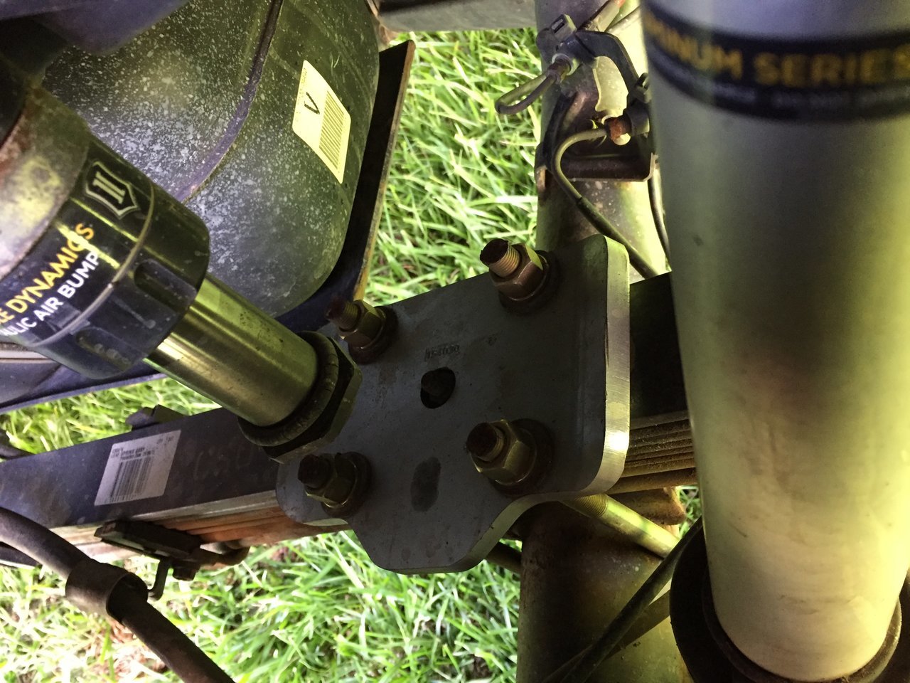

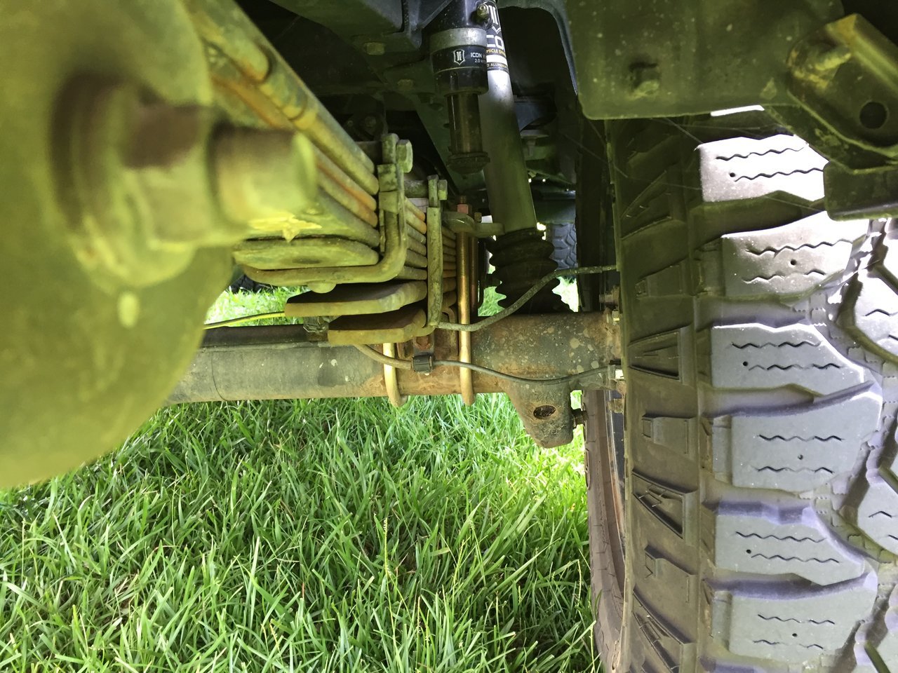

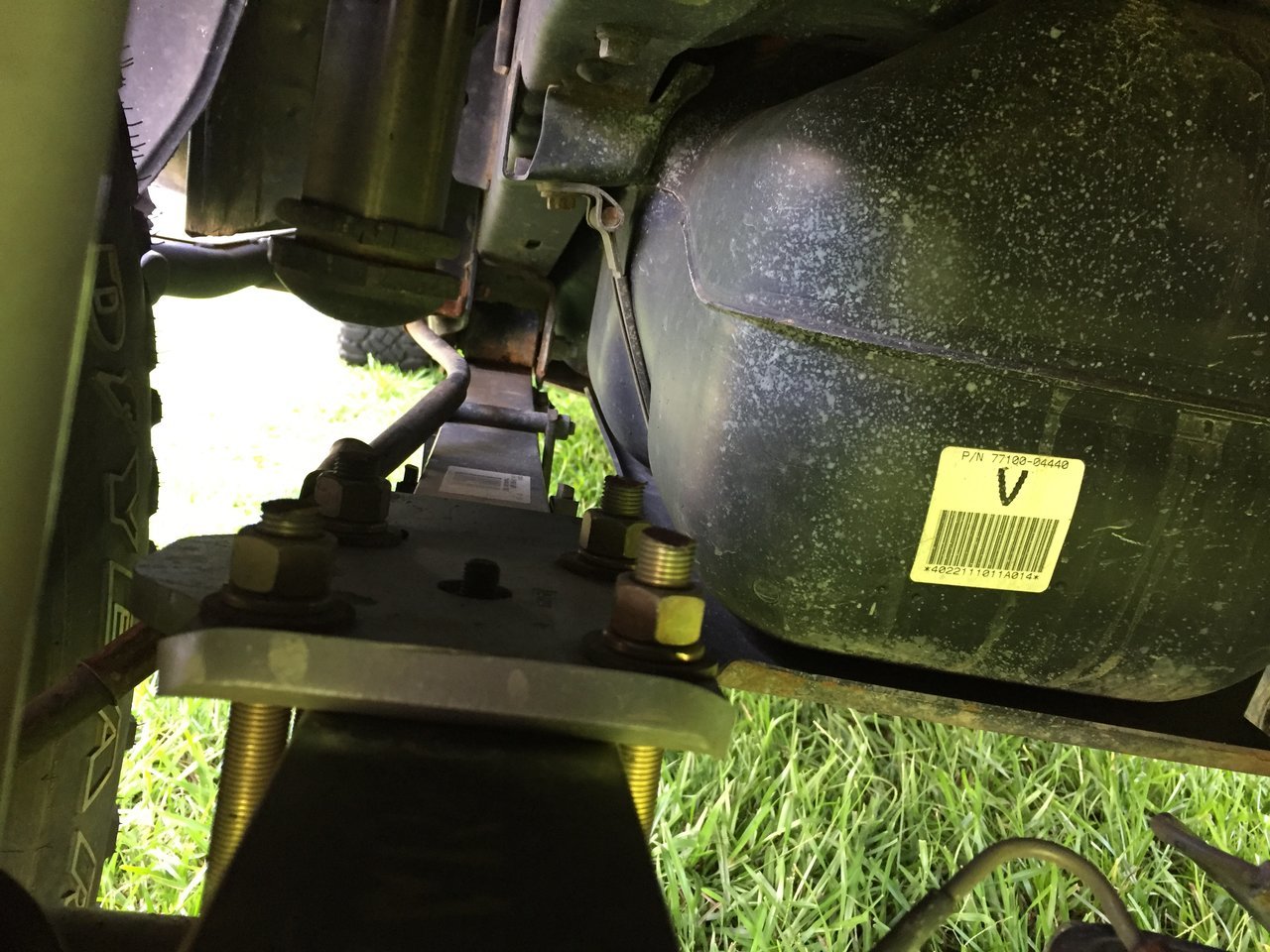

    I can take pics for you...what were you looking to see?

    U-bolts with the stricker plate please. :bowdown: About how much thread from the u-bolts is sticking out? My main concern is the bumps hitting the u-bolt :(

    Gotcha! The u-bolts I've got were super long and were cut down so they wouldn't hit anything.
    I'm going outside now to snap you a few pics.

    If you need a different angle or something specific, don't hesitate to let me know. I don't mind...

    Exactly what I wanted to see thanks! How's the pad on the bump stop? Doesn't look like it's ever contacted the nut on the u-bolts

    You're correct...it's never contacted the nut or any of the threads of the bolt. It strikes on the "ear" on the plate.
