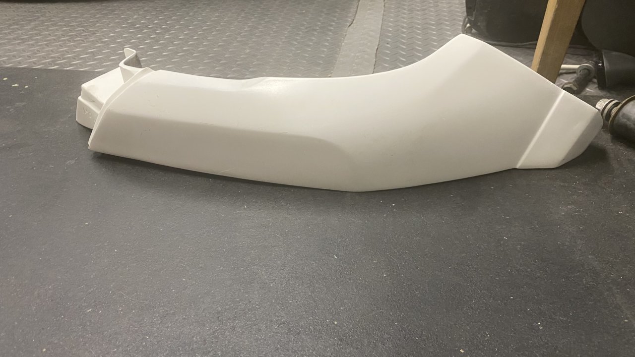

    Started to fit my ADV fiberglass panels this weekend, not easy, but surprisingly straightforward. Mostly going to be a game of getting them to fit perfectly before I prep em
    Curious about how people are making the fiberglass portion that goes under the head lights for a CBI/LilB wing style tubular bumper. From what I can see it looks like a combo of the caps cut short and the existing plastic?? Photo attached below

    Still super curious if anyone can provide their feedback on the above pic (circled body portion to bridge the buldge fenders.
    This is what I've been working at today and it looks ~alright~ but I love that above look. Also curious if the people doing LT +3 with fiberglass and tube wing bumper are you taking out the entire wheel liner or just chopping the part that is already exposed for looks?

    My McNeil kit has a full fiberglass replacement for the area you’re asking about.
    TRDpro pugz seems to be running the same kit according to his IG

    Ah shit... my first mistake was going ADV I guess. I see it now after checking both sites that Mcneil has caps for fabricated fenders- I wonder if they'd sell those to me directly or if they would even line up with my adv fender 4" flare

    Like I said in the LT thread you might just have to run it as is. The lines won’t match at all with the other parts and IMO that would be look worse.
    Good luck with the install. I have the BAMF relocation and shackles/hangers with a 12” shock and rxt leafs.

    Yeah so I ran with the lines like you said @RETR0spec and I'm happy! Just hoping my buddy can make some fab magic for the front wings. Got leafs, u bolt flip & bump installed last night.

    Looks good! Yours looks super wide compared to mine.
