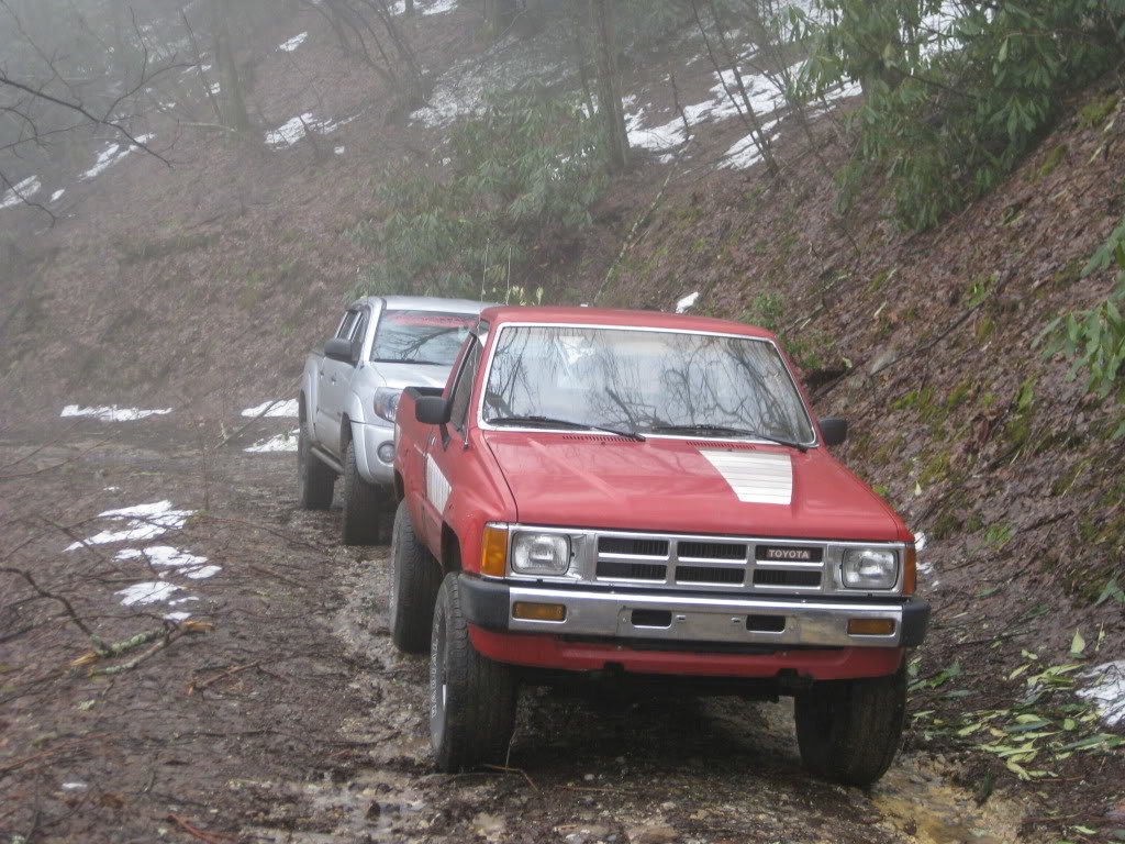

    Thanks for the comment. I have the stock rear shackles with the skyjacker 2" rear springs. The front is at about 2.75" lift. I wouldn't adjust the lift higher than 3", your cv axles will not like that. I have my lift set so the fins on the cv's are as high as possible without rubbing. I set the front coilovers the first time and have not touched then since. They may have settled an 1/8inch if that even.

    Getting close to being able to build. I have most of the big parts except 5.29's and Aussie lockers. Lots of small nicknacks and mounting hardware yet to buy. ohh and a clutch.
