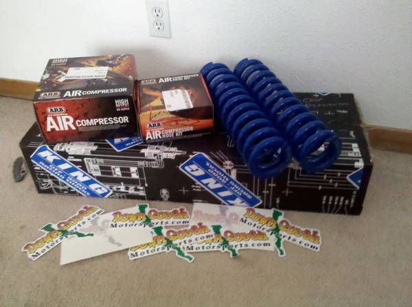

    Hopefully get things going in the garage next weekend.
    Went with the 750# 16" free length springs.
  5. May 2, 2011 at 7:57 PM
    #305
    Dark Knight
    Dark Knight [OP] Well-Known Member
    Jul 18, 2008
    #8006
    9,804
    Jeff
    NC/SC
    4Runner Trail, 88 pickup, Tundra Platinum
    A few bolts are different.
    Jamie is running a 700# also
    The original springs were 675# 14.75" free length and pre-loaded all to hell. Hope these hold the DCLB weight.

    Yeah, he just put them in about two weeks back. I've got to ask him how they performed this past weekend at URE.
    I also wanted the 750#'s to stiffen it up a little, I'm ditching the sway bar.

    I wonder how much heavier the ARB bumper is versus the AP? I'm a little worried about the 750# springs. The long bed is sprung weight but not a ton more I dont think??
