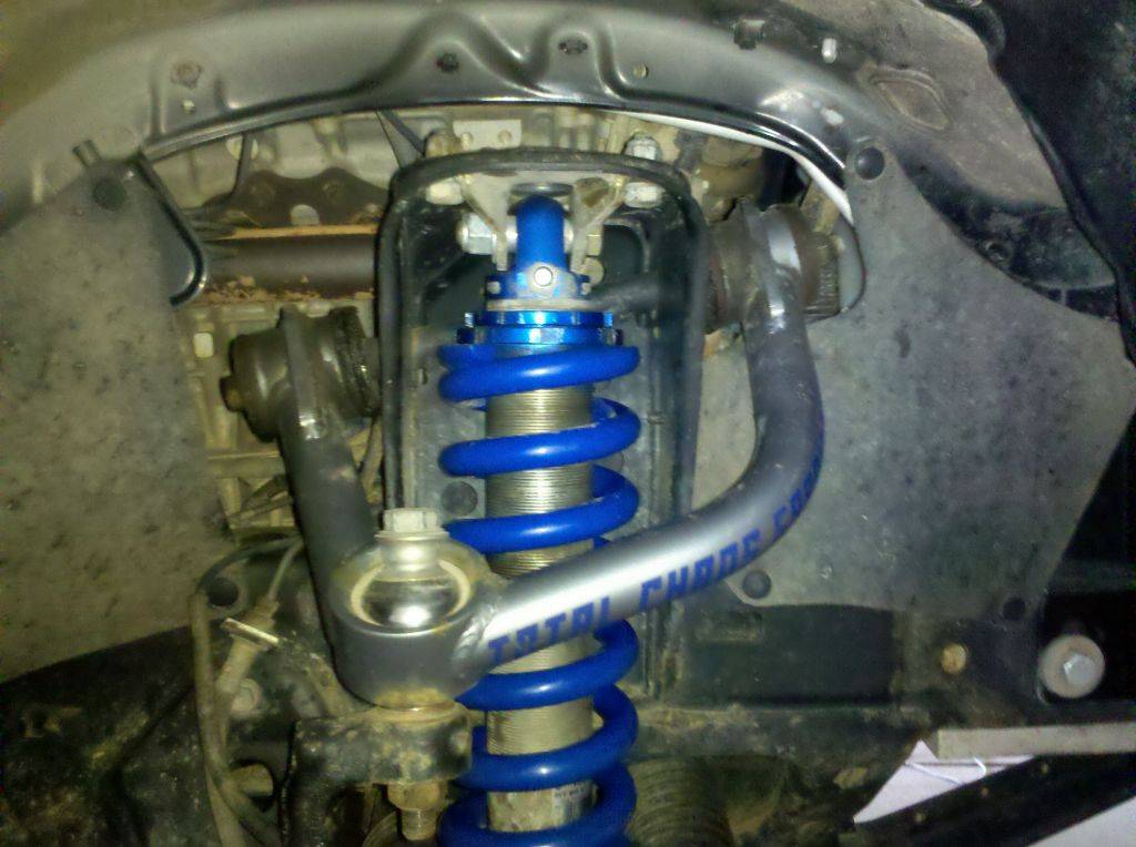

    Preliminary settings are a FAIL. Even with all the extra spring length and a heavier weight spring I'm going to have to crank the living shit out of them again. I'm willing to put money on it that the springs will continue to rub the shock body and squeak, any takers?
    I broke my spanner wrench so the final adjustments will have to wait. FML, no 4wheelin tomorrow.

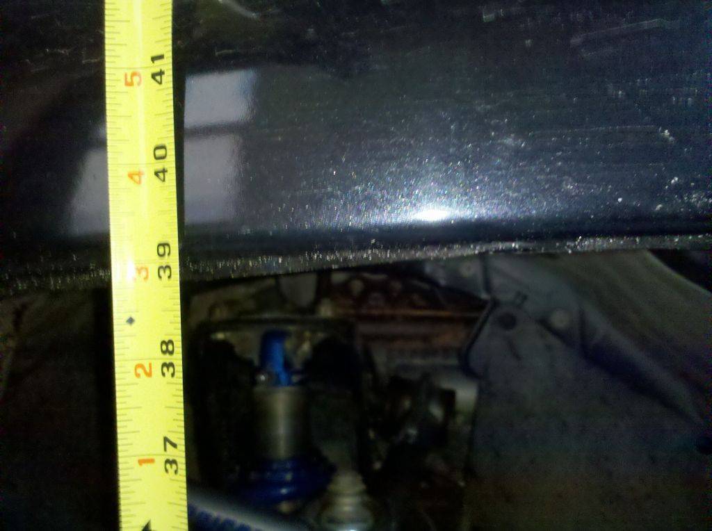

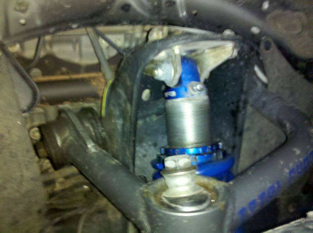

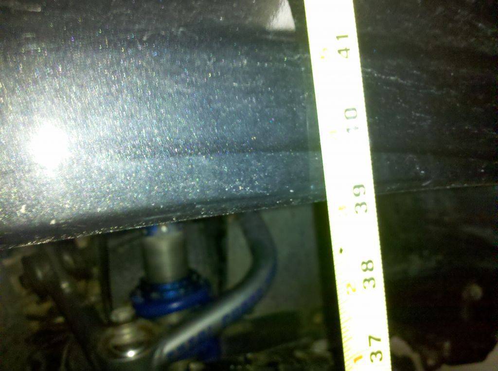

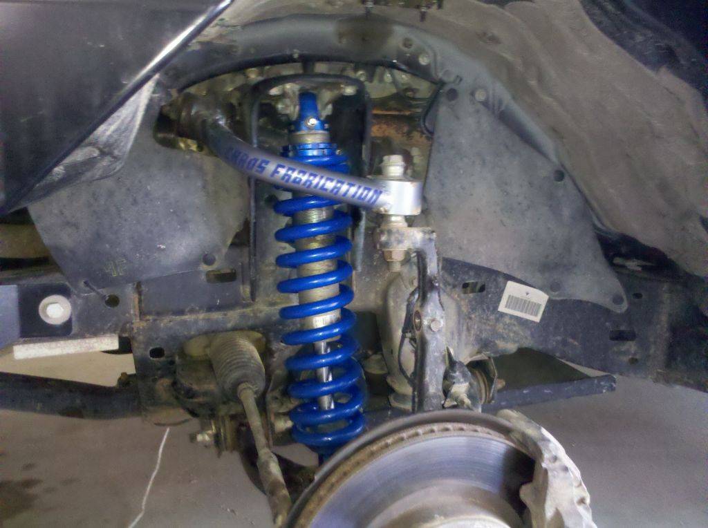

    Post adjustment first thoughts. The 750# 16" free length springs seem like they are going to be awesome! The ride is very smooth but firm like I like it. There is not much front end dip in corners or braking without the swaybar and in fact the steering is much smoother. I feel like this is in part because when hitting a pothole with one tire the swaybar is not acting as a outlet to resonate the jolt of the pothole to the other side. The flex seems to be a little stiff though, time may help this after the springs break in a little??
    Driver side and Passenger side measure 39" to the bottom of the flare.
    The passenger side preload collar is adjusted down 2"
    Driver side preload collar is adjusted down 2.5" to account for the "lean"
    Post adjustment stance.

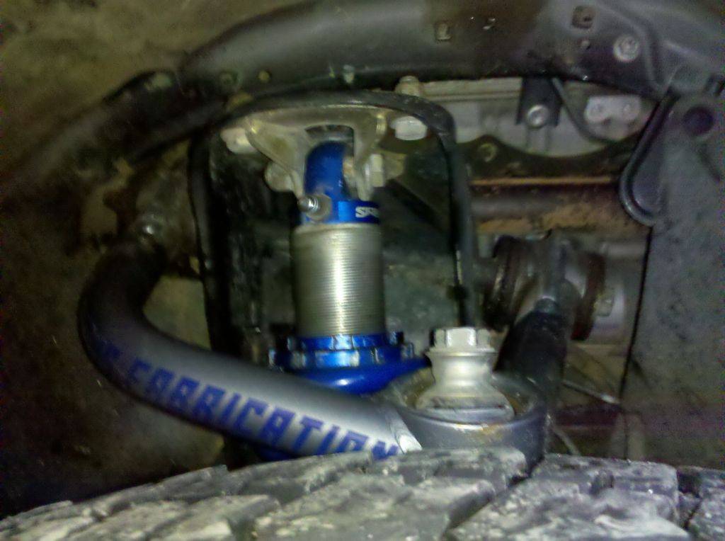

    Another thought on the springs. I'm hoping they settle a little bit. Noticed this morning I adjusted them high enough that the CV boot fins are slightly touching, don't want that. May drop it down to 38.5" to bottom of the fender flare to solve this problem.

    I backed off on the preload collars 1/4" inch on each side. CV boot fins are not touching now at normal ride height. Front is sitting at 38.5" tall.
