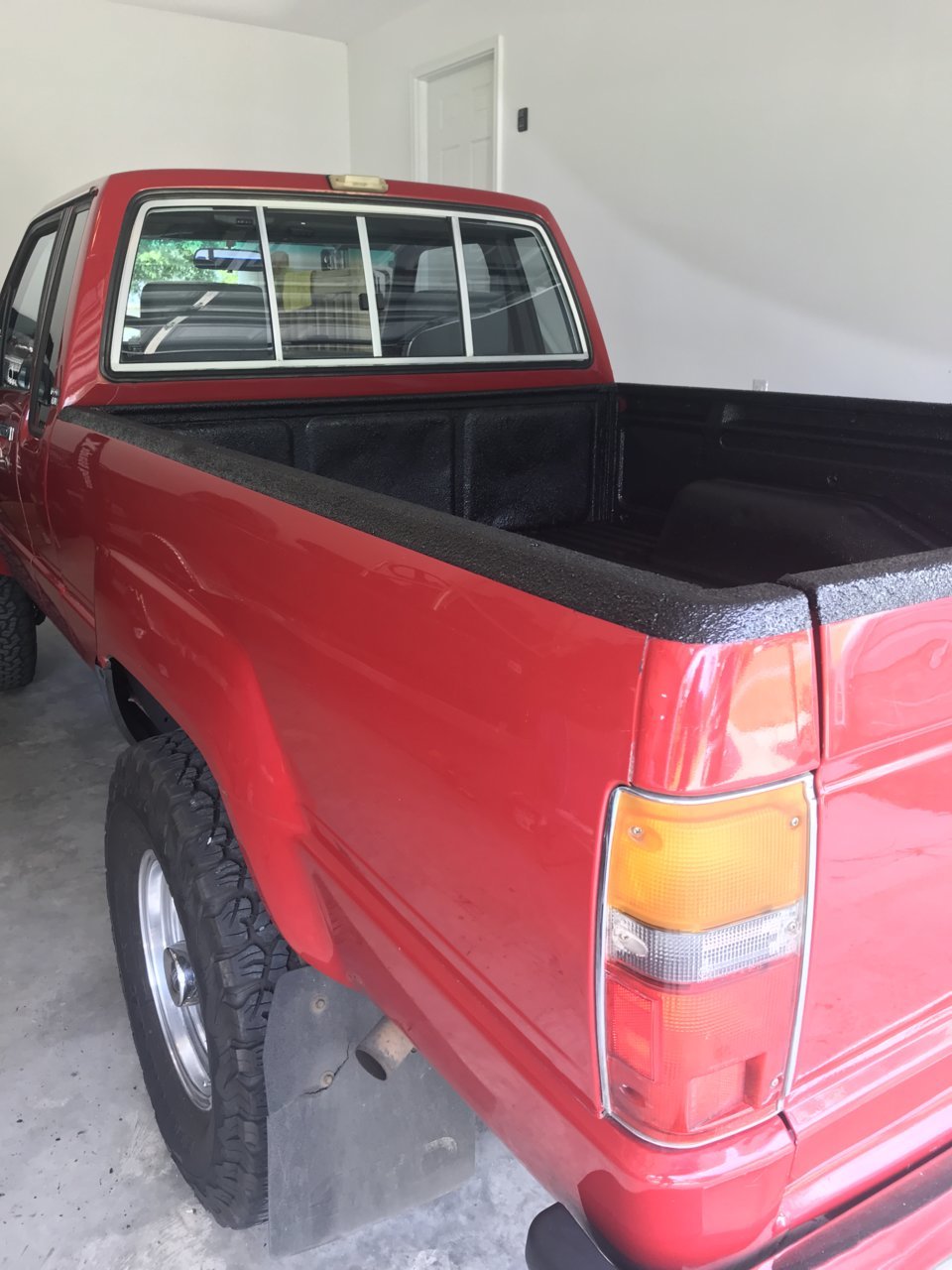

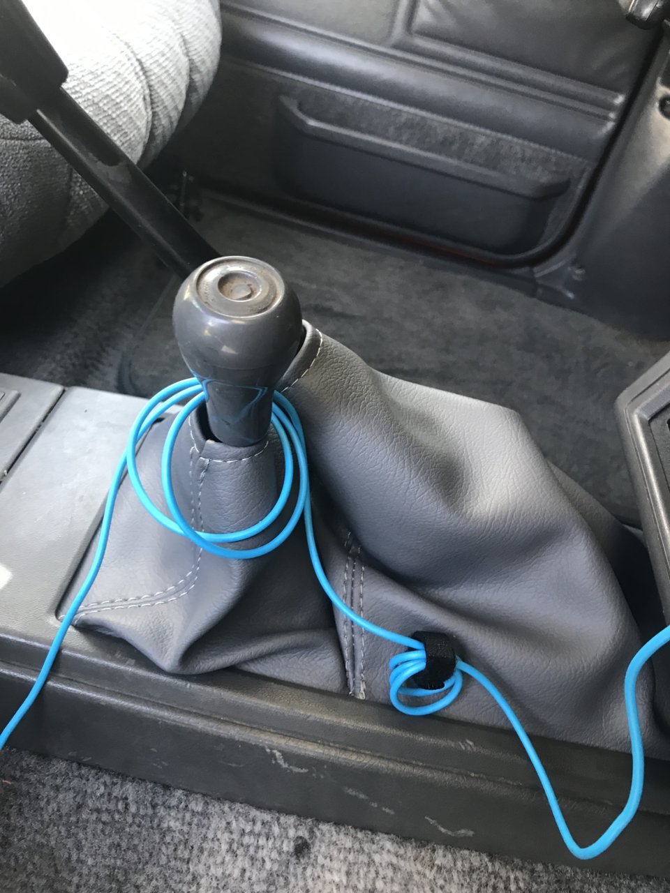

    Some odds and ends today. Fresh herculiner and shifter boot.
    Have to pick up new transmission fill and drain plugs to change the trans oil. The current plugs will be destroyed getting them loose.

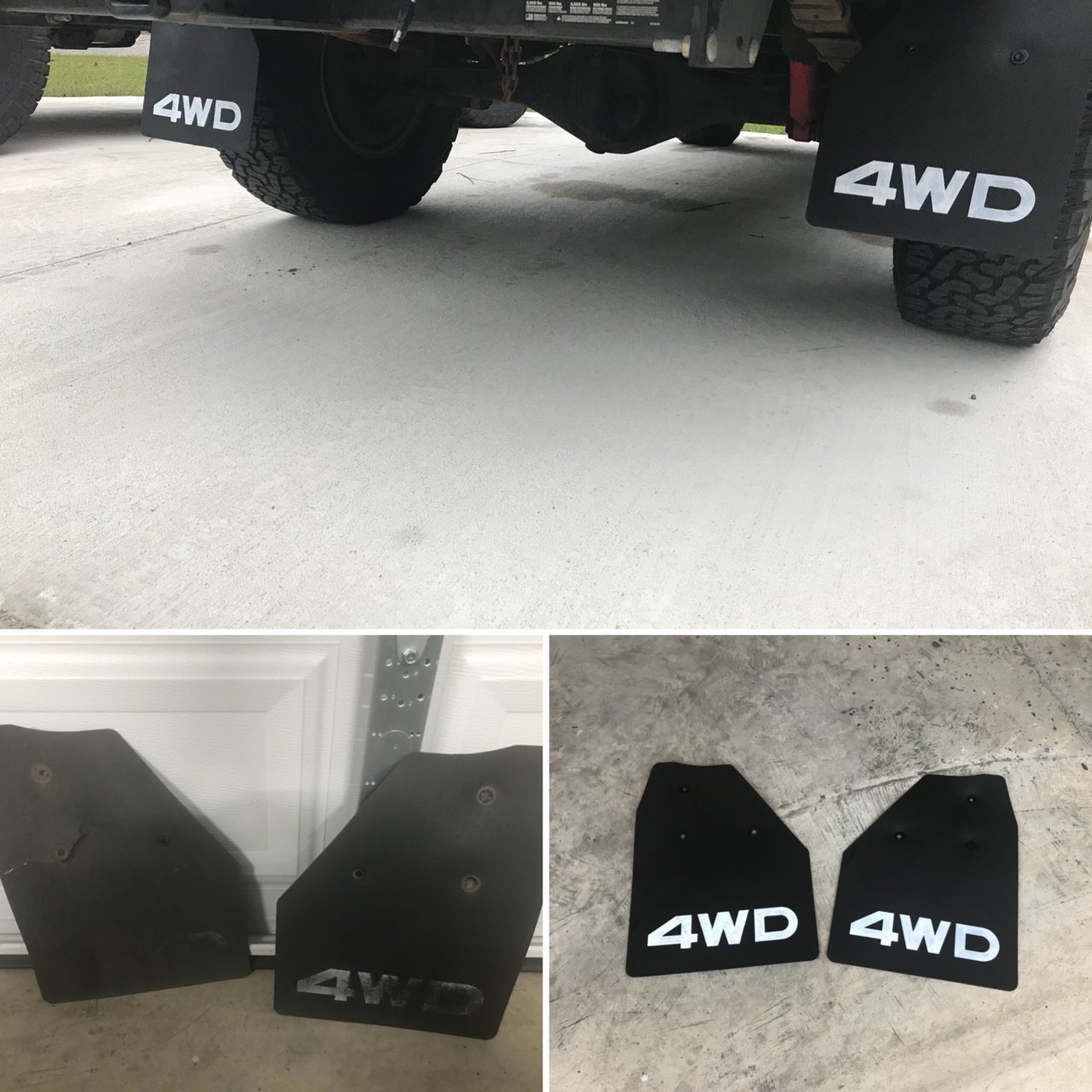

    D5E9BC57-6F03-44BA-B475-4362D630FFF3.jpg New Marlin Crawler clutch, flywheel, pilot/throwout bearing, and rear main. Also restored the mudflaps this week.
    Next on the list is a pesky gear oil leak from the top of the transfer case.

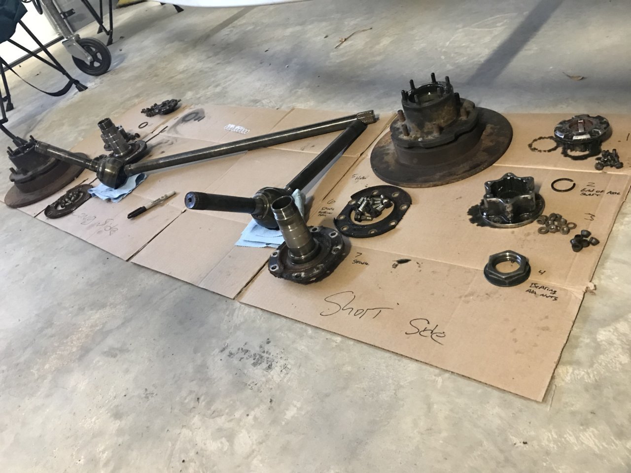

    A few bolts are different.

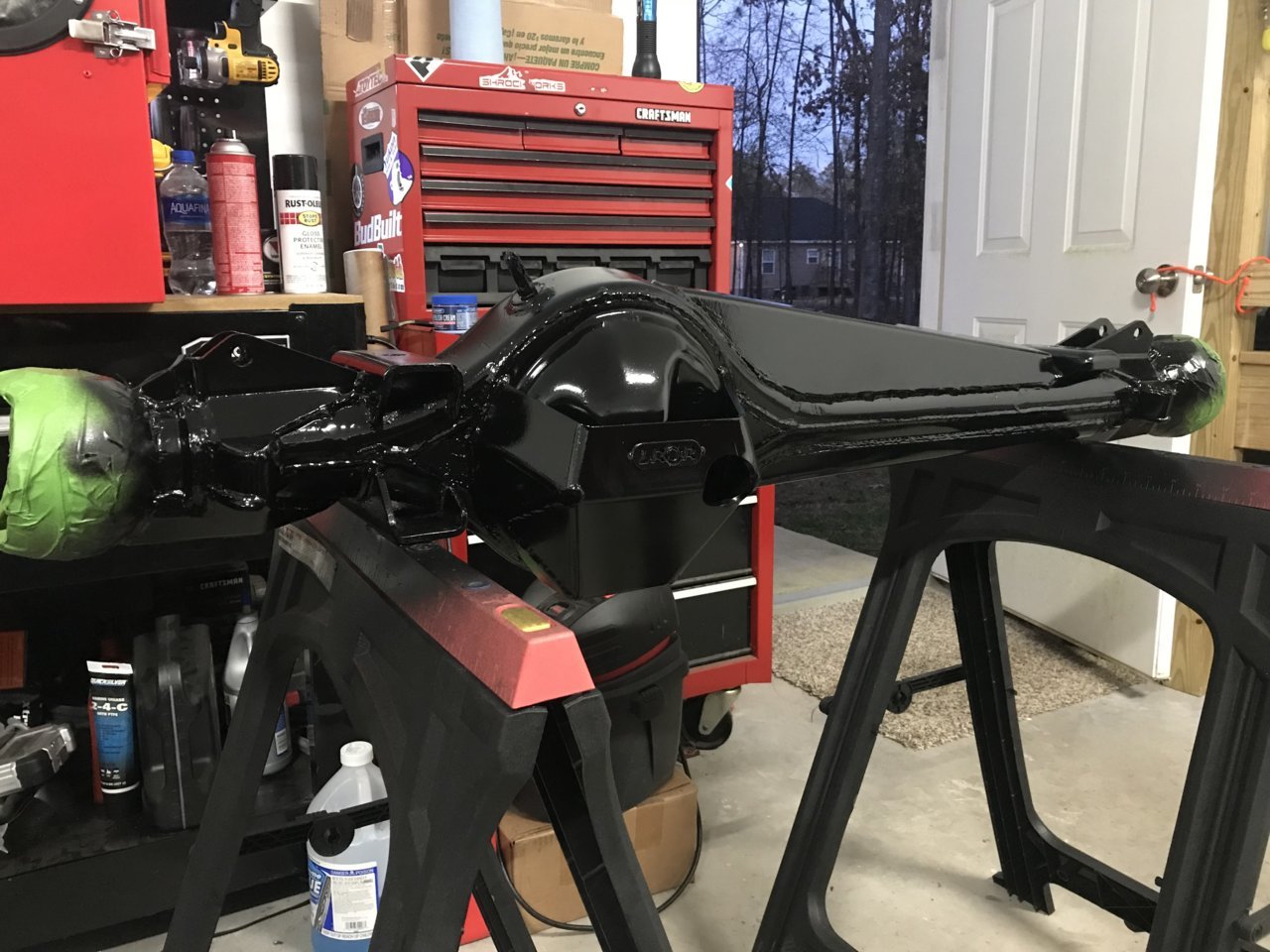

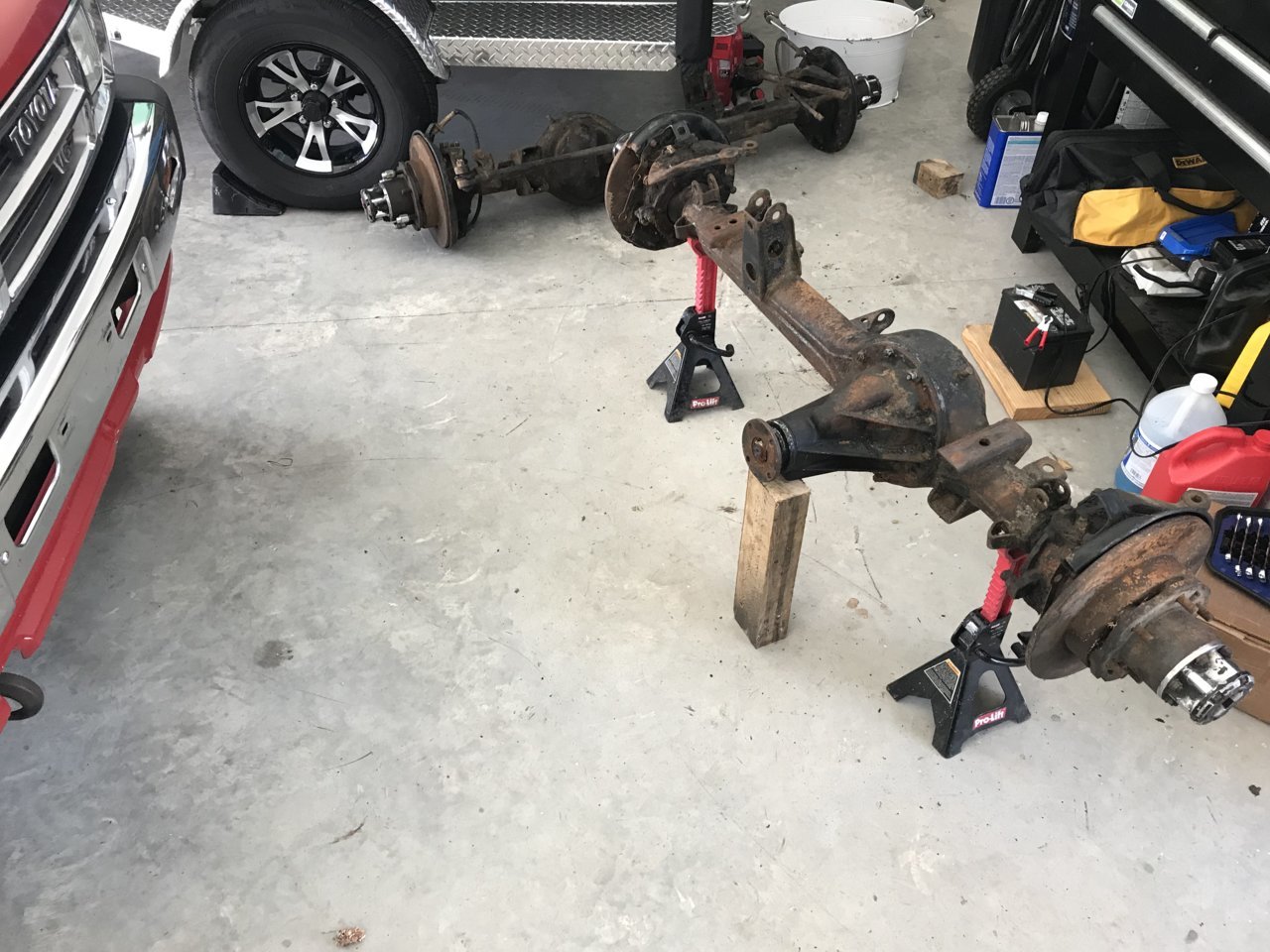

    Progress. Parts blasted, Axle trussed and armored. Waiting on high pinion with 4.88’s and ARB to continue assembly.
    9A9C050D-E1B9-4750-8E0B-795A28E7CCD5.jpg 33837272-CAD0-4757-94C8-DB4F5DA6986C.jpg E0CC91A4-2785-49A4-BC8B-68EE45E1B934.jpg

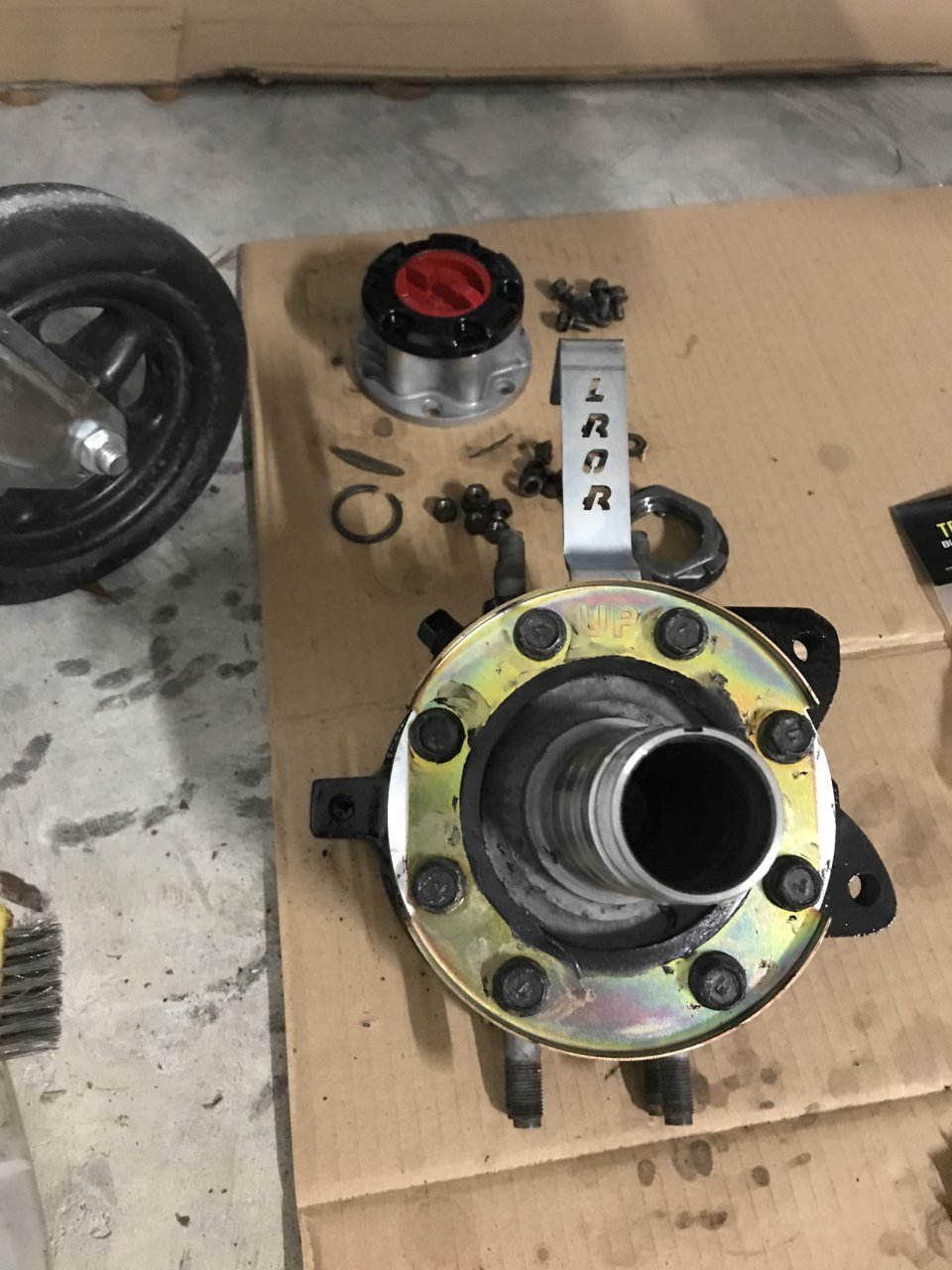

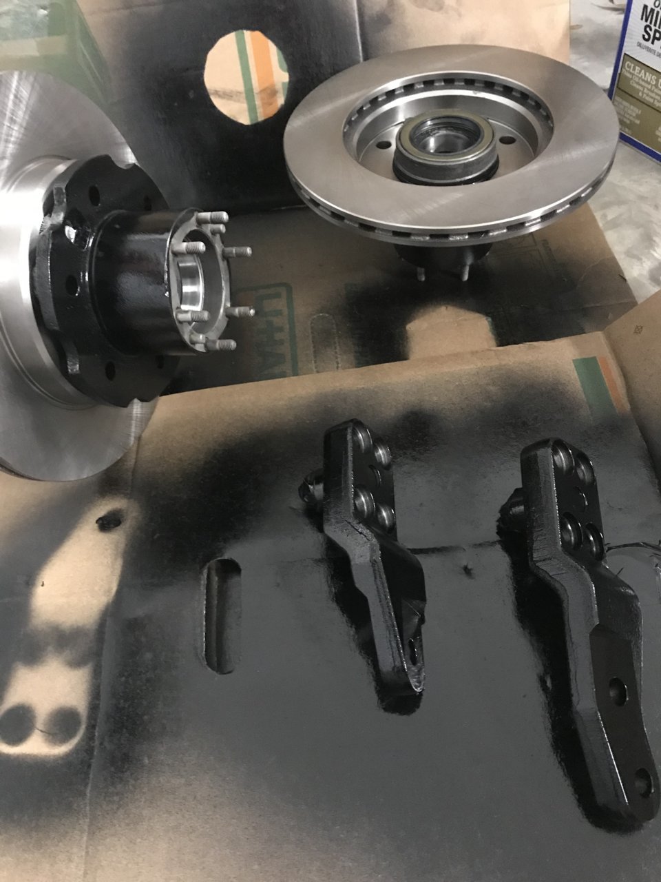

    Hubs and knuckles back together.
    B7ABBF7C-9412-4399-8B98-9D19C40DA344.jpg 105CC225-9732-43C6-84B0-90241D7D3DDB.jpg

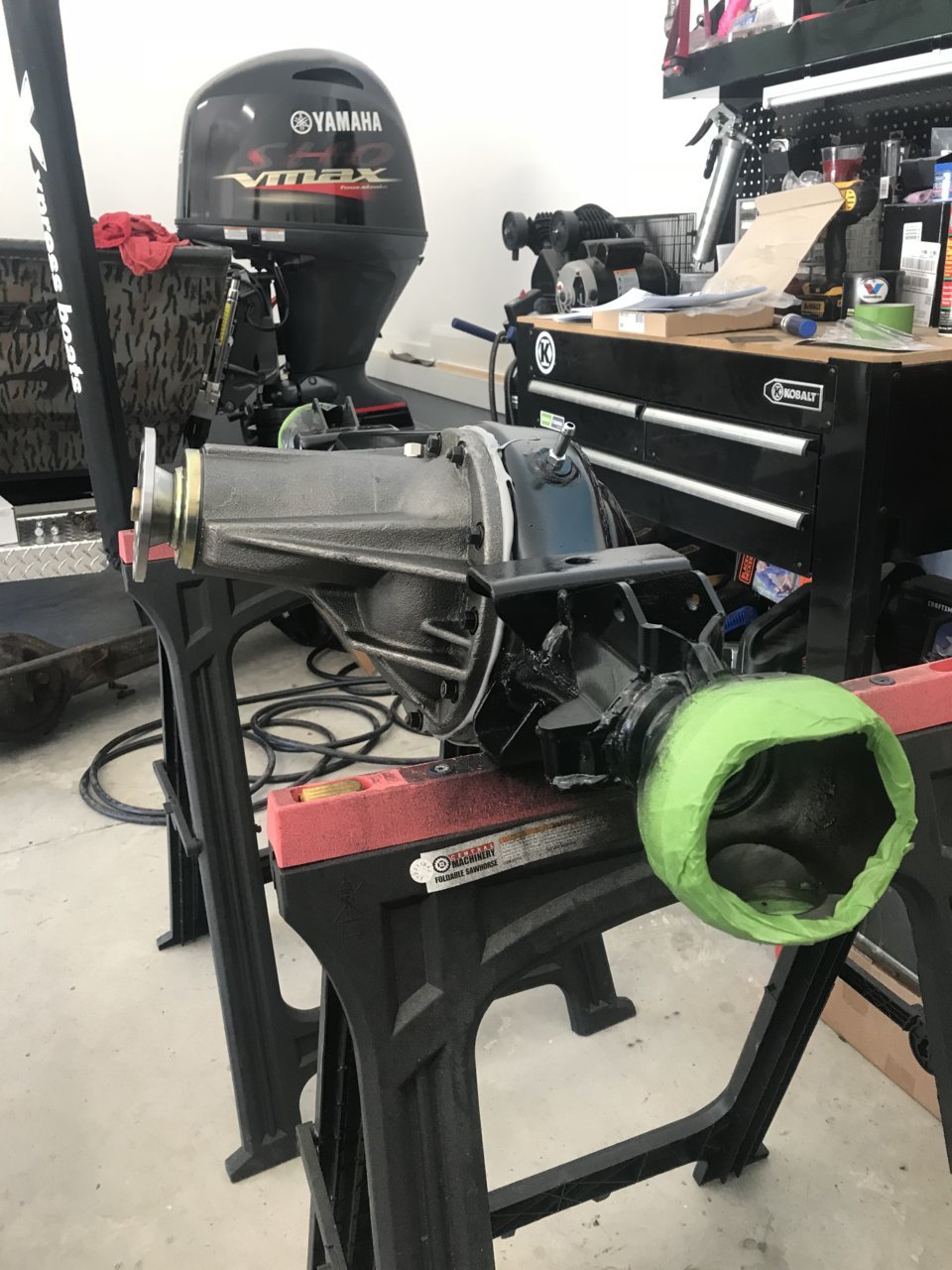

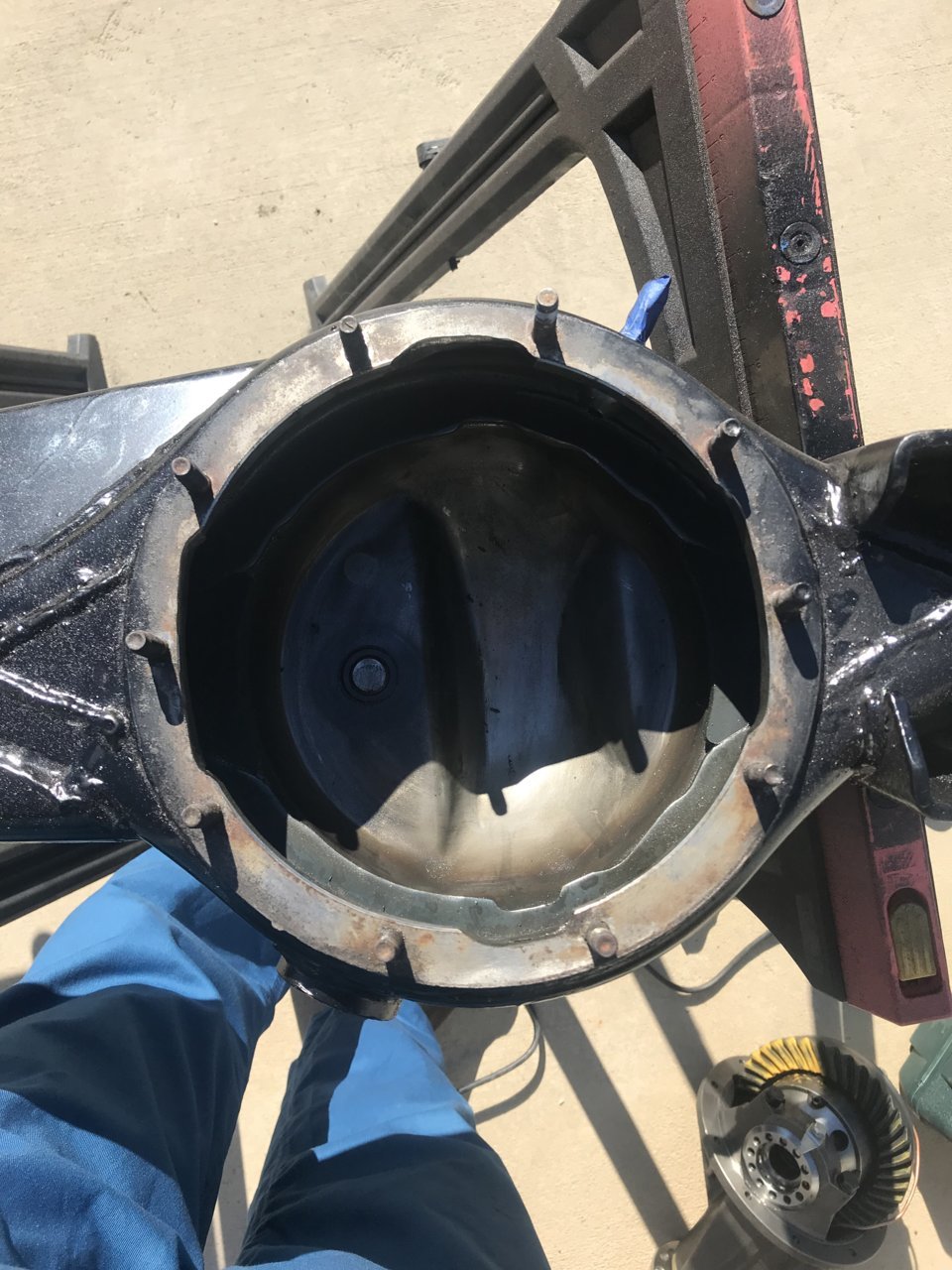

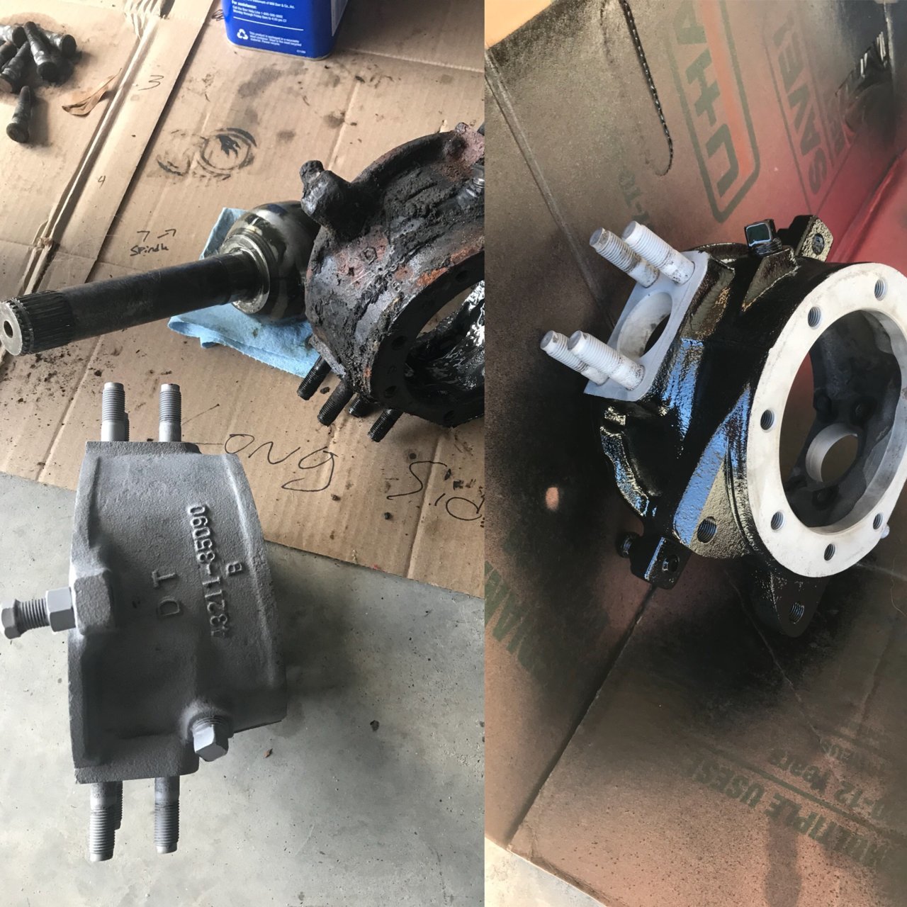

    Diff installed after clearancing the housing.
    A4C73B3B-6924-4540-9814-A6027165AAD6.jpg 9E40B60B-45AD-43BD-9A93-4CD583F6DC1B.jpg
