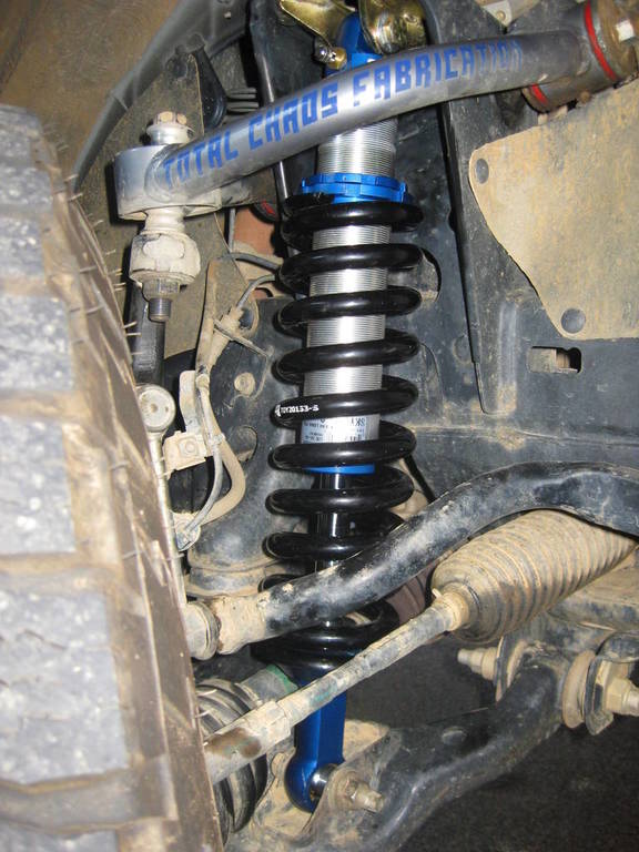

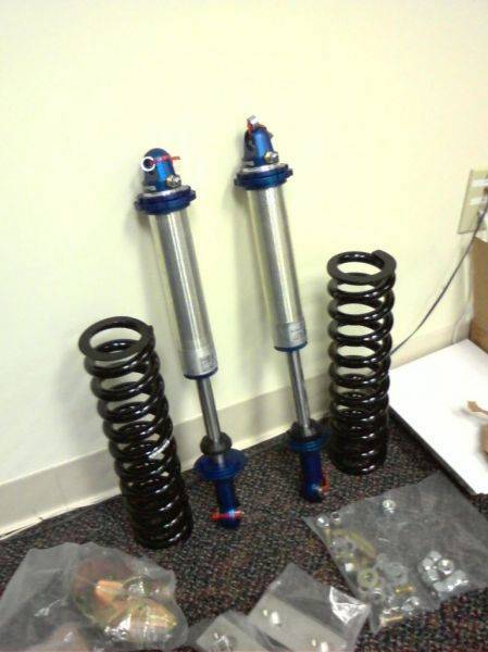

    There on but not finished. I have lots of adjusting to do....:mad: the directions said leave 2" of threads above the spanner ring for 2.5"-3" lift...WRONG. in the end it's going to be more like 3-3.5" maybe 4" of threads showing. fyi, a rented spring compressor is worthless to aid in the adjustments, they will not fit in between the coils.

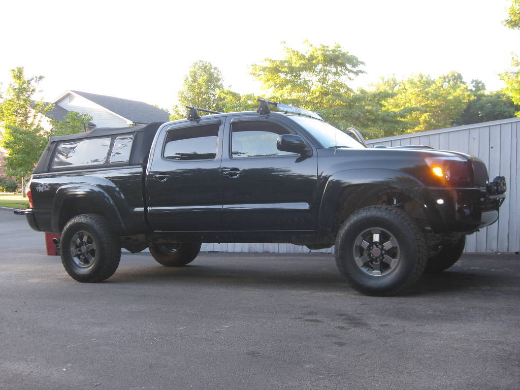

    got'em on and adjusted and they ride like a Cadillac
    Ride height is perfect, passenger side set at 2 7/8" threads showing, driver side at a little under 3 1/4" threads showing above the spanner ring.
