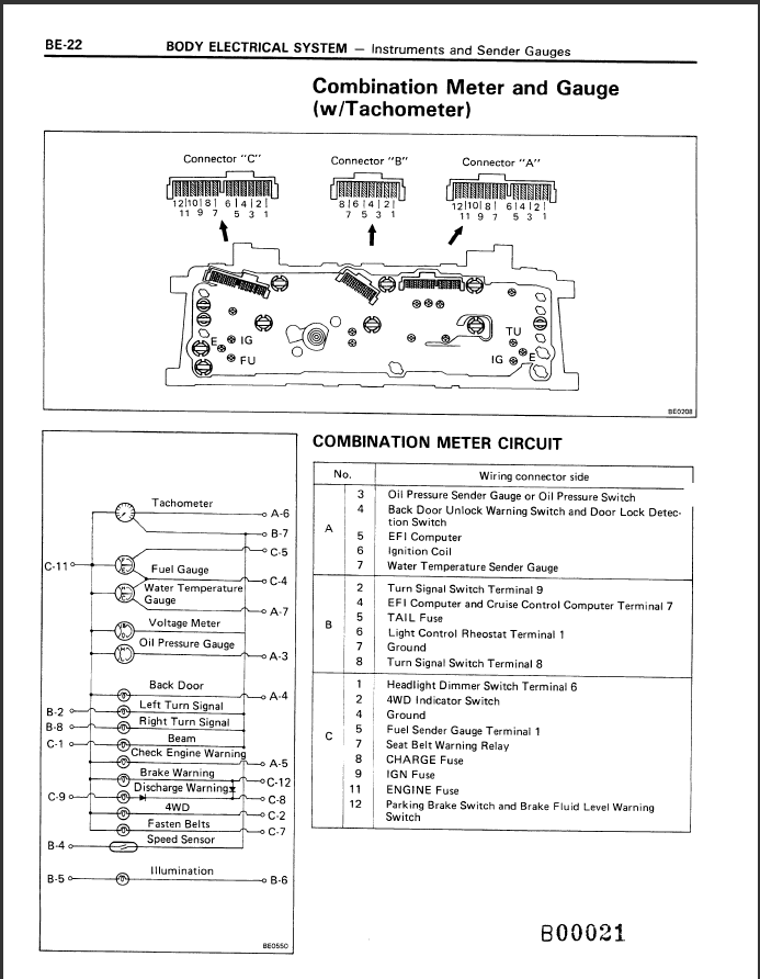

    not at all, I took everything apart and atleast I found that the tach was in there from the factory so the mileage is correct. I did not have a volt meter or anything like it to check out the wiring, but something leads me to believe that the problem may be in the electronic tach itself......

    the stock wires for the tach are (+) = black in pin 6 on plug A, (-) = green with hash on plug b ( i forget which pin number location). The wires go off and bury themselves in the wrapped harness back behind everything so its very hard to tell without ripping it all apart. I just didnt have time to do that but maybe will at a later point. I think they originate themselves at the ignitor, in the larger green barrel plug on the ignitor side of the little green test plug that we read everyone gets the signal from for a cluster swap.

    I am not sure that it is a test plug. According to the FSM it is supposed to be hooked up to on of the barrels.

    what page are you looking at? I got "test connector" on page MA-9

    I see what you are saying. I misunderstood you.
    Page BE-24
    Wires number A-5-1 or A-6-2 end up at the ignition coin
    The B with the hash is the ground.

    :thumbsup: a-6 ignition coil, b-7 ground

    Interesting.........your's is different than mine (manual/FSM). Is it specific to the carb?

    no, it is the 1985 FSM I got it from Marlin Crawler forum. It's got an efi section and a carb section, MT and Auto section, manual hub and auto hub section.....etc....
