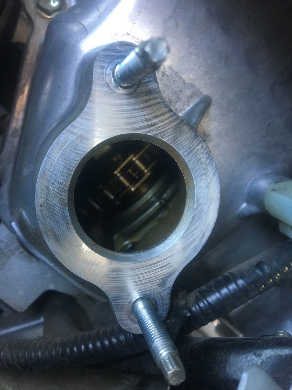

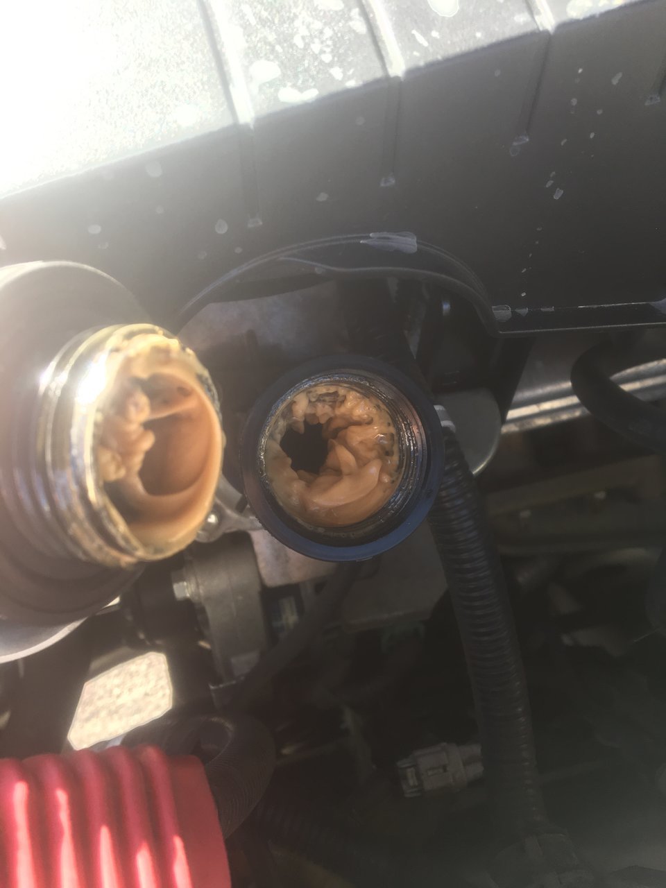

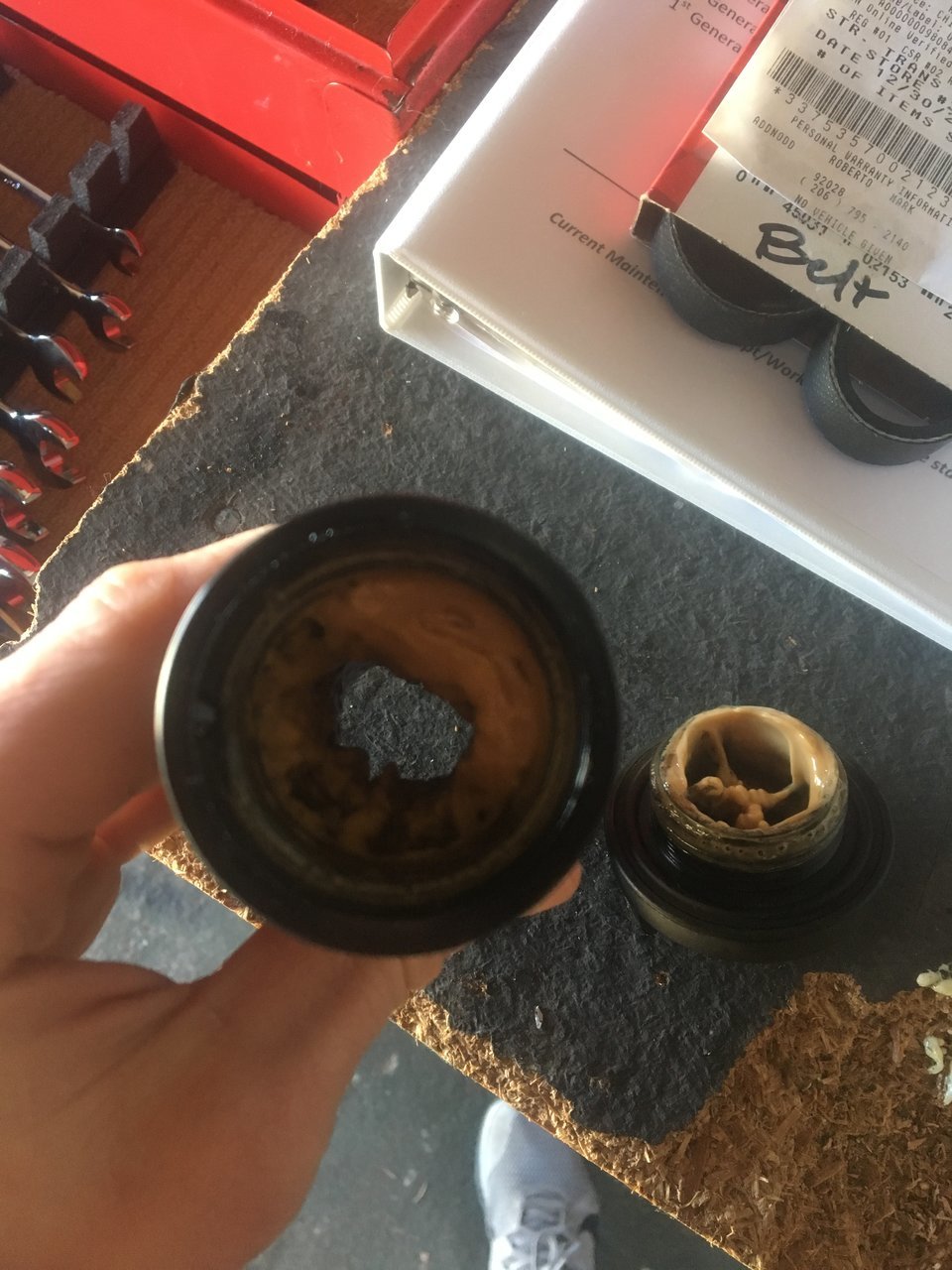

    Lookin like freakin peanut butter when I took off my oil cap and looked in the plastic oil neck...
    It makes sense moving to a colder environment (CA --> WA), plus my commute time is 8 minutes each way.
    I just thought a little gunk is all that would be there, so when I removed the cap and saw this, it was alarming...
    Luckily there's no sign of the gunk within the engine after removing the oil filler neck:
    ChadsPride likes this.

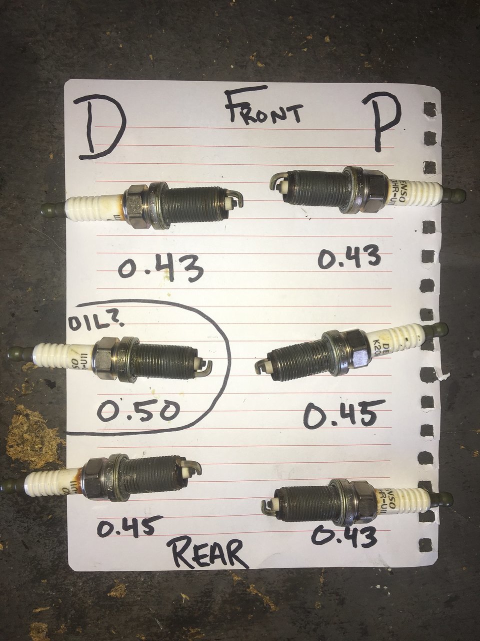

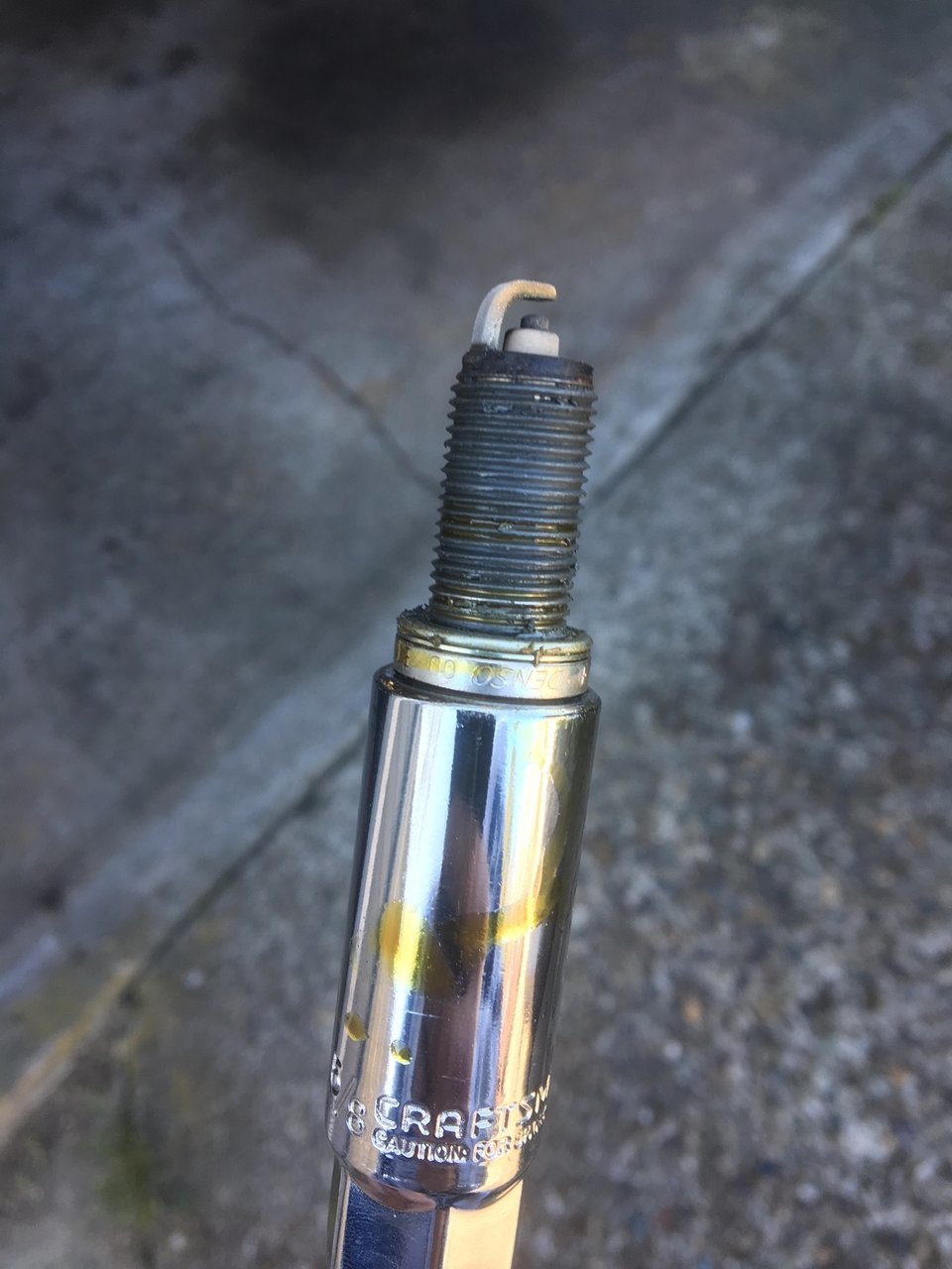

    Been putting off changing the spark plugs for a few days but finally got them... there was some oil on one of the spark plugs but all wear looked good for 30k being on the plugs. Replaced with Denso plugs.

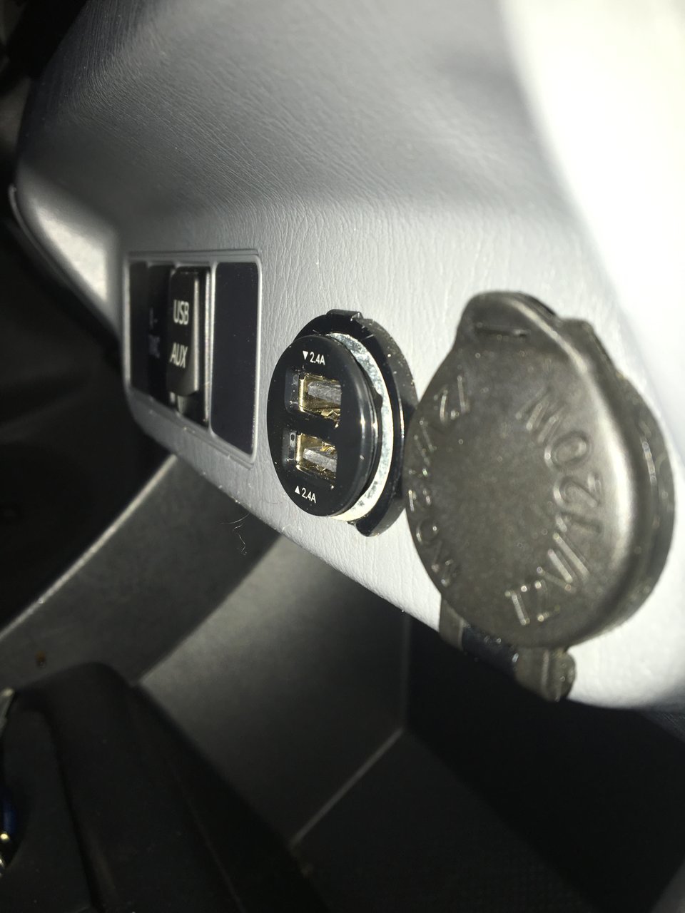

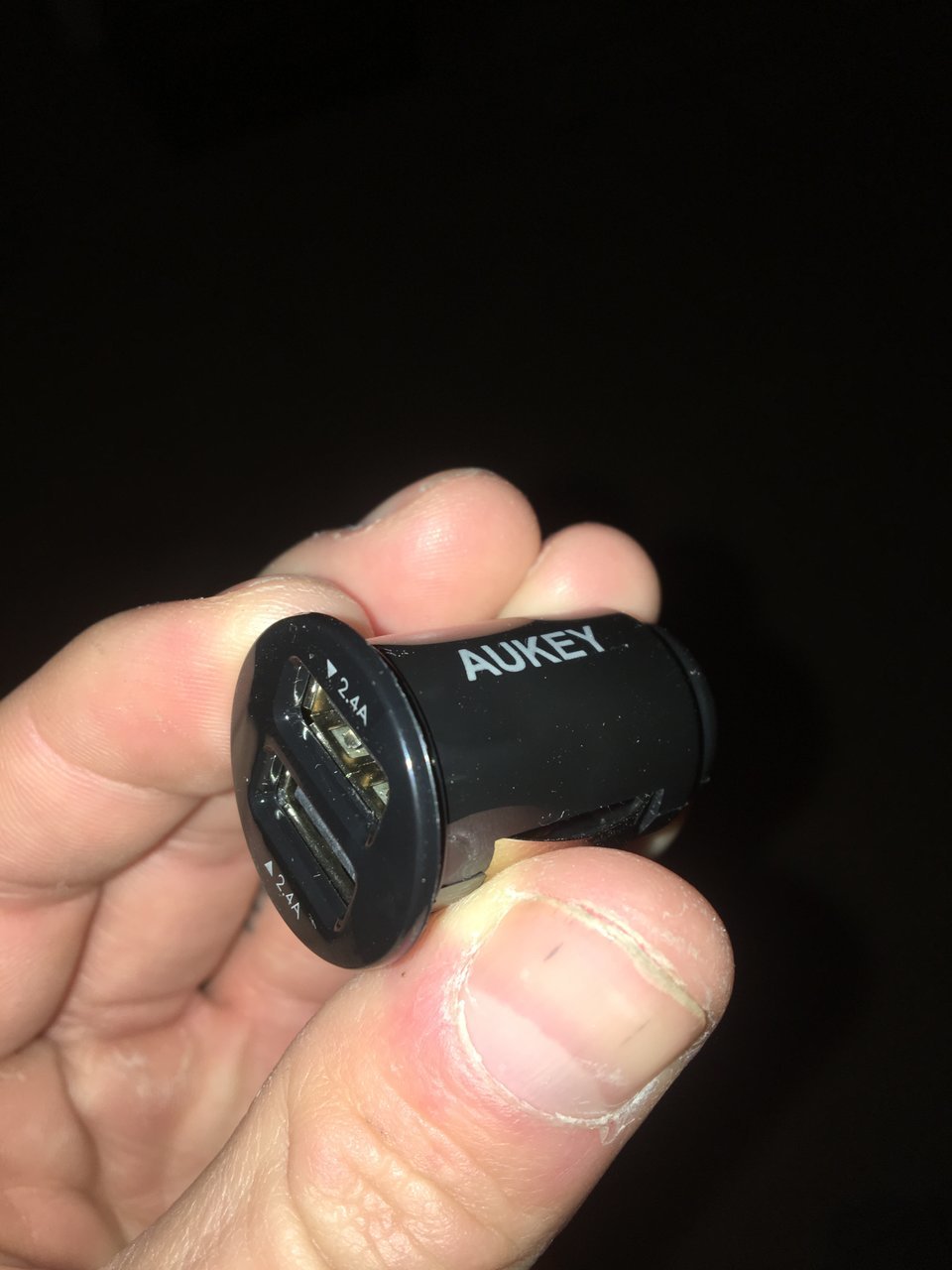

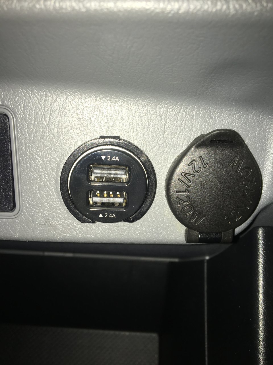

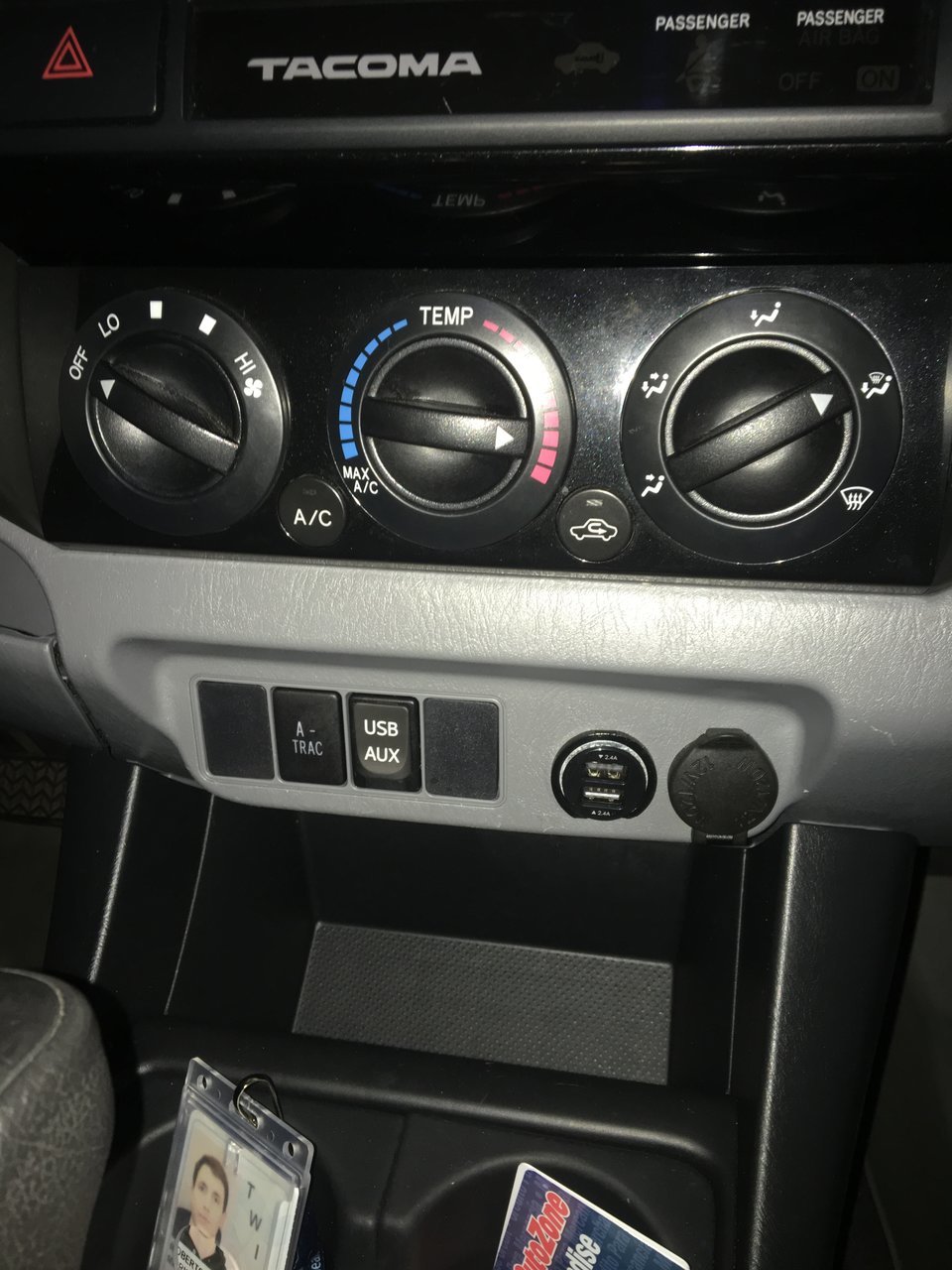

    I was sick of how the factory USB slot in the Off Road didn’t charge my phone worth a damn, after some reading it’s mainly a data transfer slot.
    So I got on Amazon and picked this USB cigarette lighter adapter. Each slot is 2.4 amps so it should charge my phone a lot faster... and its flush and better looking
    It also bothered me because someone broke the cover so having one with and one without a cover has upset my OCD through time :rolleyes:

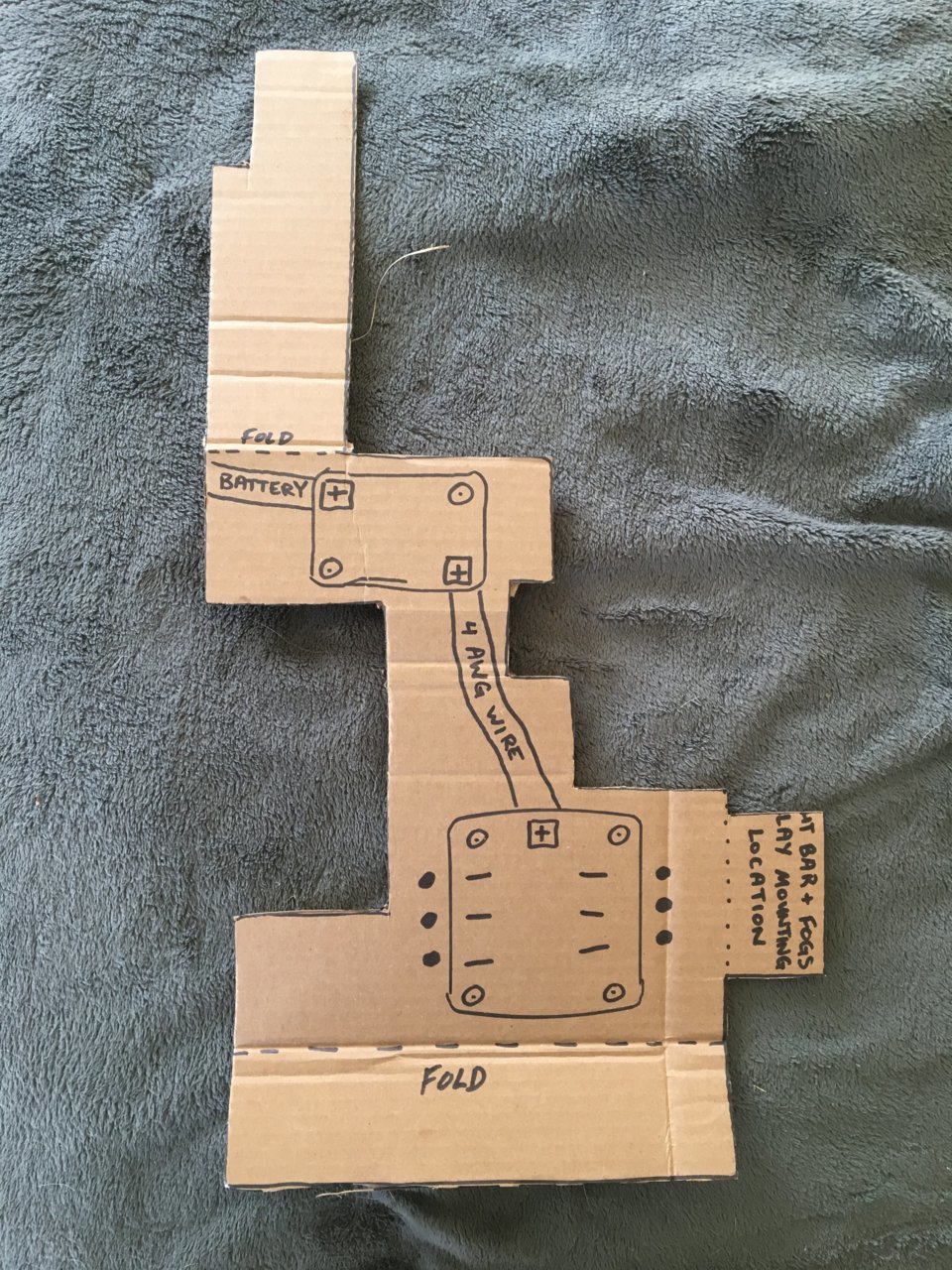

    I finally started on the Blue Sea Fuse Box and Bussman Relay mount, so far I've made 6(?) different cardboard models, slowly whittling away and changing this or that to make it how I want it and to accommodate access to the OEM fuse/relay boxes and various wiring harnesses... below is the latest cardboard model.
    I'm using Lexan I got from Lowe's, I cut it to size, I just need to fine tune the edges, and mark/match up the mounting locations. Should be sturdy enough to hold the fuse box and relay. It has 3-4 support screws and (2-3 up top and 1 down low)

    Alright I cut out and formed the Lexan Fuse Box and Relay mount to how I want it... now I just need to go to the hardware store and get some screws and nuts to secure the mount, and then of course the fuse box and relay to the lexan mount

    Blue Sea Fuse Block - $33
    Bussman Relay - $28
    Sheet of Lexan from Lowe's - $30 (only used half of it)
    Went to the hardware store today and bought:
    - 2' of 2 AWG red wiring ($6/ft -- $12 total)
    - 4 copper 2 AWG eyelids ($3/each -- $12 total)
    - Screws and Nuts for the Fuse Box and Relay to the Lexan ($5)
    Total- $120
    Could've bought a fuse box mount from a company but at least this one is custom and how I want it since I'll be mounting my light bar and fog light relays on it as well

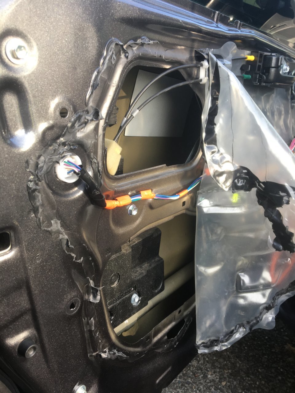

    Sound deadening the doors (did the cab a few years back) soooo the cab was surprisingly deadened from the OEM vs the 1st Gens.... but then I started doing the doors and saw this pitiful attempt at sound deadening the flat metal of the door (the lone, 4"x6" white patch) :rofl:
    SonnyBones and ChadsPride like this.
  17. Apr 25, 2018 at 8:43 PM
    #337
    yote
    yote [OP] Washington State University
    Jul 25, 2012
    #83444
    4,633
    Mark
    Tacoma, WA
    2002 Ext Cab TRD Off-Road
    Alright... finally installed the sound deadening material in all 4 doors, thank goodness that's done. My forearms are done being cut up reaching into depths of the door panel :bananadead:

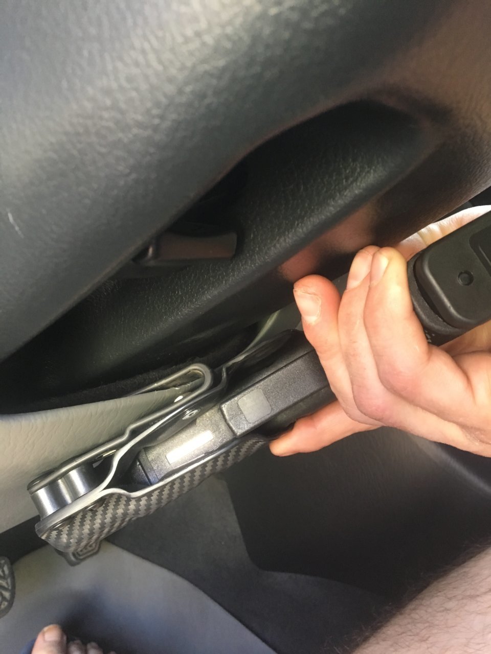

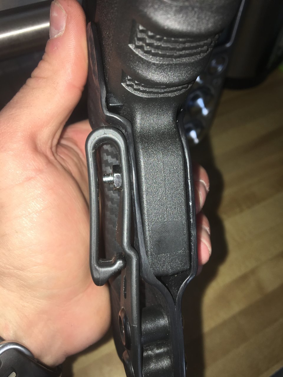

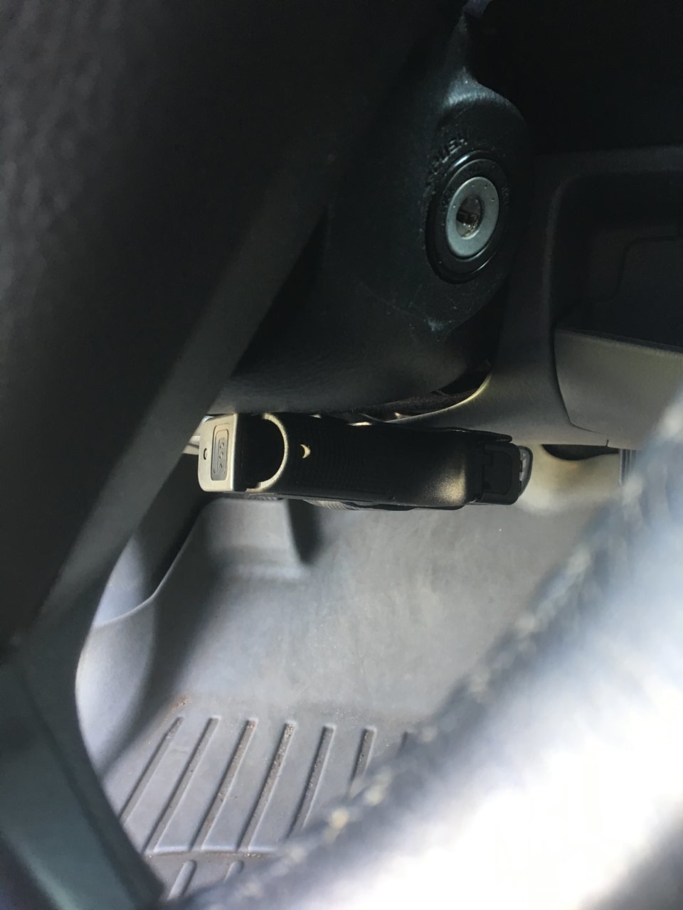

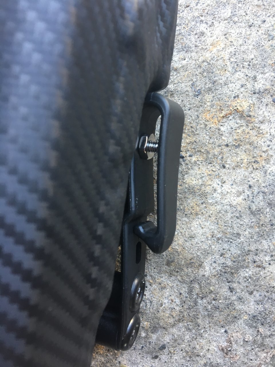

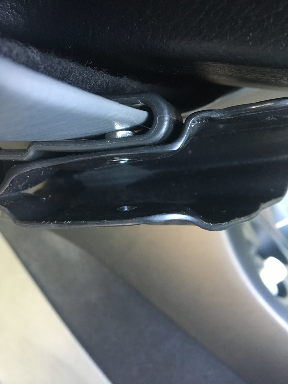

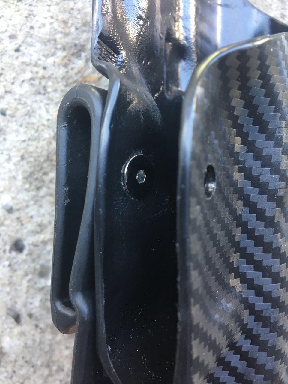

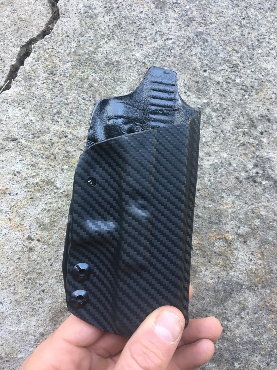

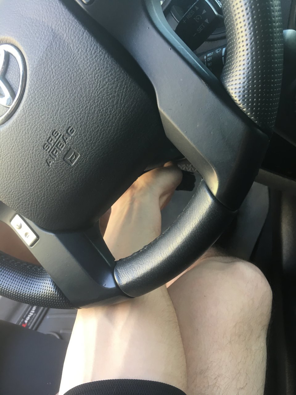

    Got around to mounting the under the steering wheel kydex holster for my Glock 19. The quoted post above shows the issue with the holster and how it bends with the weight.
    Nothing a little bit of hardware couldn't fix... stand by for a picture dump...
    This is the holster with the hardware, next post will be with the pistol & mounted
    ***I ended up shaving the excess threading off of the screw so it's flush with the nut when tightened down***
  19. Apr 25, 2018 at 9:05 PM
    #339
    yote
    Jul 25, 2012
    #83444
    4,633
    Mark
    Tacoma, WA

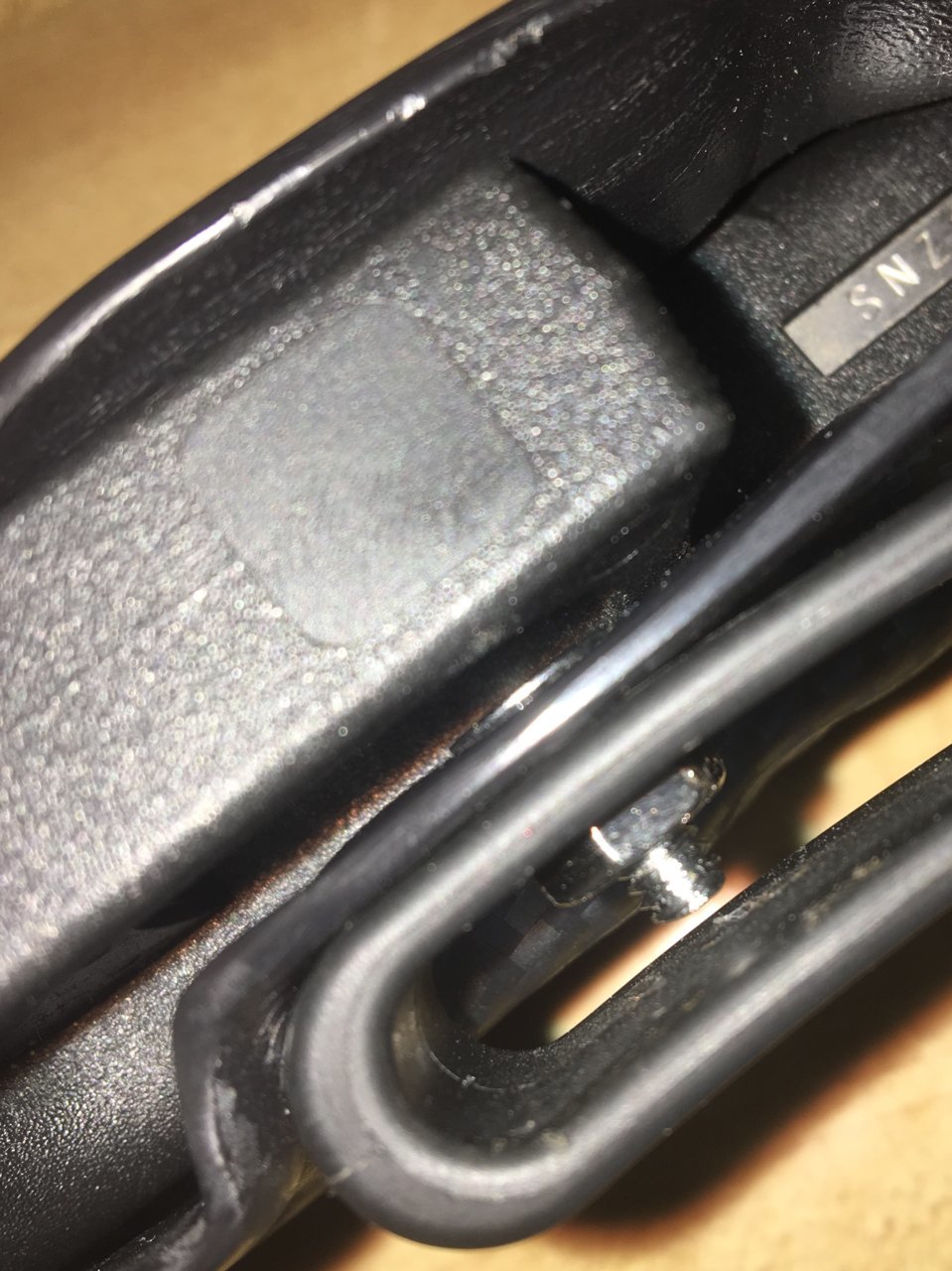

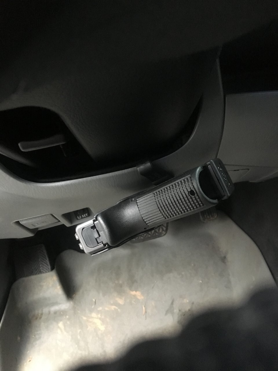

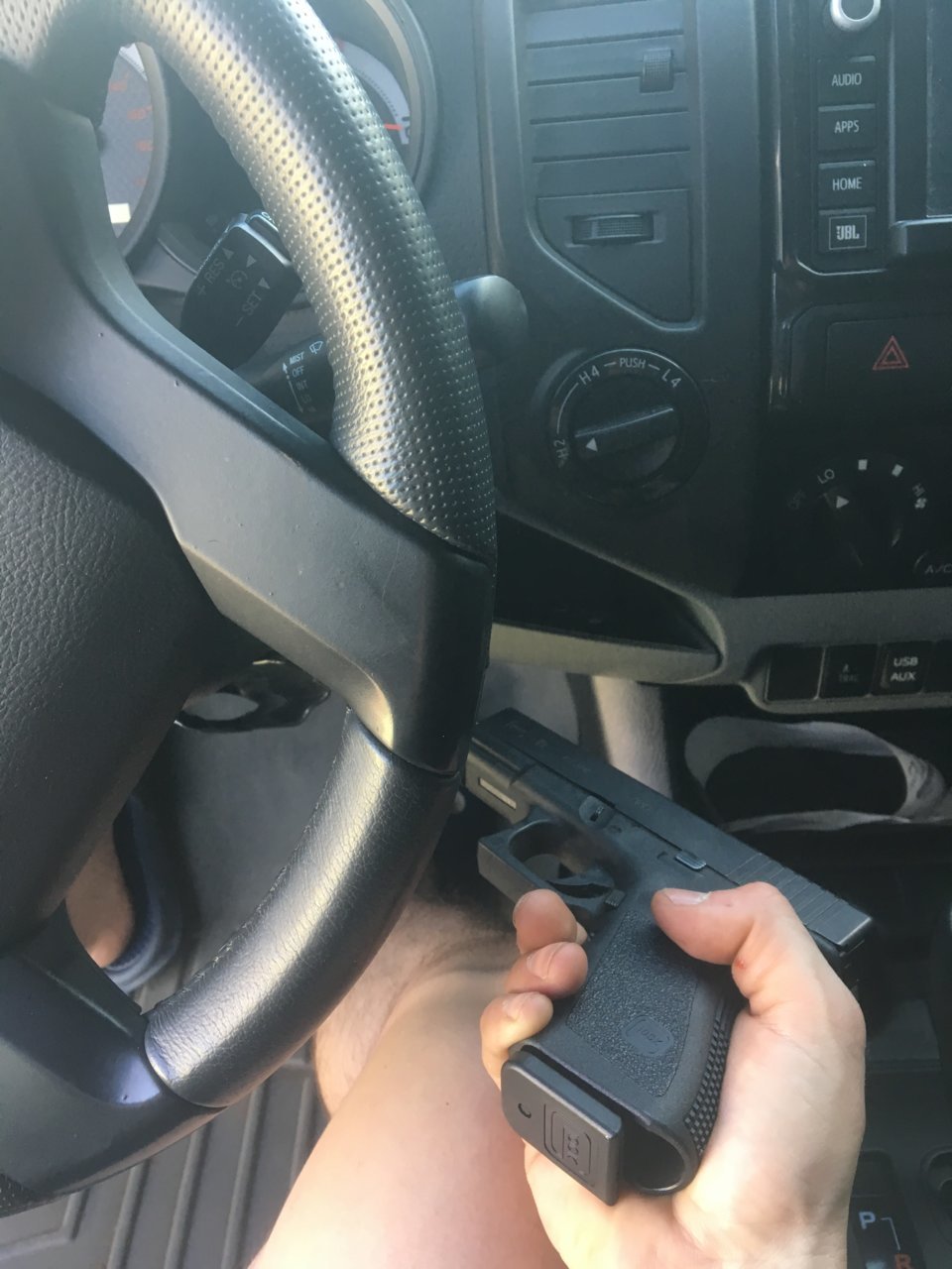

    Close up of the screw's head ensuring it doesn't come in contact with the trigger guard - don't want it to mess it up through repeated use:
    I cut the extra screw threads off so they sit flush with the nut otherwise it'd scratch the holy hell out of the dash where it's mounted

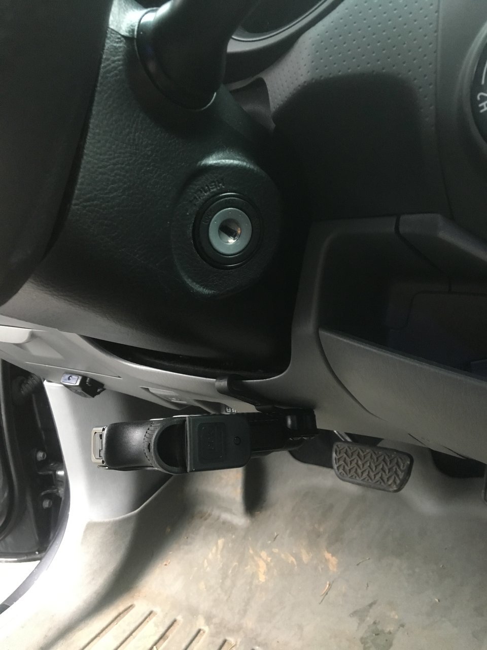

    Just the holster mounted to the dash
    There's 2 ways you can have it mounted, straight on or angled... personally I like it angled from the little bit I was messing around with it:
  20. Apr 25, 2018 at 9:10 PM

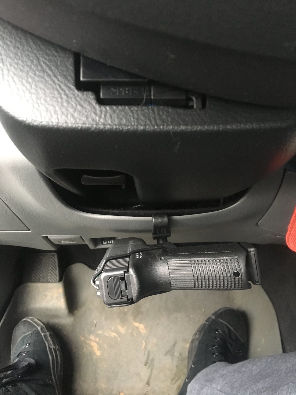

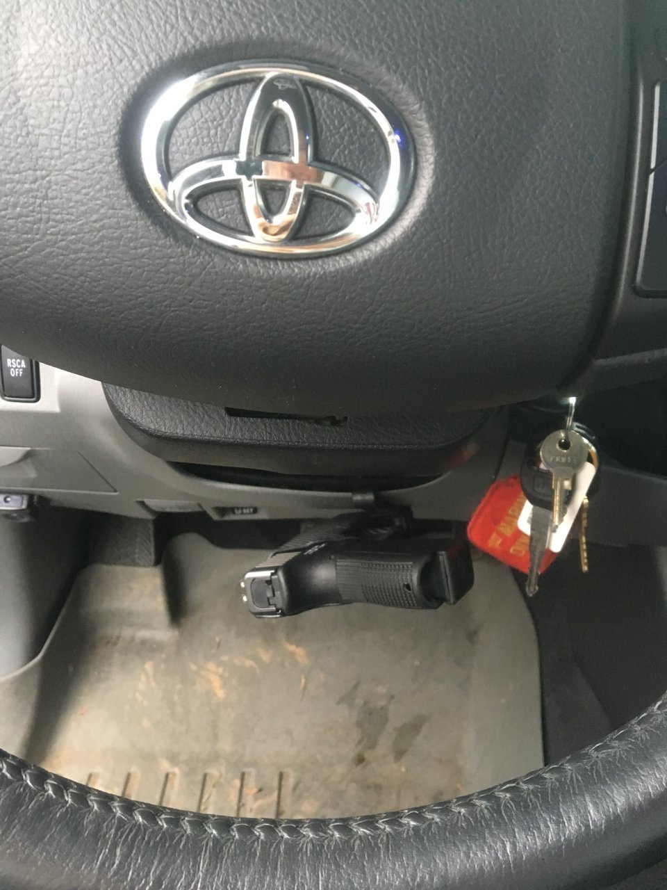

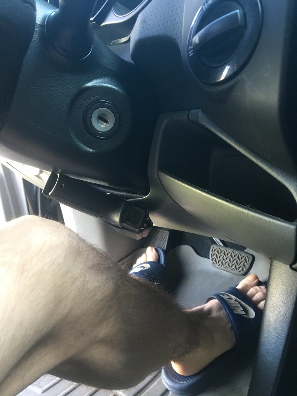

    View from the driver side:
    Passenger Side:
    This is how much leg room I have with it mounted:
    Drawing:
    Pulling it out:
    Out of the holster:
