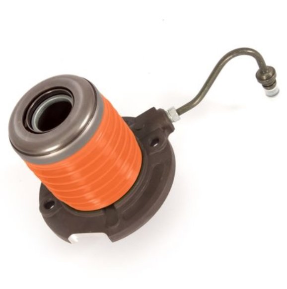

    Hey guys, after all that excitement about the new belt and cutting the pulley to reduce my belt slip, my clutch slave sh!t the bed on me. It's the bearing that came with the URD hydro bearing kit. At first I was going to blame URD, and I suppose I still can, however the bearing itself is actually a Mustang part. The one supplied with the kit is by Exedy. A local Tacoma guy here strongly recommended a Centerforce one, so I bought that. And, it's cheaper, and it's orange, which is good because green isn't really my color. I got a year out of the Exedy one.

    @rjbiii If it gets here at the predicted date of Wednesday or Thursday, should have it in on the weekend. I'm not looking forward to pulling the transmission/transfer (again). This'll be the fourth time I've done that.

    Hopefully you don't need to. Let me know if you want any tips. I have a scissor low-lift trans jack which makes it more doable. Make sure you check/replace the slave too before you take the trans off...

    Well, all the symptoms I was seeing were consistent with a bad master BUT... I didn’t do the check I should have (which I read about later) which was clamping the clutch line with vise grips and pressing on the pedal. And... after replacing the master some of the symptoms remain. So I’ve basically ruled everything out except the slave.

    If you clamp it and you can't push the clutch pedal down, your master is good.

    Yeah, it's bolted to the outside of the transmission.

    What I mean to say, is it's bolted to the outside in the stock position. But with the Mustang bearing retrofit you do have to take the transmission off.
