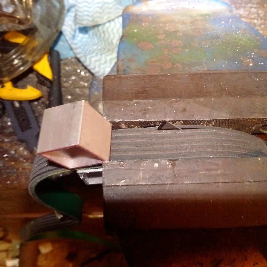

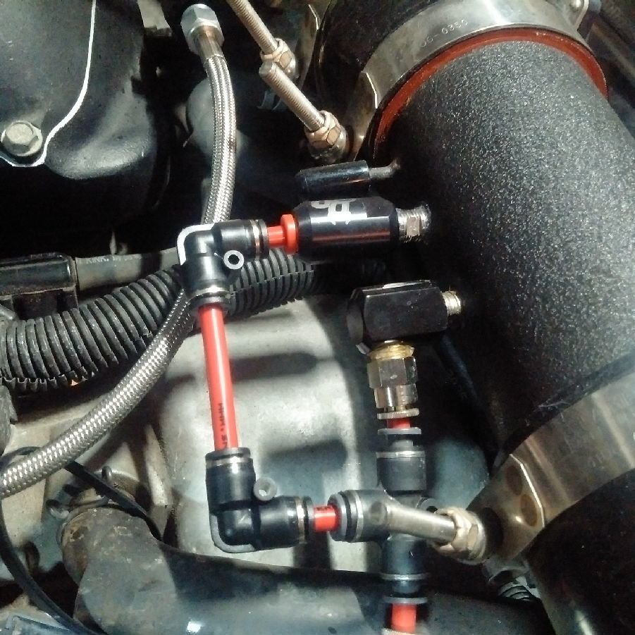

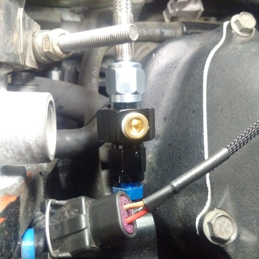

    Getting a few things done while I wait for the new Mustang release bearing.
    Inline fuel pressure sender fitting next to the 7th injector (plugged right now while I wait for the sender and gauge to arrive), cutting the new belt, and cleaning up the 2nd nozzle installation for water/methanol injection.

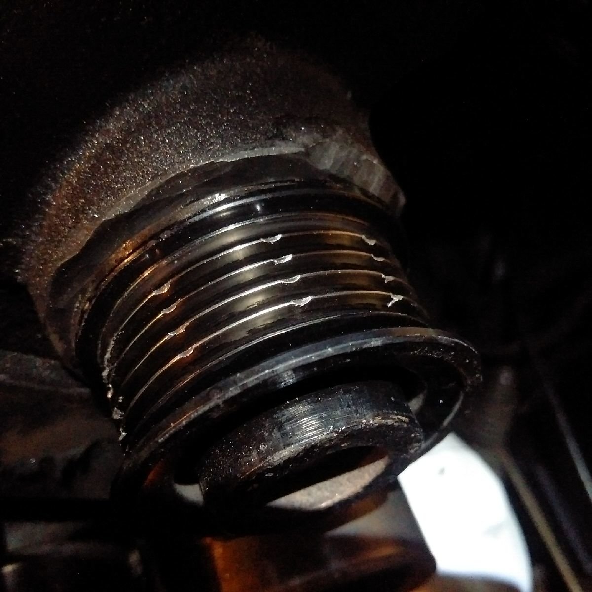

    A flux retro-capacitance encabulator

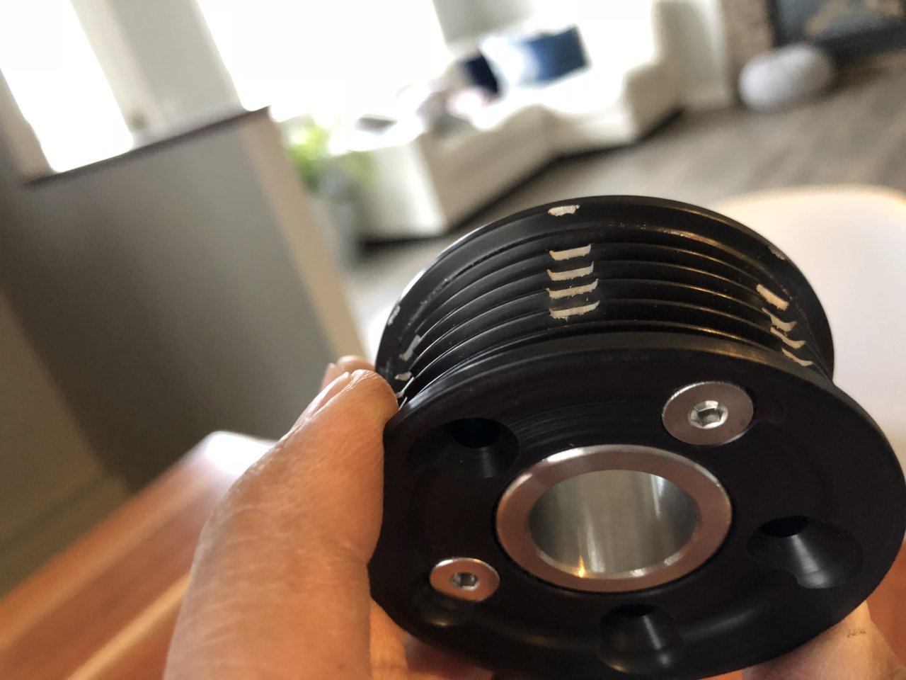

    @Roostfactor @rjbiii @White lightning boosted @12TRDTacoma @Speedwaytacotuesday

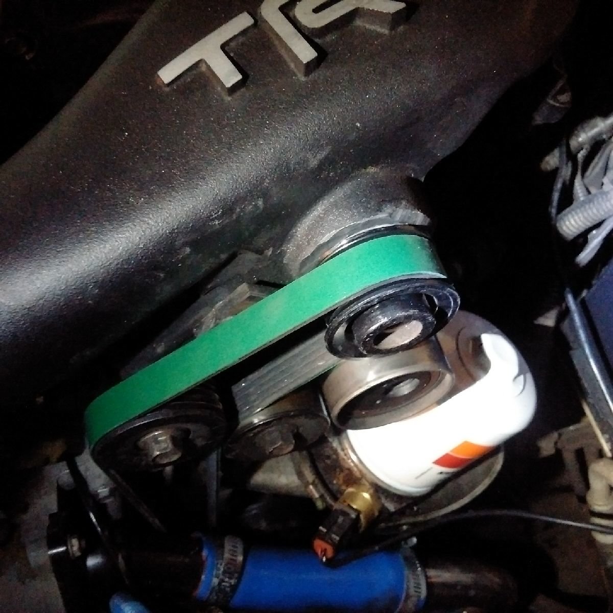

    Did finally get my parts and get around to doing this, 69" Fleetrunner belt and whole bunch of little cuts in the pulley. It made a big difference. Boost doesn't drop off after 4000rpm now, stays at 13psi, and 14psi under certain conditions. I'm sure when it gets super cold I'll see a few more pounds. I'll be going to the dyno again soon to see what the difference in the numbers is.

  3. Oct 20, 2018 at 6:26 AM
    #323
    Roostfactor
    Roostfactor Well-Known Member
    Jun 2, 2015
    #156609
    3,885
    John
    TX panhandle
    2015 DCSB OR Pyrite Mica
    HPT/justDSM tuned factory ecu, URD Headers, JFR Y-Pipe/l 3" exhaust, Walbro 255 fuel pump, Maggy SC (JFR ported), JFR ported lower intake manifold, 76mm tb, 2.5 pulley, 640cc injectors, CSF Radiator, custom electric fan wit Autocoolguy controller, JFR SC pulley wrap mod
    Good stuff! I'm curious how the dynos compare.

    Well done sir. Only thing else I could think of is a double @Roostfactor pulley mod! Both sides. Let me know how belt wear is.

    @Roostfactor can you point me at pictures of this?

    It doesn't exist....yet. I was being funny. But it just might work.

    It's a night and day difference now huh?! :thumbsup:
    Fleetrunner belt/ pulley wrap mod/ RIP mod all used in conjunction is a hard combo to top. :D I love my Fleetrunner belt!

    I’ll be honest, I wasn’t sure it would make much of a difference, and certainly not as much of one as it did. Now I believe.
    I’ll be promoting the heck out of this setup now for those going to a smaller pulley. To think that much boost was just left on the table!

    I'm telling you, just switching out to the green belt alone after performing the RIP mod and pulley wrap mod gained me an additional .8 psi over previous efforts. I'd like to see how much slip I have in place by removing all the belt tension and traction mods I have done to the blower just to see how inefficient it is.

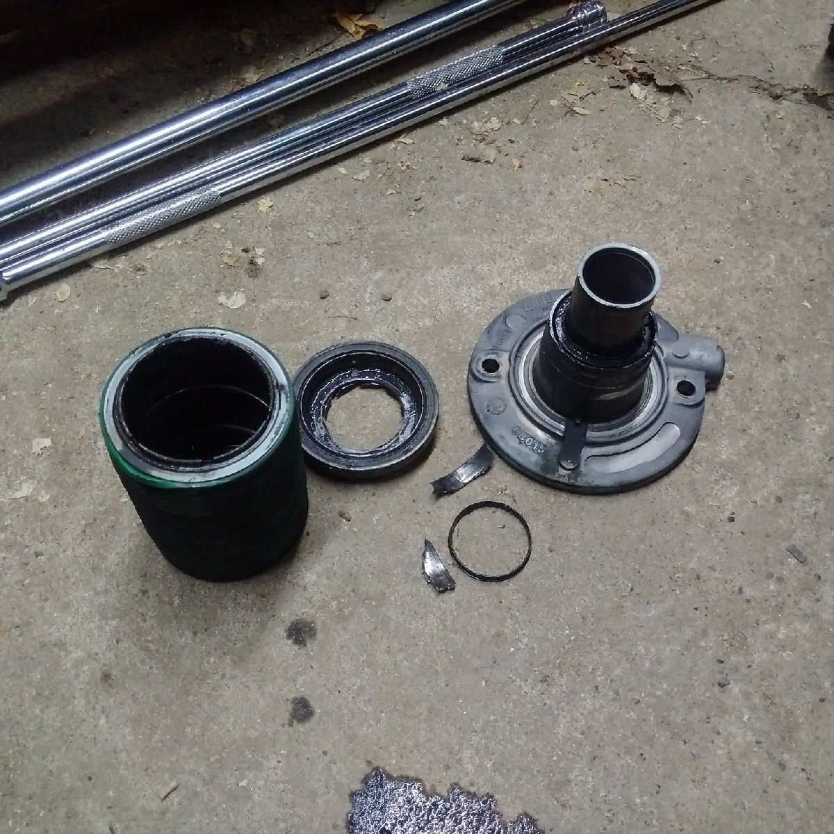

    2011 SR5 Manual TRD SC 1.87" pulley
    Look what was left of my hydro bearing when I took it out! As soon as I got the transmission off, it just... fell into pieces. I have no idea how it was working, as well as it was - albeit it was barely working.

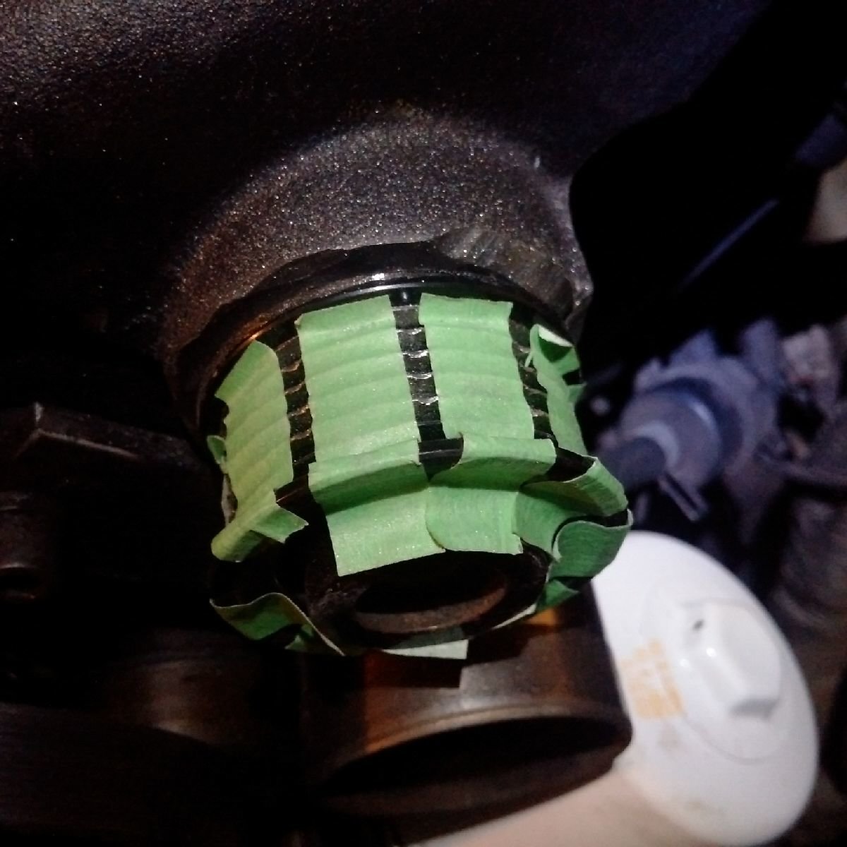

    Thanks for the leg work!, I am also running the 69.01" fleetrunner on my 2.3" pulley setup. Received my belt wrap mod from Roostfactor last week, I will install it on the day that I am not lazy.
    @Athlaos glad to see you did the rips/slots as well. Let me know when you blow your motor this winter so I will know where to go or not to go when you build it. Edmonton is only a stone throw away.
