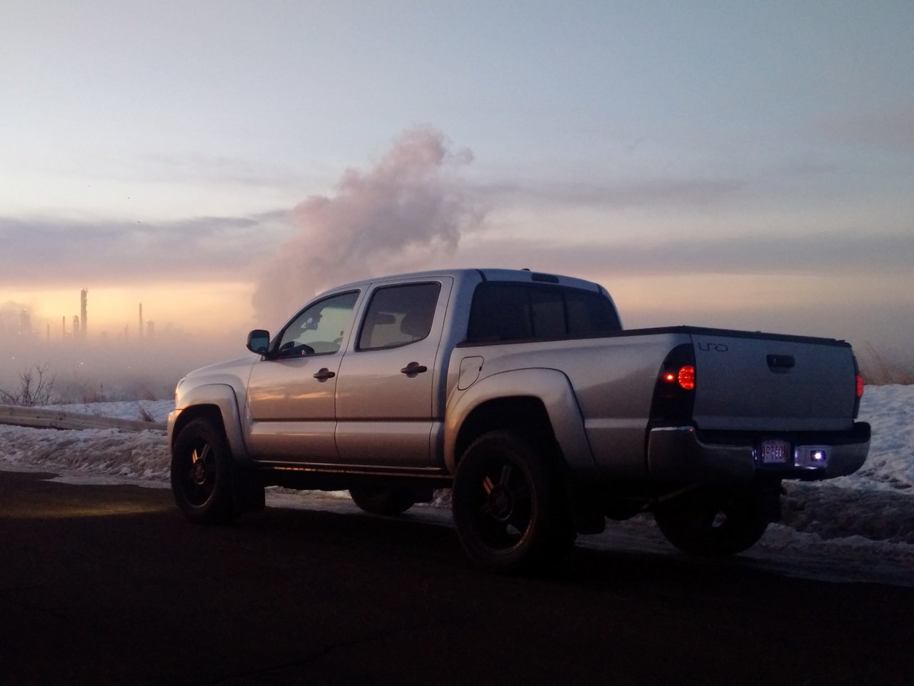

    Still a winter beater.
  5. Jan 8, 2021 at 7:51 AM
    #545
    TodayWasTHeDaY
    TodayWasTHeDaY Hoser
    Jul 10, 2017
    #223673
    2,059
    Russ
    Calgary
    2015 DCSB SC M/T TRD Sport
    *Whistles
    Looking good! Liking the smoked tail and cab lights.

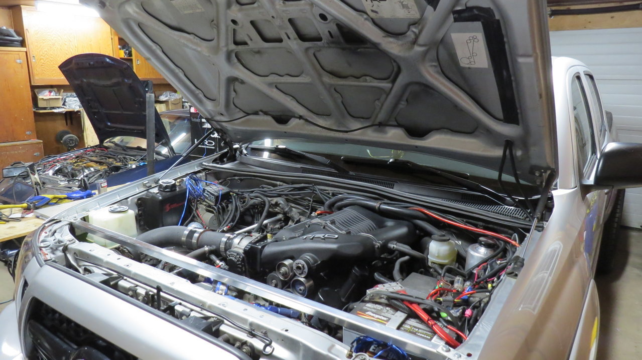

    Got a pair of these pneumatic hood props for the price of one large Tim's Double Double (Canadian backyard mechanic's currency) from a guy who's selling his truck. Now the stock prop won't be in the way of my engine bay pictures.

    Wikkid price, where does one go to buy one of these kits in the first place?

    My friend said he got these ones through work, they're actually a universal kit. They didn't fit perfectly, although more than good enough. I think there's a company posting on here who makes them specific to the truck. Redline tuning I think they're called? Something that starts with "R". Edit: here it is. www.redlinetuning.com

    I have the Redlines. work great. no issues. :thumbsup:

    Yeah @SnozzCumber it looks like a pretty good option to me. They were having a group buy recently. Can't find that post though. Maybe your search skills are better than mine.
