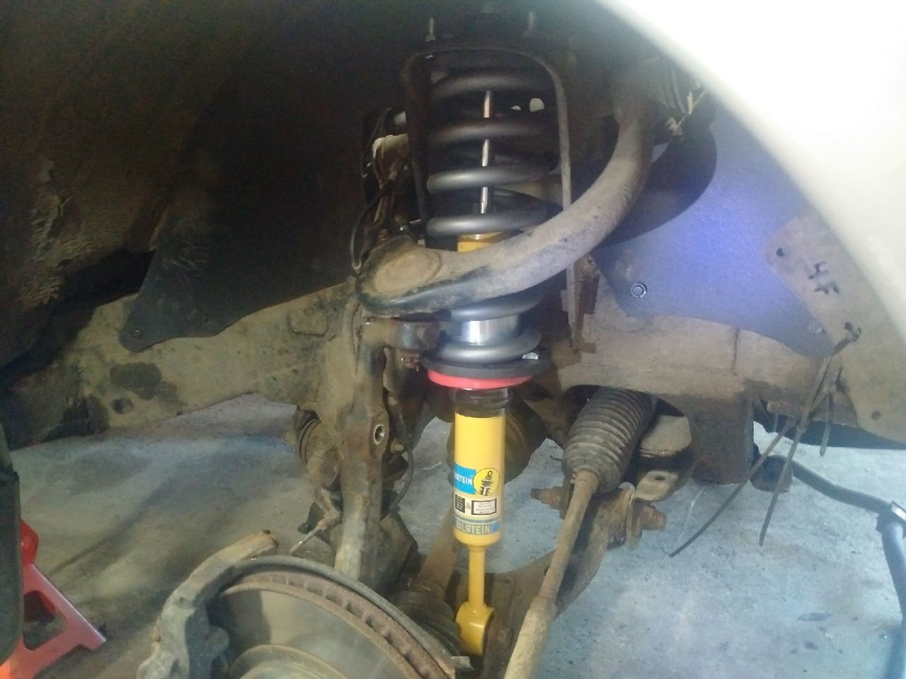

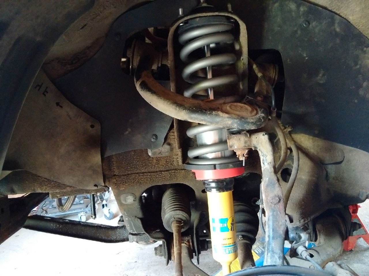

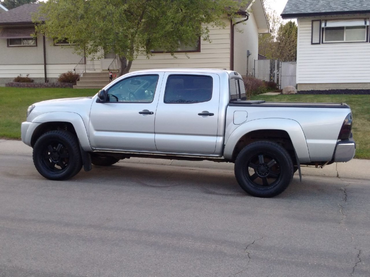

    Finally installed my new struts - the "Athlaos stiffening kit". They were a little annoying to get in, worse than my car's suspension was. I was feeling nervous about taking these for a test drive but now that they're installed I'm feeling confident about them. Test drive tomorrow...

  10. May 12, 2021 at 7:30 AM

    Details? Looks solid.
    How's the ride?
  11. May 13, 2021 at 8:37 PM
    #571
    Athlaos
    Athlaos [OP] Destruction Mode
    Nov 24, 2010
    #46672
    2,652
    Leigh
    Edmonton
    2011 SR5 Manual TRD SC 1.87" pulley
    A flux retro-capacitance encabulator
    So these franken-struts are a sawed-off 2" OME spring kit, I don't remember the original spring rate but I calculated with the sawed off portion it should be around 900lb/in. Bilstein 5100s, and a bunch of parts from a lift kit and another old suspension kit that I had from ages ago that I decided I wasn't going to install (didn't work so well with the springs).
    Today I put the sway bar back in and took it for a drive. Man it's stiff! It's great! Way better in the corners, not making any clunks any more, the front rises up less when I hit the accelerator. There's nothing bad about it really.
    It surprised me a bit how much it leveled the truck. I was expecting like 1.5" of levelling, not 3". Some of that 3" was compensating for some sag in the factory springs so probably overall it's 2". I never did like the levelled look but now that I have it, I am liking it.
    O.o, BassAckwards, dpele and 2 others like this.

    Sounds awesome! The body roll on these trucks leaves something to be desired when driving hard. I also don't love the way the rear end tracks and will have to do something about it at some point.

    One problem I noticed is it's about 1" less lift on the driver's side than on the passenger side. Couldn't avoid the damn taco lean even with a brand new strut... I know it's something that only I will notice, but it does annoy me.

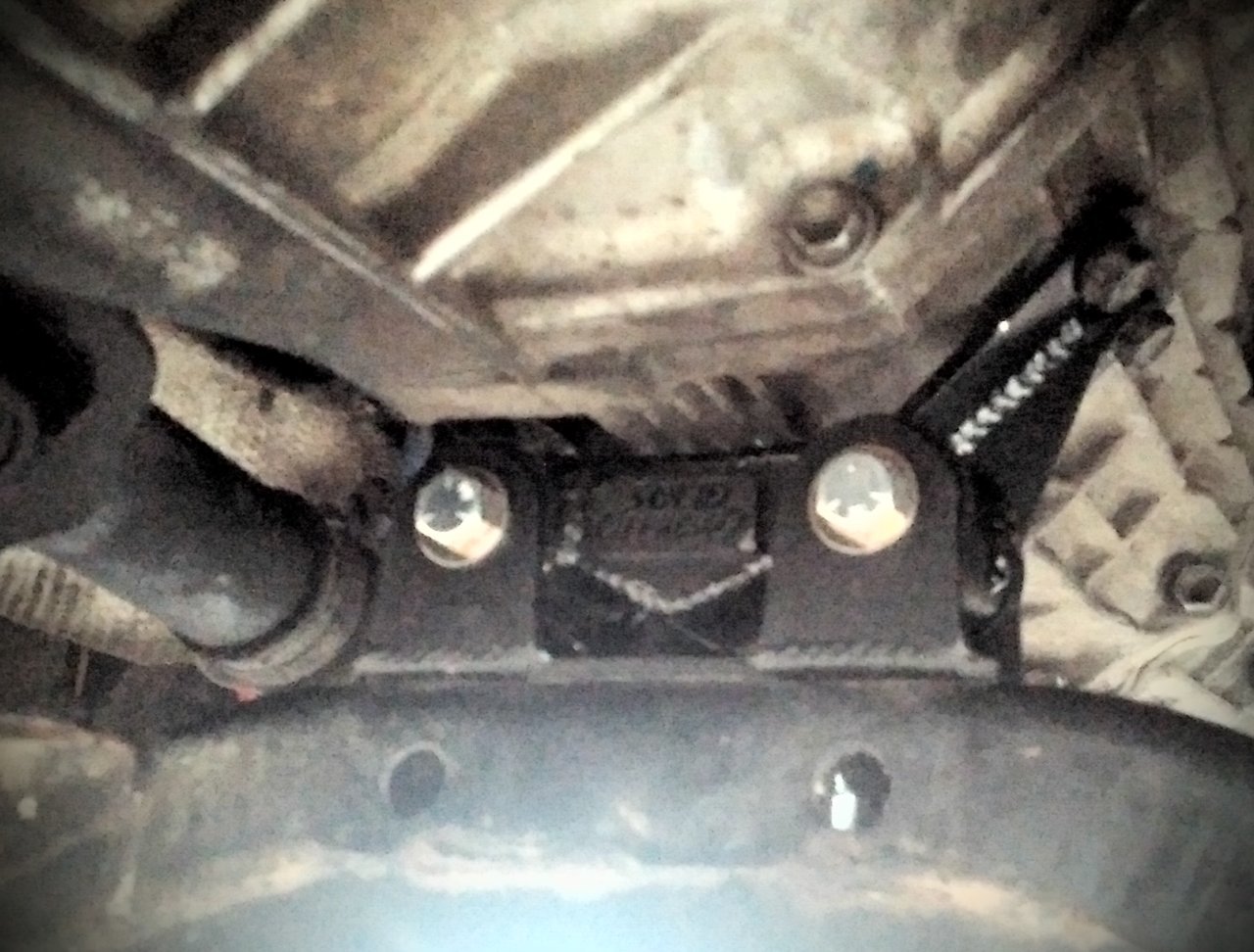

    Installed the solid transmission mount yesterday. This was a great upgrade. Having all three mounts as solid mounts really tightens up the shifting and makes for consistent throttle response. They aren't cheap but worth the money in terms of improving racetruck funness.

    Damn, you're really selling me on these. And if the Roost y-pipe is still a six month wait....
    Question: Is removing the transmission more difficult due to less (or no) flex from the motor mounts? Kind of curious about that

    I was thinking about that too. There might be less flex to allow the engine to tilt down to let things line up. I thinks it will be OK though. There should be at least 1/2" of tilt even with the solid mounts since they aren't actually totally solid, they do have a urethane bushing in them that gives a decent amount of flex.
