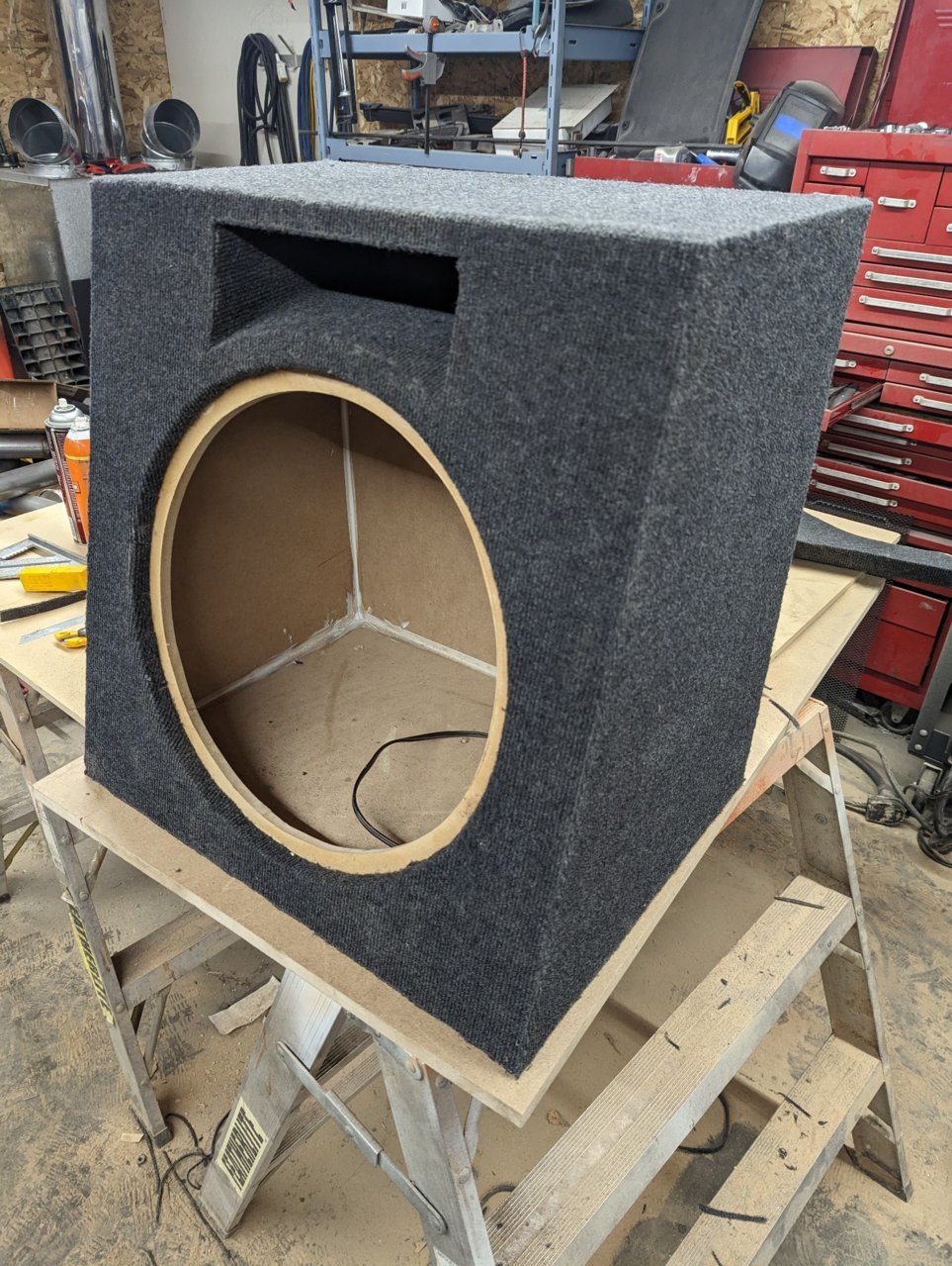

    Operation 18" sub nearly done. Let's hope it's too much bass...

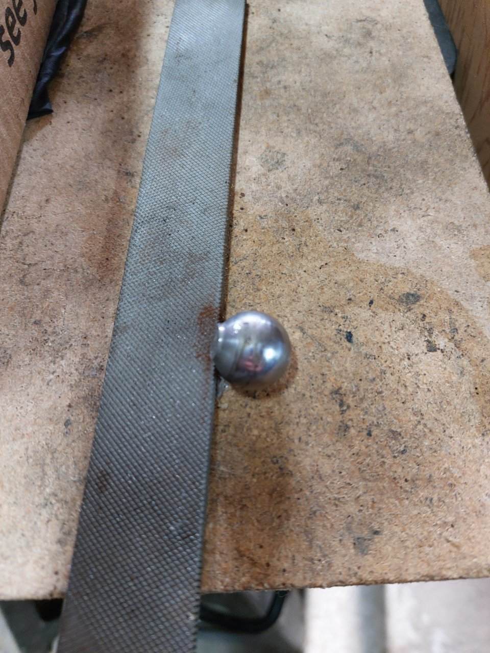

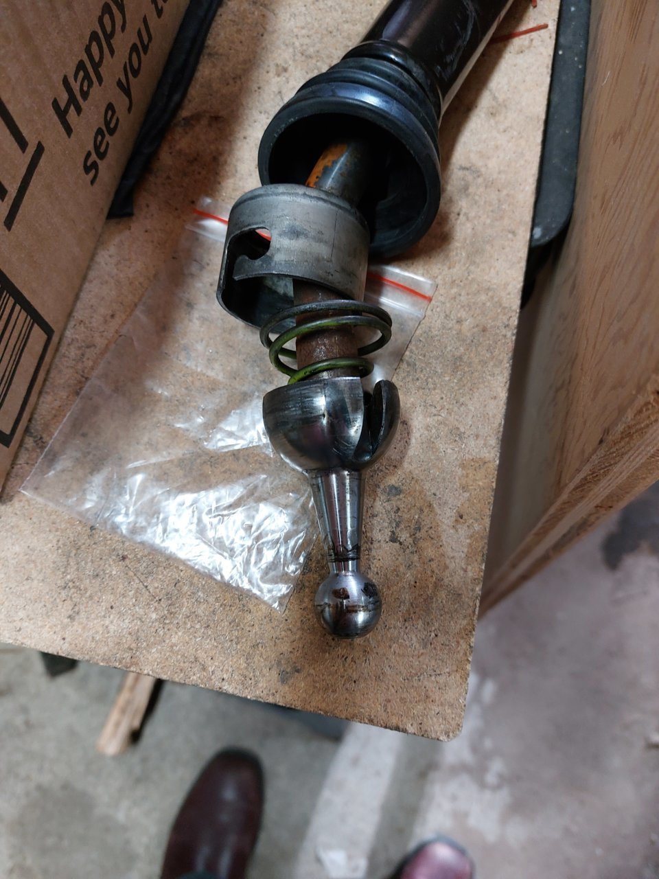

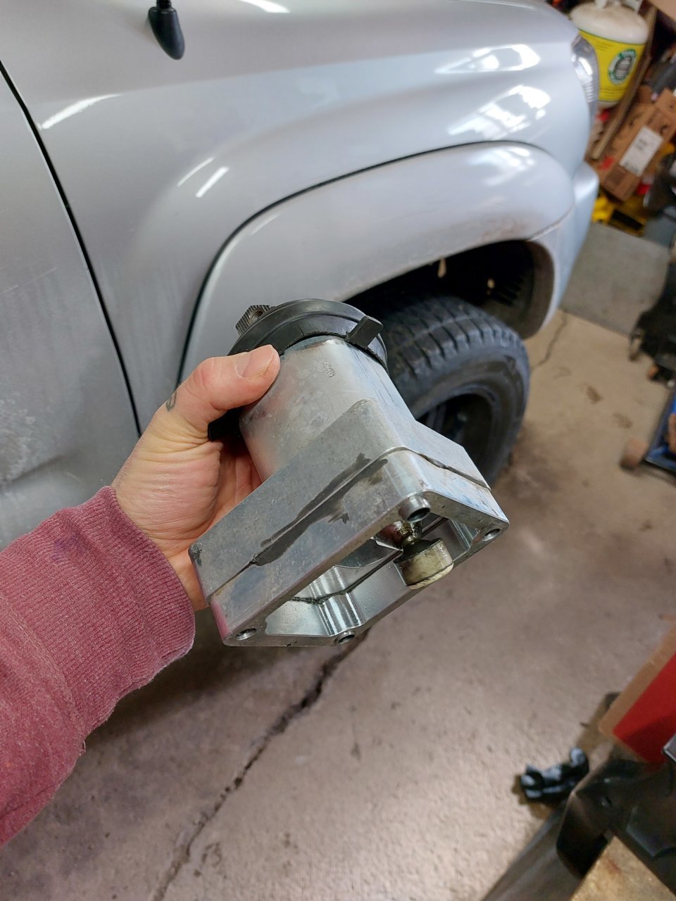

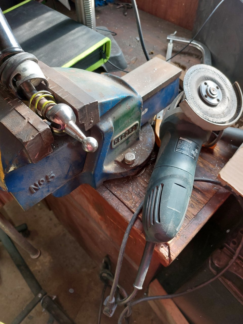

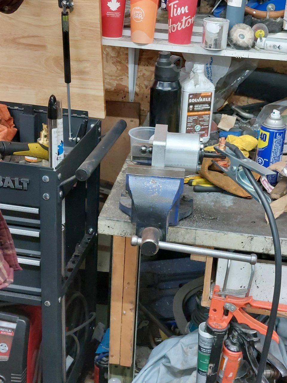

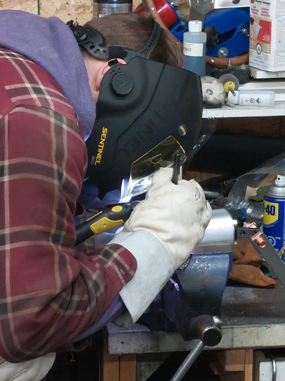

    I think some were interested a while back, I use the Hurst shifter along with the URD shifter. I also shortened the knob shaft by about 4". It's a nice, short shift. I recently replaced my Hurst with a new one, the old one had quite a bit of slop in the fulcrum, the new shifter looks better built and it has way less slop now, so that's good.
    I had the URD extender pressed on to the old shifter ball so I couldn't remove it - ultimately decided to weld the stock shifter ball onto the new shifter to extend it. Sorry there isn't a good picture of the final weld, but the weld was kinda ugly anyways (my friend did a way better job tig welding than I could have though, he said the base metal seemed to have a lot of porosity in it and was being difficult).

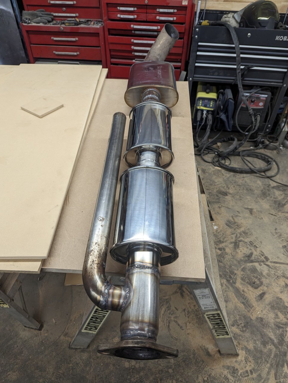

    My friend starting working on my real exhaust, finally, a 3". I'll do a before and after sound clip. And maybe even a dyno if I can find the time.

    Nothing too serious - just a 3" back from the URD y-pipe using the stock format flange. The same friend said he could probably build an equal length Y-pipe as well, but that's for down the road and/or when my car can function as a primary vehicle again.

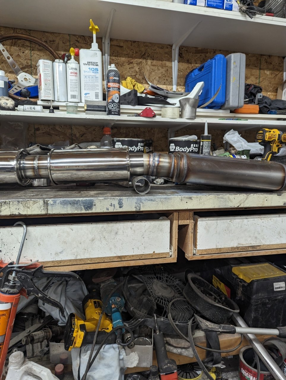

    New 3" exhaust finally. Well, almost. Needs a better flange, so that's a future upgrade.
    Sound clip to come.

    Helmholtz resonator?

    That looks really good! It'll sound awesome with that schwartzmann:D thingamajigger, can't wait for the sound clip.
