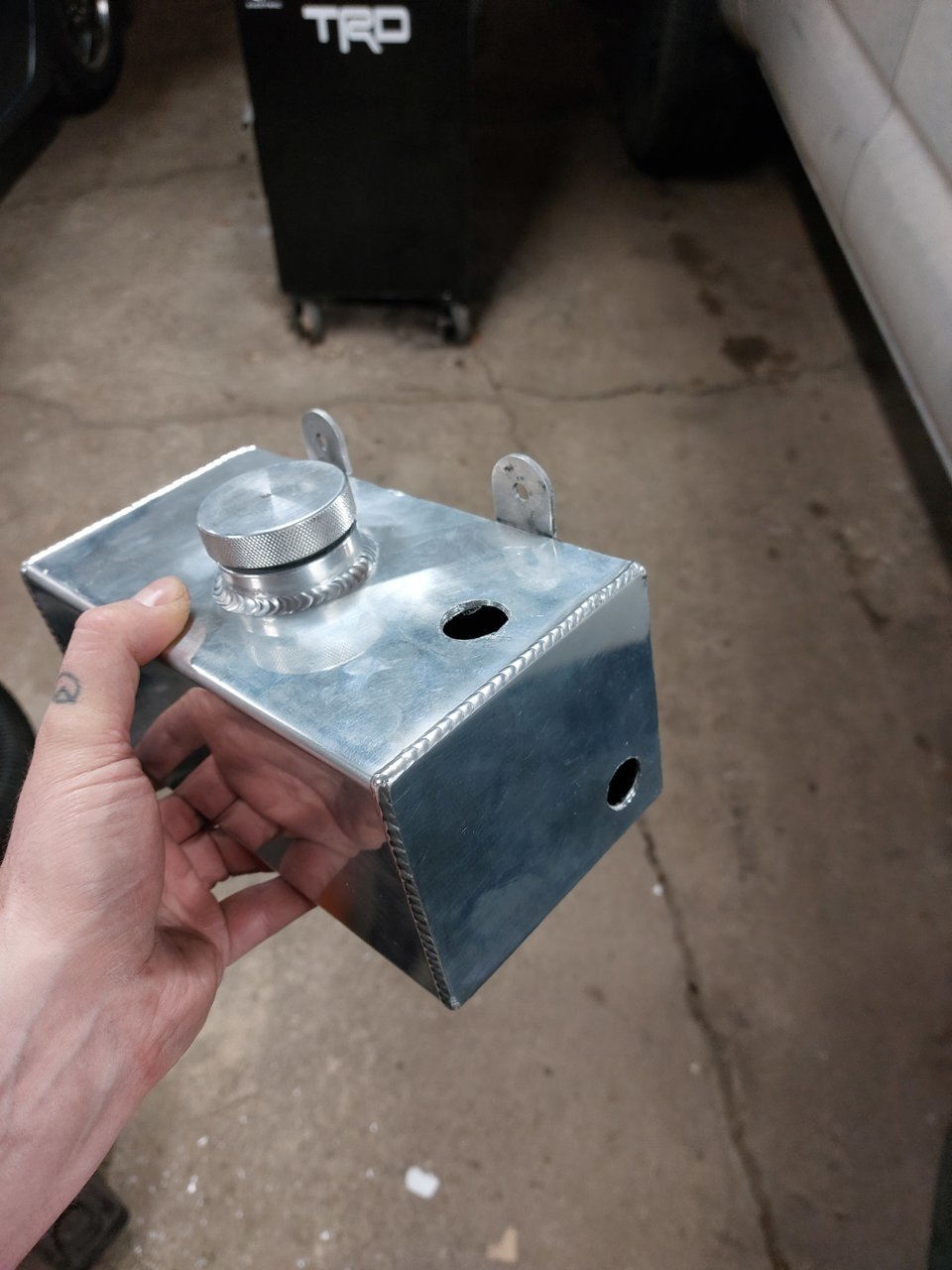

    Yep the washer tank which my buddy is already working on. He's going to start on it this week and he's charging me $275 including materials so that's really reasonable.

    That's a good deal for sure! Looking forward to seeing how that turns out. I believe methanol is corrosive to aluminum, so you might keep an eye on the type of fluid you use in it, as i bet yall have some strong stuff up north.

    Ah ya. I feel like a bad engineer now because I didn't check the compatibility of water/methanol with aluminum. I looked online and there are a few forums that have useless anecdotes, but a few research papers that say it's fine and a couple that say it's not. I might have to get these things internally coated at a shop, I'll have to do more research and let you guys know what I come up with.
    I will check my fuel cell in the back of the truck that's always filled with methanol/water to see if there's any signs of corrosion there.

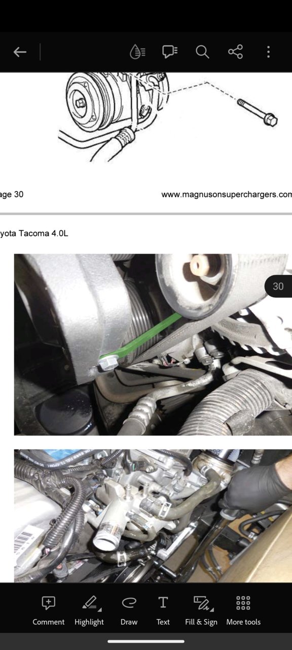

    Did you manage to get the broken off piece of stud out of your block? Get the replacement stud yet with shipping that cost twice as much as the stud?
    I wonder how that tensioner bracket could be shored up to relieve a bit of the stress on the studs? I had an idea for joining the two stud spacers together, which would probably help but I don't think it would be enough to really fix the problem. I think the tensioner bracket itself would need something stronger but it really looks limited for ways to beef up the mounting other than possibly that thin metal bracket piece on the side.
    Thoughts?

    Interesting, a redesign of the static system could be something to look into for the future - I was thinking about that little tertiary bracket on the side too, if I can beef that up to prevent the destruction of the crank pulley and idler.
    Yes - my friend and I finally got the end of the stud out of the block. I had to buy a new welder too, which was an annoying expense. Fortunately I found one at CT for half off, it can even take gas if I want, but it already makes quite a bit better welds to begin with.
    It was a bit of a frustrating evening on Thursday trying to weld a nut on the couple of millimeters that were sticking out, but we got it. I was interested in getting some titanium replacements made but since that was going to run me huge dollars, I ultimately decided on:
    1. get a 60mm class 8.8 bolt (m10x1.25) so I can at least put the accessory belt back in and drive the truck while I wait for more parts,
    2. @XPOTRPR kindly sent me some RIK studs so I can get the SC going again,
    3. ordered some M10 bolts that are 200mm long, class 12.9 so I can cut the threads and the head off them and thread the ends. I originally was looking at titanium, but couldn't have threaded those myself and based on an article I read on titanium, they may not be great for fatigue especially when threaded.

    If that bracket was thicker it may just provide enough torsional stiffness to relieve some force on the stud. Wonder how much thicker it could be made and still clear the belt and I honestly don't remember how that bracket attaches to the block and what kind of clearance for that.
    When I do my radiator change I may just pull that bracket off. If it could be replicated with even a 1/4" thick piece of flatbar bent into the right shape that would probably help a bunch.
    Something I'll take a crack at if I have time.

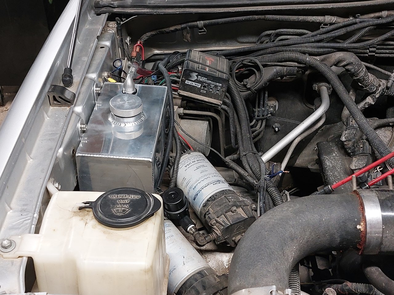

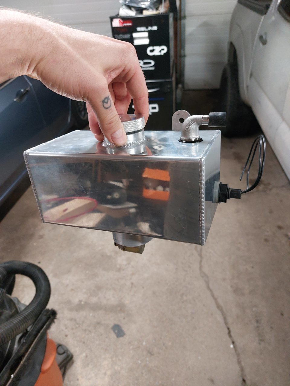

    Installed my bling water meth tank. Waiting for parts for the SC tensioner stud fix so it was a good time to bang it in. I love it, it's making the rest of my engine bay look bad tho.
    I had my friend weld in a sump as well since it's shorter than the Snow tank.

    That looks really well done. Engineering, install, fab work, welds, etc. all look top notch.:cheers:
