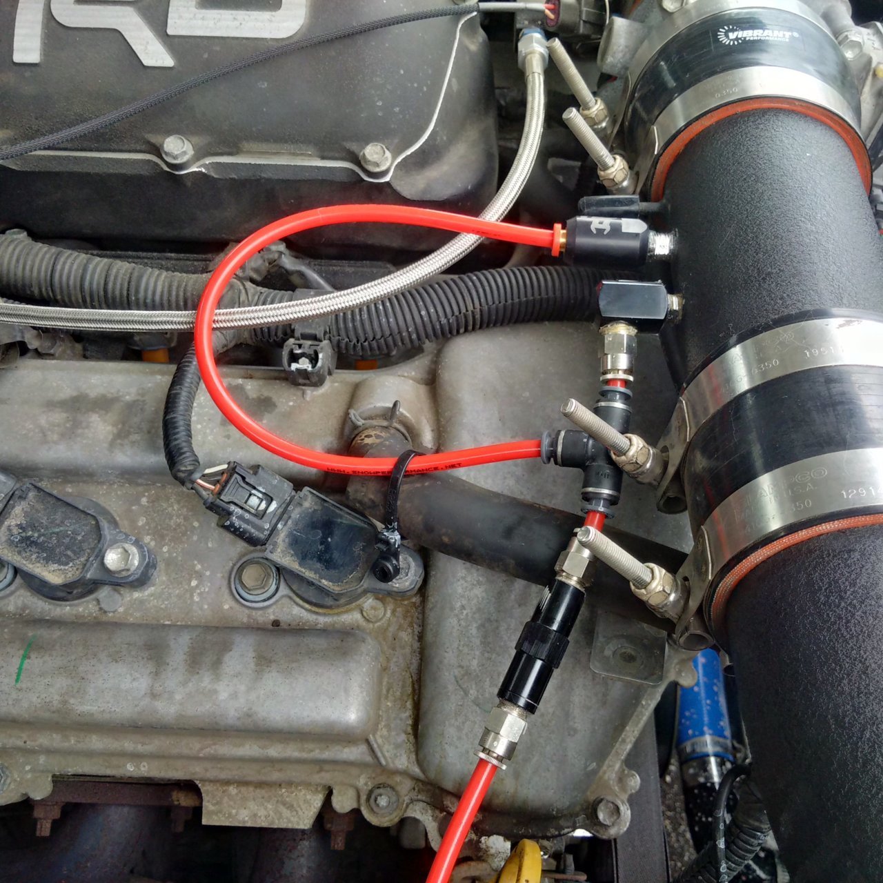

    Can you post a pic of where you are injecting the water/meth?

    Sure!

    This is a good idea! Ill probably go this route instead of trying to relocate that air injection pump

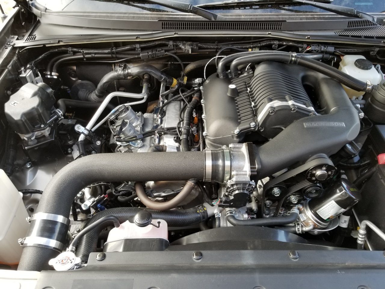

    Relocating the pump is not hard to do. Flip the rubber lines around going to the valves so the opening faces the firewall, bend the pump brackets a little bit and use existing holes on the fenderwell to remount. That is if you have the URD intake.

    Thanks for the info! Ill definitely give this a go after i get a urd intake. Should make it easier to stuff another resivoir in there. Id like to keep the two separate if at all possible

    No prob. Let me know if you want better pics.

    What I take do you have now?

    That's seriously showroom-worthy engine bay cleanliness going on there.

    Haha, thanks man. Sorry to thread jack. I am very OCD about certain things.

    I have the stock airbox at the moment. Just got the blower on about 2 weeks ago
