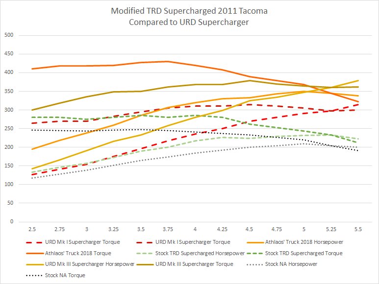

    So I sharpened the pencil to see where I am on this chart. 350hp is approximately 415m3/hr. Maybe as high as 460 if we consider crank hp. Pressure ratio is 1.8-2.0 depending on how much vacuum is behind the rotors...
    So I’m looking at somewhere around 56-58% efficiency. This isn’t that far off the maximum of 62%. Therefore, I assume the lower efficiency is probably a small factor in my torque drop off, and intake restrictions are the biggest factor.

  3. Jul 9, 2018 at 2:20 PM

    Is 2018 your results?

    Ya. Whoops, I forgot to change that.

    Lift, pedal commander, led foglights, led interior lights, led back ups, led under lighting, urd tcai, led headlights, methanol injection, 76mm tb, hood struts, dif breather mod, ratiotek trans kit, x-series gauges, true cool trans cooler, belt wrap mod, 2.8 pulley
    If I'm reading correctly stock trd hp tops out at 230ish. Seems kinda low.

    @White lightning boosted I am friends with a guy who got not much more than 250 and it was a much cooler day out.... I tried to find a chart that keeps the ambient conditions the same as when I did my dyno.

    I’ve got to see that on a bigger screen than my phone.

    Thats awesome, thanks for putting that together. Just to make it a bit busier, could you post a version with a stock engine on there? What I'm surprised at is the low end torque on the URD kit being comparable to the TRD charger, I would have thought that the rotrex blower wouldn't be as strong down low

    If yours are the 2018 #s @Athlaos that's pretty impressive man:thumbsup:

    Edmonton is 2100ft I believe, the chart that I got the stock TRD SC from didn't have elevation info... the URD ones I'd have to guess are 450ft based on their shop location.

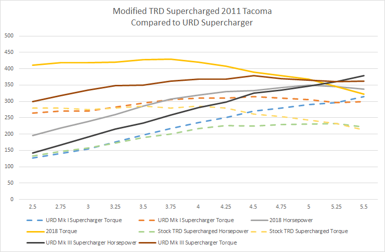

    Here's a new chart.
    I am starting to wonder if there was something weird with the Stock TRD Supercharged data I used - seemed like the conditions were the same but maybe they weren't.

    I think you're torque is where you need it. I'm surprised it doesn't taper off more at the top end.

    That torque you have is impressive...you attribute that mostly to the meth?

    I don't think so, all water/meth is doing is allowing a little extra timing to be added in. The effect of that would be close to not noticeable. I think a 2.0" pulley combined with all the other breather and exhaust mods are making the difference.

    I concur. Having a pulley that small is a big jump even from a 2.5.
